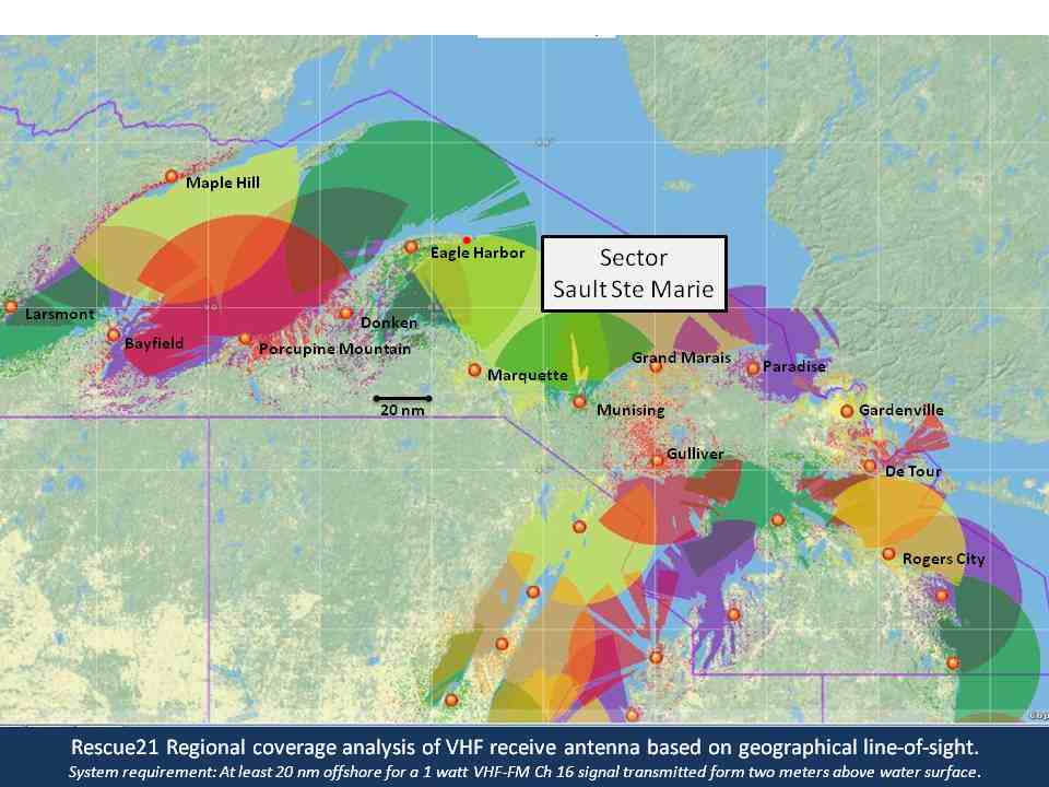

The VHF MAYDAY call from the stricken Catalina in Lake Superior got me thinking. That is a VERY remote place in the world... Basically the middle of Lake Superior. How was he heard? The USCG provides the chart of the Rescue 21 network on Lake Superior. The boat was at the red dot. I'll put the technical details below.
This is VERY impressive. He was mostly likely heard by the station in Marquette, 55nm miles away! Note that the much closer station in Eagle Harbor is blocked from LOS (Line Of Sight) by the Brockway mountain, a large (by Midwest standards) ridge that runs along the upper shore the the Keweenaw. That would expain why the MAYDAW was uncorrelated, without another station triangulation would be impossible.
The 55nm distance alone creates a 101dB Free Space Path Loss on a VHF signal with expected antennas on both ends. Someones got some good radios at the Regional Fixed Facilities!
Also note that sailboats will typically do much better than this, with mast-top antennas and 25 watt radios. The chart is based on worst-case; a powerboater with a handheld.
Tech details on how the maps are created:
Charts showing predicted areas of VHF National Distress Coverage. Plots assume a mobile transmitter power of 1 watt or greater at sea level over water.
Predicted charts were created by C3CEN Remote Missions Systems Product Line using open source software RF Signal Propagation, Loss, and Terrain (RF SPLAT) analysis tool. The software calculates path loss based on the NTIA Longley-Rice Irregular Terrain Model (ITM) as well as the new Irregular Terrain with Obstructions Model (ITWOM v3.0). Terrain data was modeled based on the high resolution 1 arc-sec obtained from NASA’s Shuttle Radar Topography Mission (SRTM) flown in 2000. The coverage plots are displaying predicted regional coverage area based on line of sight between the Regional Fixed Facility VHF receive antenna and an antenna six feet above water level.

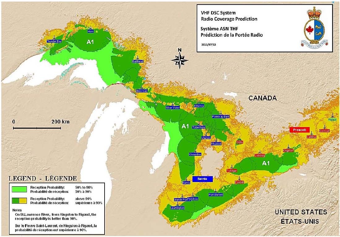

I like how this shows if you climb up the aforementioned Brockway Mountain, Thunder Bay will hear you!

Now if I can convince Sarnia Coast Guard to turn their gain down a bit ... we hear them TOO well in Saginaw Bay. I appreciate knowing they're over there when I'm crossing though, if the need ever presents itself.
CCG Radio Station in Thunder Bay was closed down couple years back. Sarnia is now handling Superior, Huron, Georgian Bay, Erie so have to turn up the volume to be heard....
