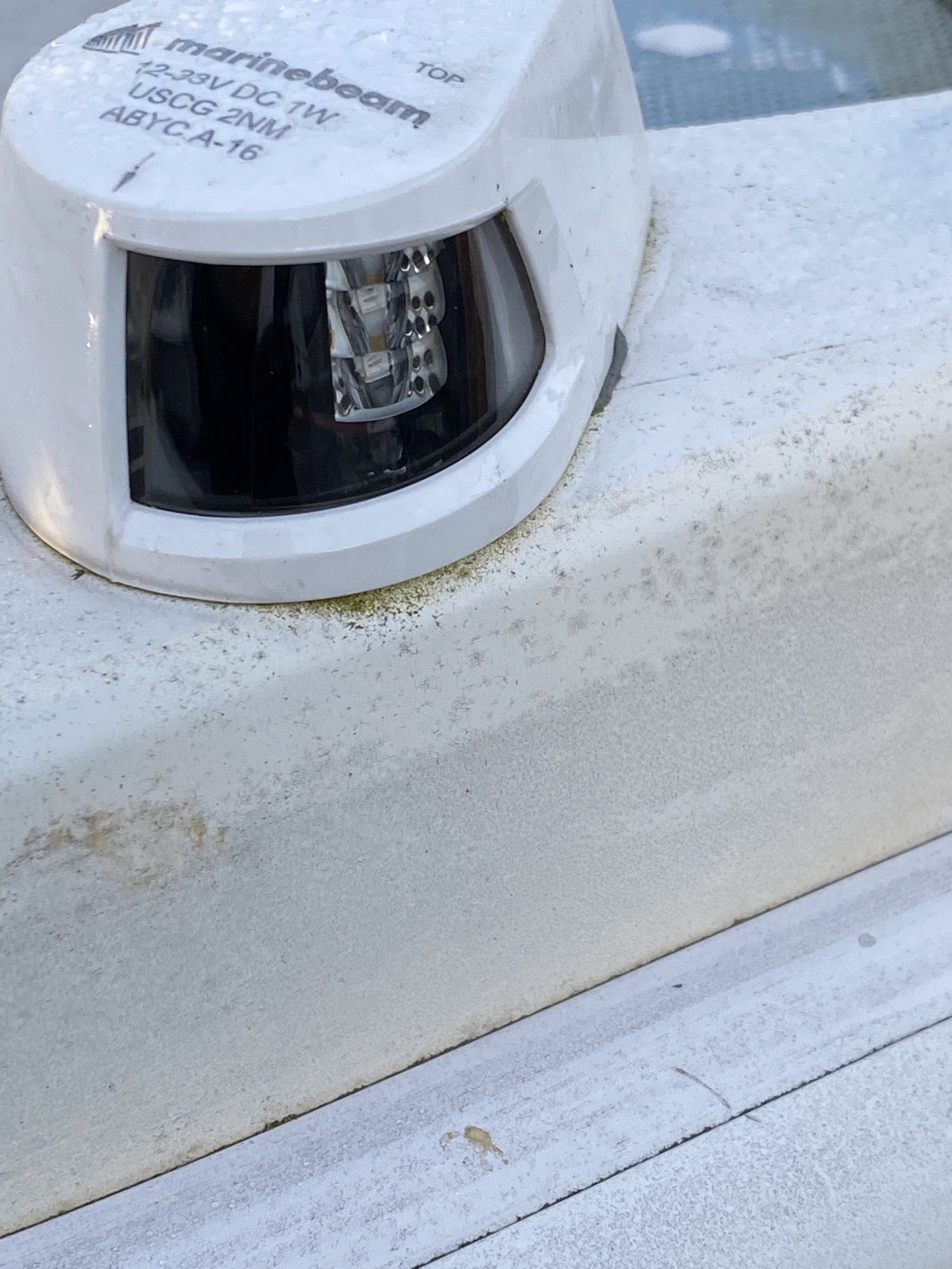

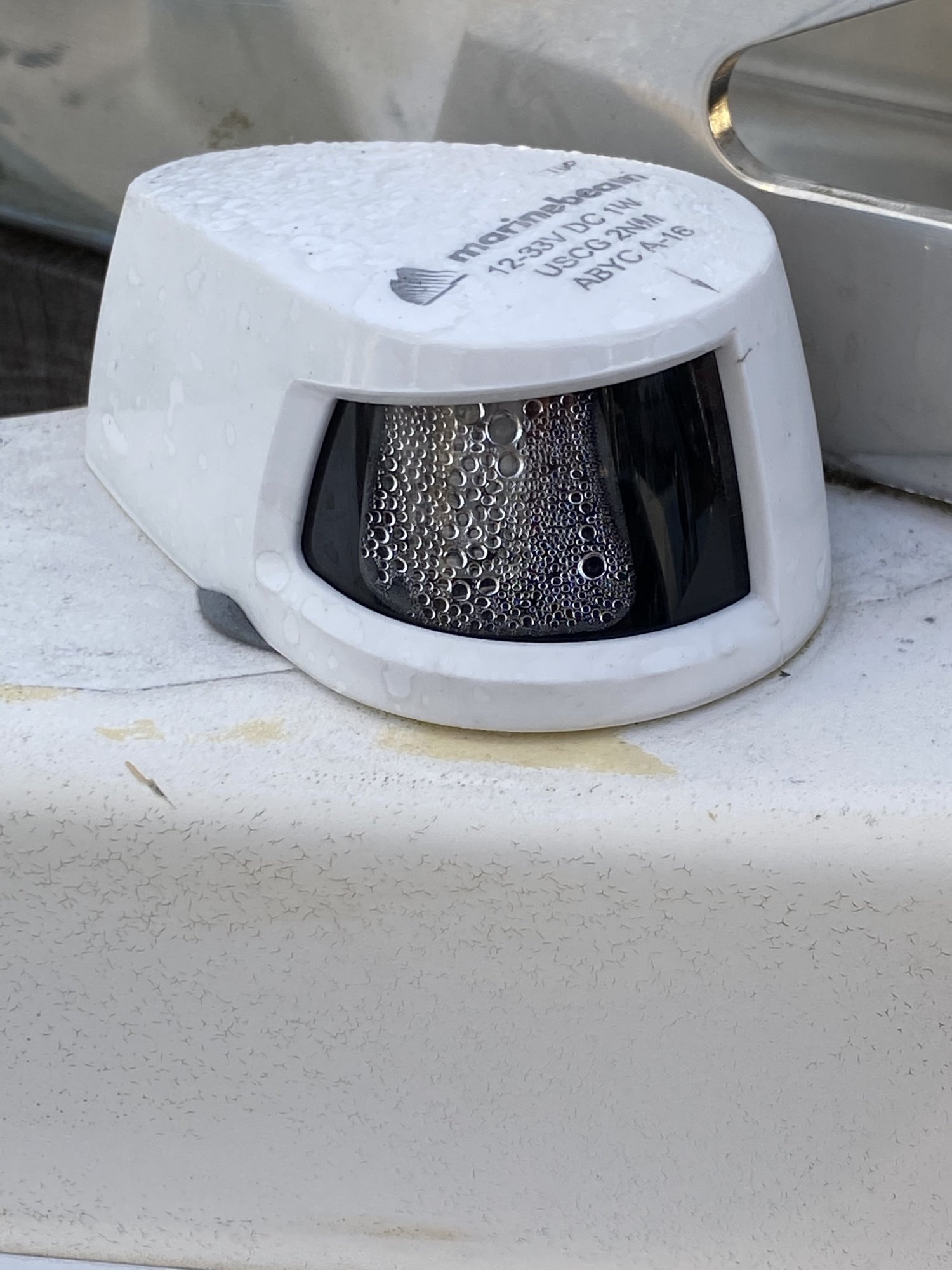

I just installed a pair of Nav lights from MarineBeam. $77 includes shipping.
CG certified 2nm. Bright lights. Lights are colored rather than white light behind colored lense.
Last visit to the boat I noticed the starboard light had moisture in it. They are sealed unit’s.
Called MarineBeam and they shipped replacement out immediately. Great service
