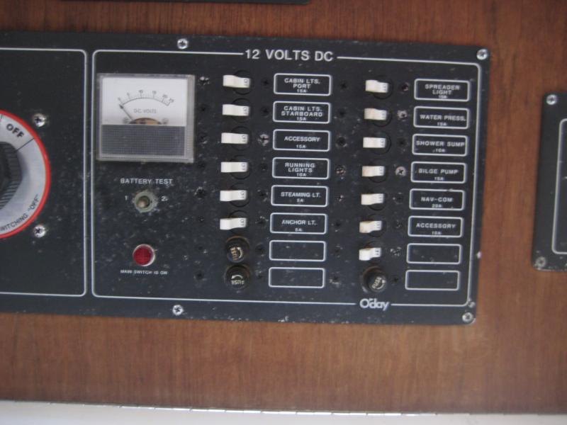

My DC panel has six breakers over two round old style automotive fuses on the left side and seven breakers over one fuse on the right side. Most of
the breakers are labeled but the three round fuse caps are not.

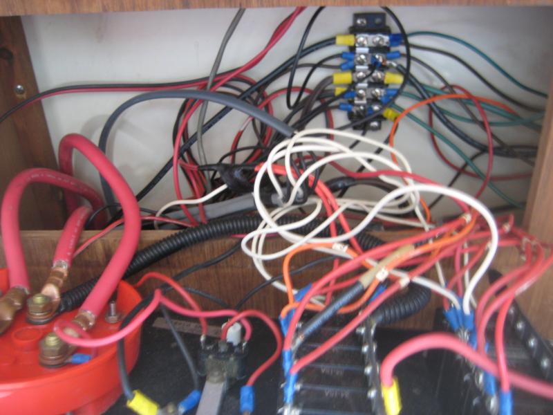

Hard to tell from the rat's nest where the three bottom fuses go to. Why not use breakers on all the circuits?

pics came out great, what year is your 34? Your panel
is somewhat different than my '81.
I suspect that the fuse holders were added by a PO as new electronics were added. You'll have to trace the wires to know for sure which components are supplied by them.
Getting back to your issues, upon inspection of the back of the panel you'll see that one side of each breaker has a bus bar screwed or soldered to it on each side of the panel. The other side of each protection device will go to the electrical device(s) that it is protecting. The added fuses will most likely not have a bus bar, and instead will have a wire soldered to it that supplies 12VDC to it from either the battery or one of the bus bars.
Measure voltage on the busses from batt. common to the buses for +12VDC. You've probably cut the wire the wire that jumps from the left side of the panel to the right. From your pic, I see that there is a ribbed black covered wire that looks like it's coming from the battery switch to the left side of the panel bus. That is probably supplying the electrical panel.
To bad the the PO used all white wire, and didn't label it, no choice but to get a buddy to "wiggle 'n chase"the wires around the boat.
