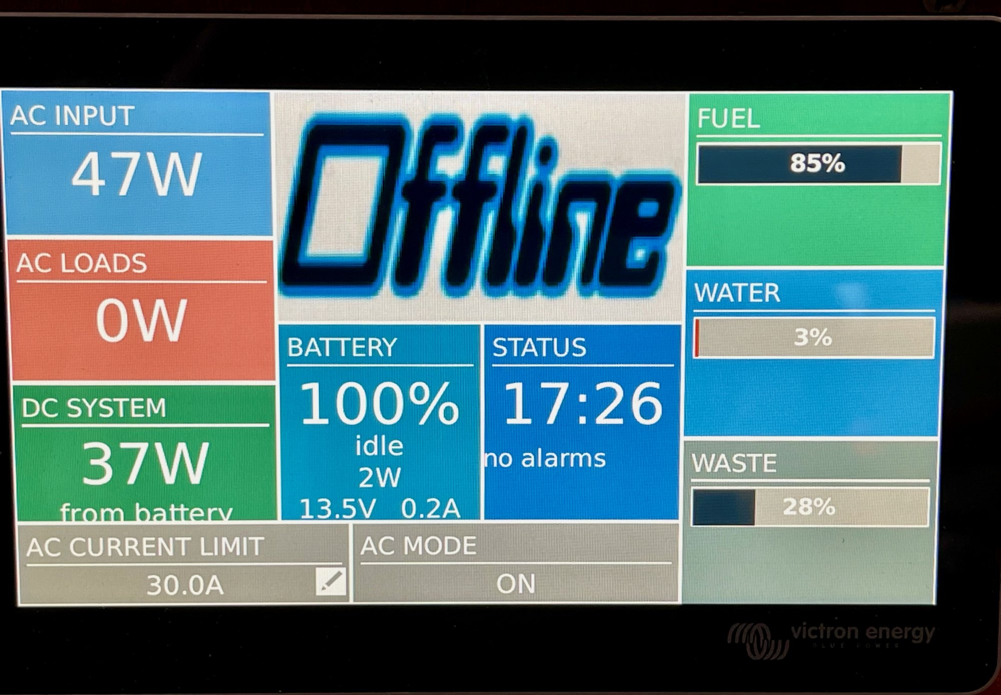

For Tank 3, the GX-140 puts out 24volts, so I bridged the Waste orange wire directly to the 10Volts on the regulator and only connected the Waste Sender wire to the Vin pin on the GX-140.
In the Cerbo you need to configure the full and empty voltage readings (Just like calibrating in the Snake River Panel) and the tanks size, fluid type and if desired you can calibrate for non-square tanks.
Once that was completed, I now had tank readings on the Cerbo.
To get the fuel reading on the Raymarine i70, I also added the Victron Can to NEMA adapter and then adapted that to Raymarine STNG. The Cerbo now sends Fuel, Battery and Inverter info onto the i70s.
