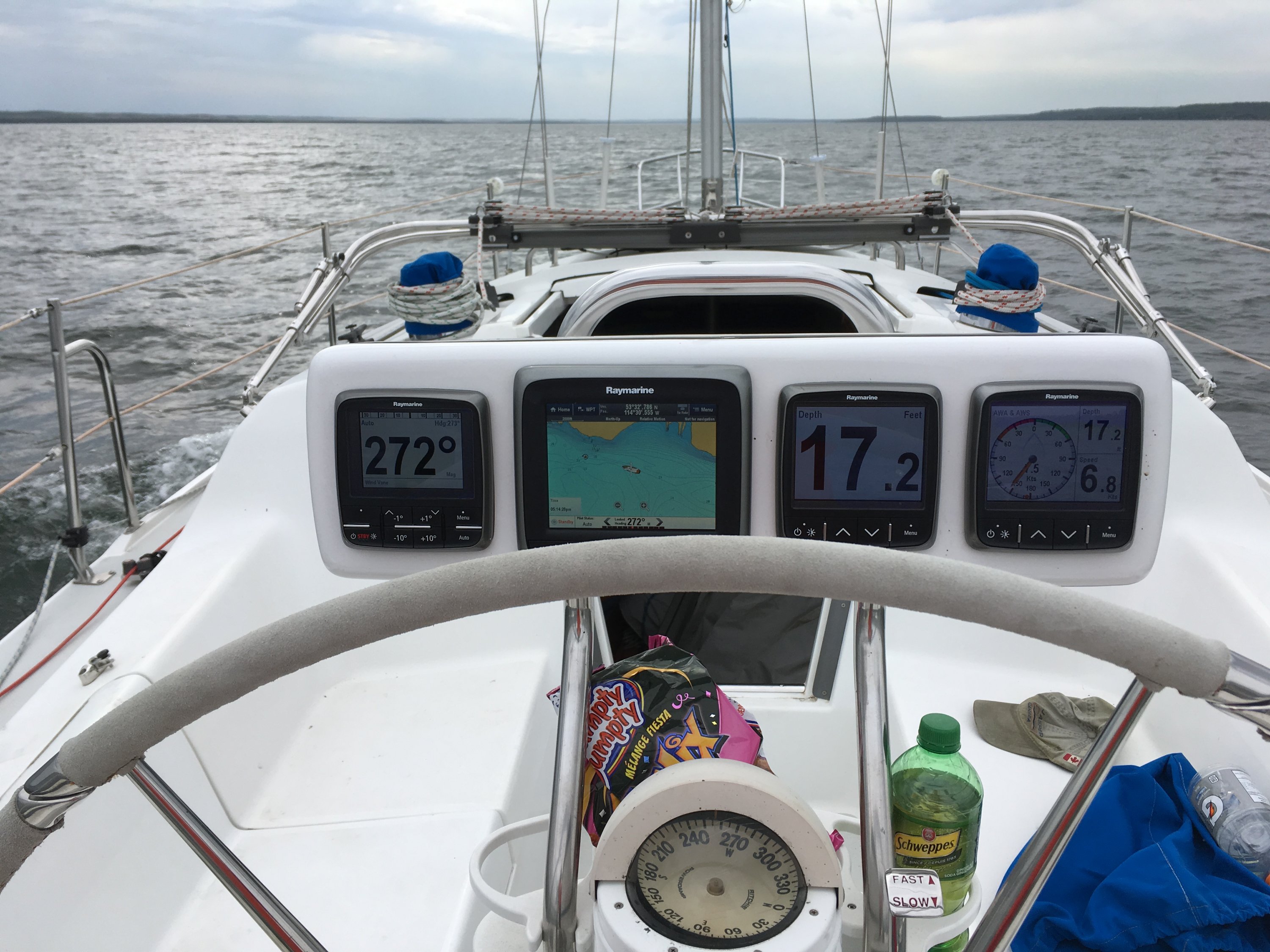

The Airmar transducers (speed and depth) on my C-270 (I-50s) installation are the very same as the transducers in our C-385, which C-125/I-70 is installed. Uses the ITC-5 for the analog to digital conversion.
