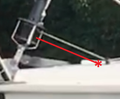

My 2007 H25 has a CDI Furler with no bearings and is a bit difficult to furl. Does anyone know if there is a bearing upgrade available for the drum assembly? I am hoping to keep the existing torque tube and upper swivel.

CDI doesn’t make a furler with an upper swivel. That doesn’t look anything like a CDI. That looks more like a Hood Seaflex than a CDI. It’s not a good pic, so I can’t be sure.

The furling line is not in the right place for furling and will bind. It should be perpendicular to the drum, aligned vertically with middle of the drum. It is entering at the top of the drum but it should be aligned at the middle.

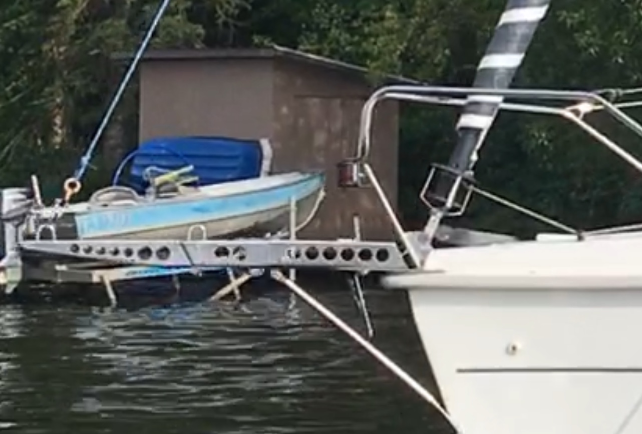

ps. Why is there a white and blue spiral going up to furled sail. That’s not normal. Is the UV cover too narrow to cover all the white Dacron? Is your headsail wrapped around the furler in the wrong direction?

ps. Is your headsail wrapped around the furler in the wrong direction? Why is there a white and blue striping? That’s not normal.
Good catches Judy. Maybe the problems are related. i.e. wrap it correctly and it may work better.
Aug 1, 2011
3,972
Judy, It's quite normal for that sail which is mostly carbon.
Jun 25, 2004
1,109
That’s not likely to cause difficulty when furling. Here’s why the stripe is cause to worry: If the white stripe is Dacron that’s exposed to UV, the sun will burn it in less that one season.
:plus:
I was going to say the same thing.
You need to position the fairlead forward about two inches.

The line alignment is a easy fix but that is not causing the problem (i.e., it's hard to turn the drum by hand as well). I have cleaned the bushings a couple of times and maybe they are just worn out. One issue which may be causing this is the luff tension which I keep fairly tight for the laminate sail (which by the way, is furled in the correct direction). Looks like I may need to upgrade to a new bearing style furler assembly in the future, any recommendations?
