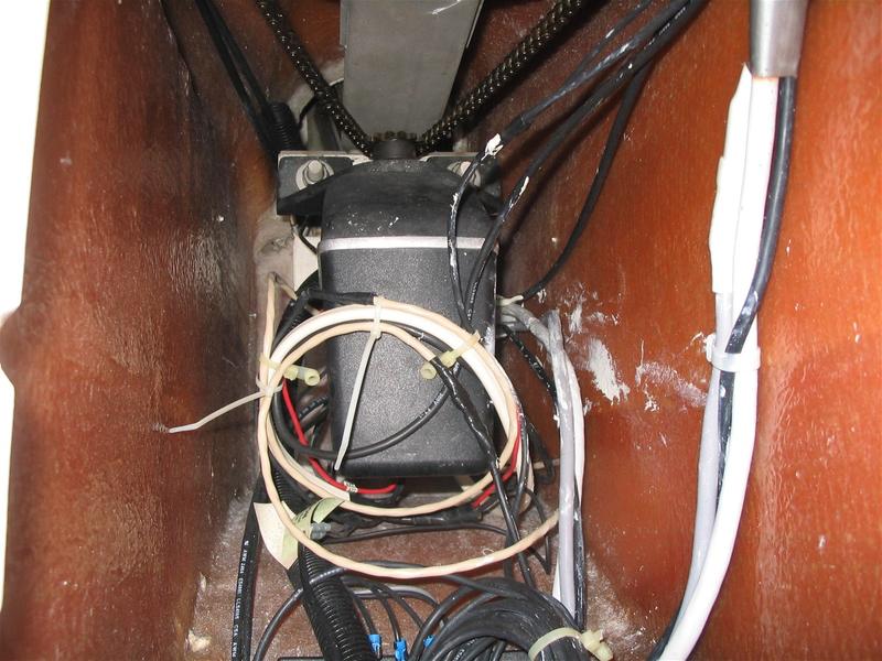

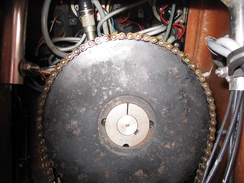

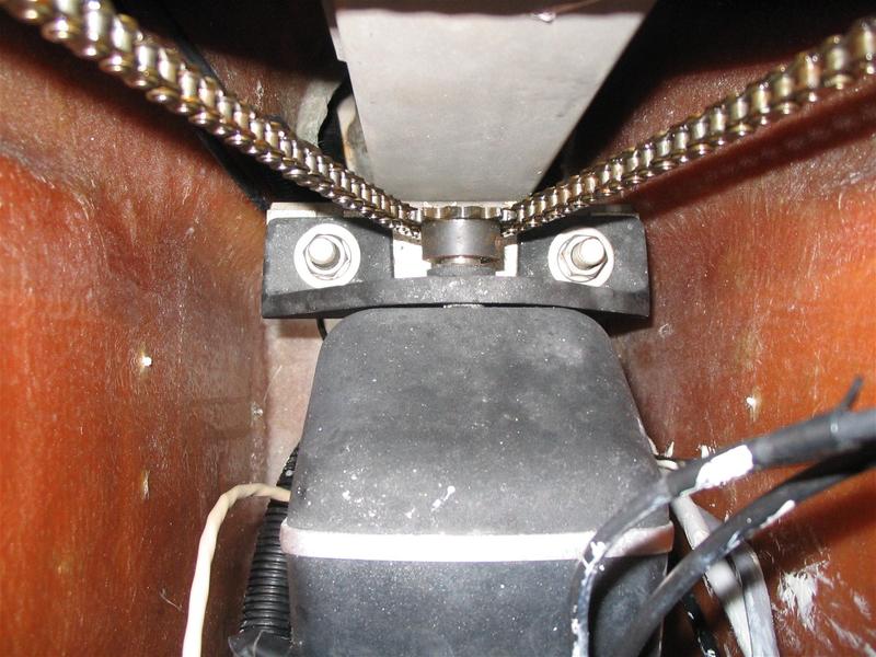

Thanks Rick, Yes Raymarine still makes Type 1 and Type 2 Rotary Drives. It looks like the Type 1 is the right size (sailboats up to 24,000 lbs) and it looks a lot like what you have installed (or something very similar). I see in pictures 1 and 2 that the drive is installed at the bottom of the pedestal and has a gear drive already on it. I am not sure what I'm looking at in the last picture? Is the chain something that is already there or is it something that is installed when you install the drive? The top gear looks like it is attached to a shaft, is that the end of the wheel on the inside of the pedestal and is the gear up there already there or do I have to buy one.? I cant take the pedestal apart to look at what I have there until the insurance agent gets down to "confirm it was actually a lighting strike." I'll be going with the newer EVO-200 autopilot and want to use the rotary drive rather than the linear drive, especially since it looks like our boats were built for the rotary drive.

You don't have to take anything apart. Just lift out the smoked-plastic drink holder and "ice box" it's attached to. The sprocket? I don't know if they were installed on the steering shaft by Edson originally or not. However, on another thread, there was a discussion about finding a replacement from any of a number of sources, so I think it should be readily available, either from Edson or another source. Good choice!
PS: you are looking at the back of the instrument panel in the background.
