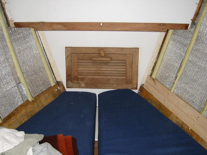

Pat's V-berth.
Pat, what are you doing in the v-berth? Looks like insulation and then new wood covering. What is the insulation and what kind of wood? Any other details would be appreciated. Steve is right, there needs to be a make/model reference. This will allow future archive searching to find your photos.

My neverending v-berth project
Ed, When I bought the boat 2 years ago there was a leak that was molding the hull liner. The smell was horrible. I ripped out all of the old liner and sanded the sides smoth. I glassed in 1" PVC water pipe split longways, glued up 1/4" insulation. Now I'm screwing in 6/4" wide 1/4" thick planks of Ash. The insulation is from a company called Low-E. They claim an R value of 7. Pat McCartin 1979/80 H30 "Therapy" Lake Lanier, GA

Therapy, right. . .
I understand. :) Thanks for the details on the v-berth.
