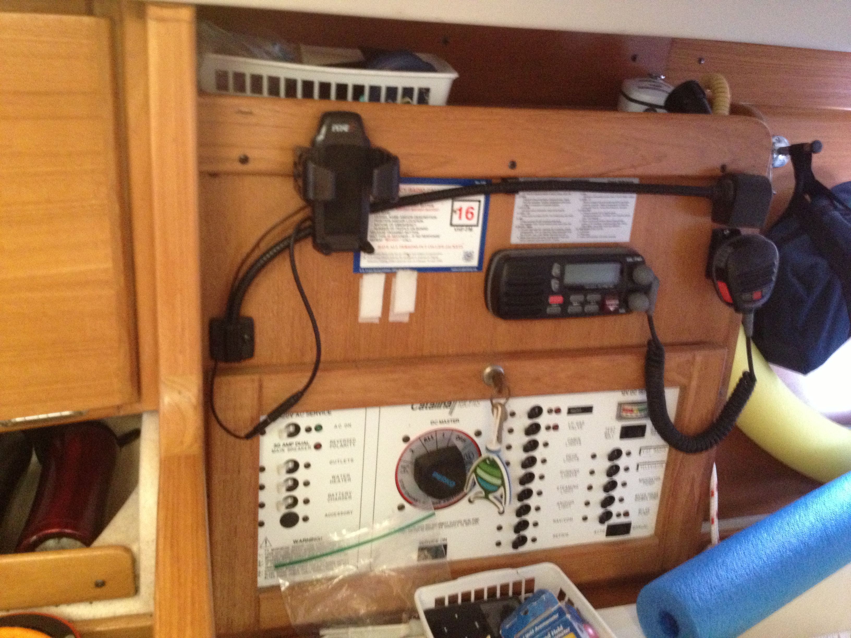

Based on previous comments from Maine Sail that sparked me to look at the specifics of the battery switch I have come to the conclusion that all battery switches not made by Blue Sea Systems are essentially crap. This means that our stock Perko battery selector switch was on the list for an upgrade.
After checking the measurements I was glad to see that the Blue Sea Systems 9001e Selector Switch would fit exactly in the same spot. The only down side is that the Perko switch had 5/16" terminal studs while the Blue Sea Systems switch had 3/8" terminal studs. This mean cutting off the old terminals, putting on new ones and new heat shrink. Using the same hydraulic crimper I had purchased last year (cheapy for Amazon) I made the new terminals. Luckily there was enough excess wire to do this without too much difficulty. I also had to add larger terminals to the wires from the analog volt meter and the bilge pump.
I did have to get longer machine screws to mount the switch to the electric panel. But the whole size is perfect for a direct change. This took about an hour and cost about $60 ($40 for the switch plus terminal lugs and heat shrink).
