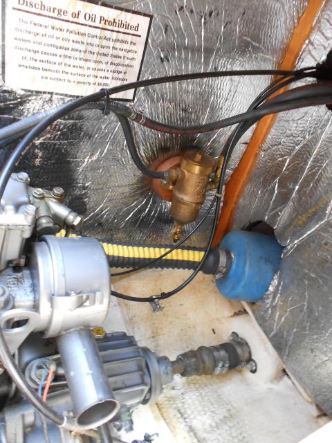

I snuck away to the boat yesterday. Currently there is a Perko Filter that uses part # 342-001ELM...I have not been able to find this replacement element. If I change the Perko to a Racor 10 or 30 micron will I still need the electric fuel pump?
I was hoping to place the Racor where the Perko is now...

When I first owned Ladylove I had fuel problems. I had to remove that Perko and put it in a vise to get it open. All that was in that can were tiny pieces of the screen that had rotted away. The boat already had a Racor installed after the Perko. I put the Perko back just so I wouldn't have to buy and install a new longer fuel line.

The screen in the Perko is in good condition. By the notes from the PO's this filter has been changed every 5 years. My biggest concern at this point is that I do not have a working water seperator. When motoring into chop on the way to get the bottom done the engine died. I am not sure if water or other muck got past the filters. I presume it was water because the engine fired right back up. I kept it at 3/4's to full throttle the entire trip down to the lift and did not have anymore issues. That was in May. I have not had any more problems with the engine (knock on wood) but I would rather be proactive than reactive. Also, I am not running anysort of Bio-cide in the tank although it has been recommended that I start using "SEA FOAM."
