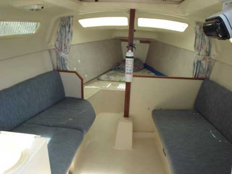

Seeking Hunter 240 curtains in any condition to use for pattern. Used boat came without them.

Yes, my 240 had the exact same curtains from the factory. My 260 had them also, but the P.O. removed them, and only the track remains.

I'm in the same situation and my wife is pushing me to get new ones.

I thought you were referring to window curtains. Yes there were privacy curtains on your 240 as forward privacy for the head and forward V Berth. You may want to see if they are offered at the forum store Sorry for the confusion

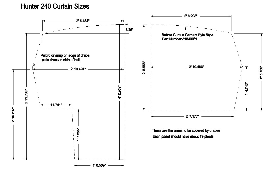

I have the two foot high curtain in the back end of the aft cabin under the cockpit. From the photos I have seen the pinch pleats are the same. I have measured the opening for the cabin curtains but this only gives me the length, not the width to allow for pleats. Attache drawing shows area to be covered.

I found the slide for the curtain track at Sailrite. They are good people. I have the two foot high curtain, located in the back end of the aft cabin under the cockpit. From the photos I have seen, the pinch pleats are the same on the main curtain. I have measured the opening for the cabin curtains but this only gives me the length, not the width to allow for pleats. Attache drawing shows area to be covered.

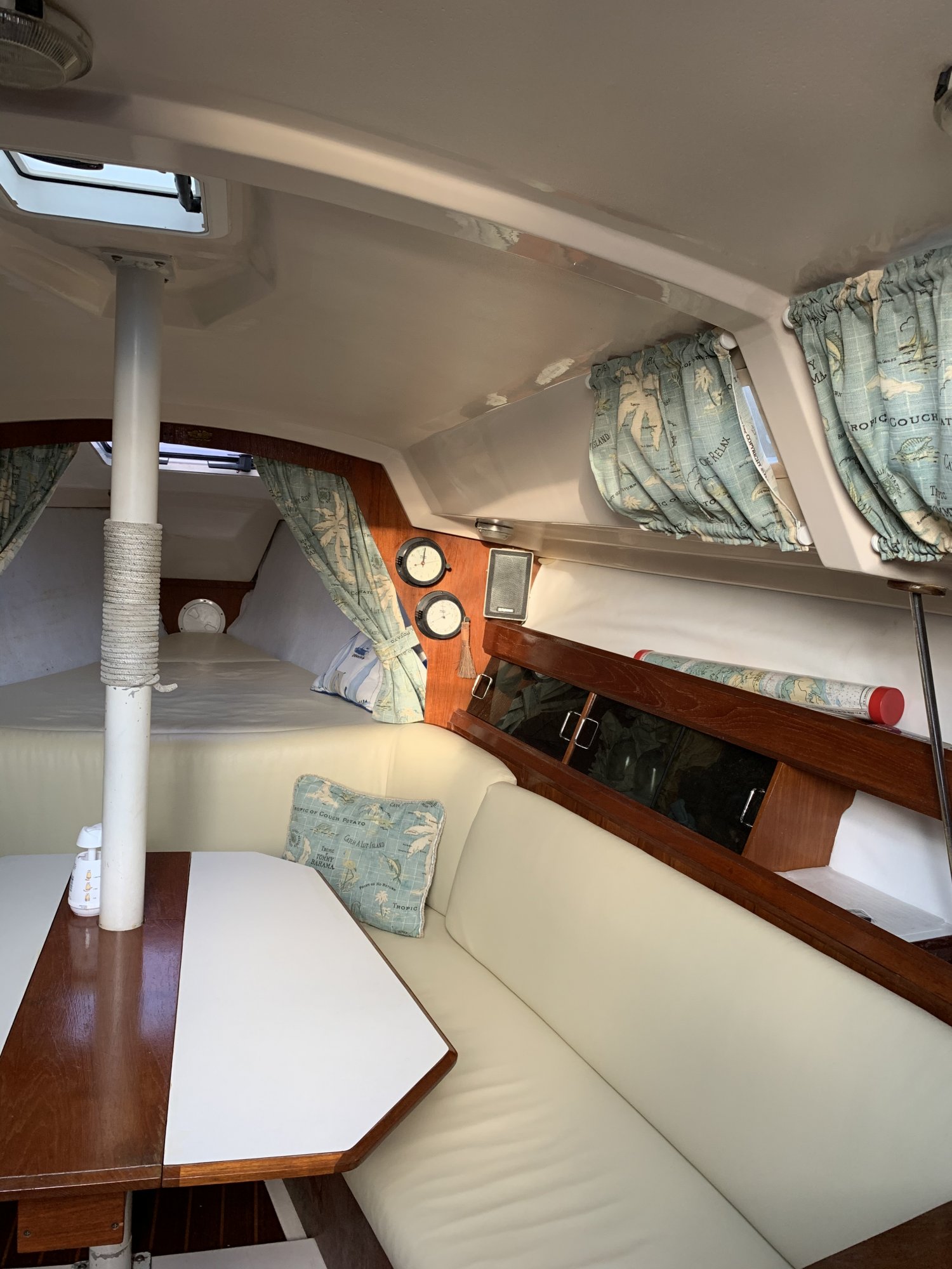

My wife made these and the interior had no curtains. I think she did a great job. The v-birth curtains are hung with a line with a hook in the center to keep it from bowing. The curtains on the side ports help keep privacy.
