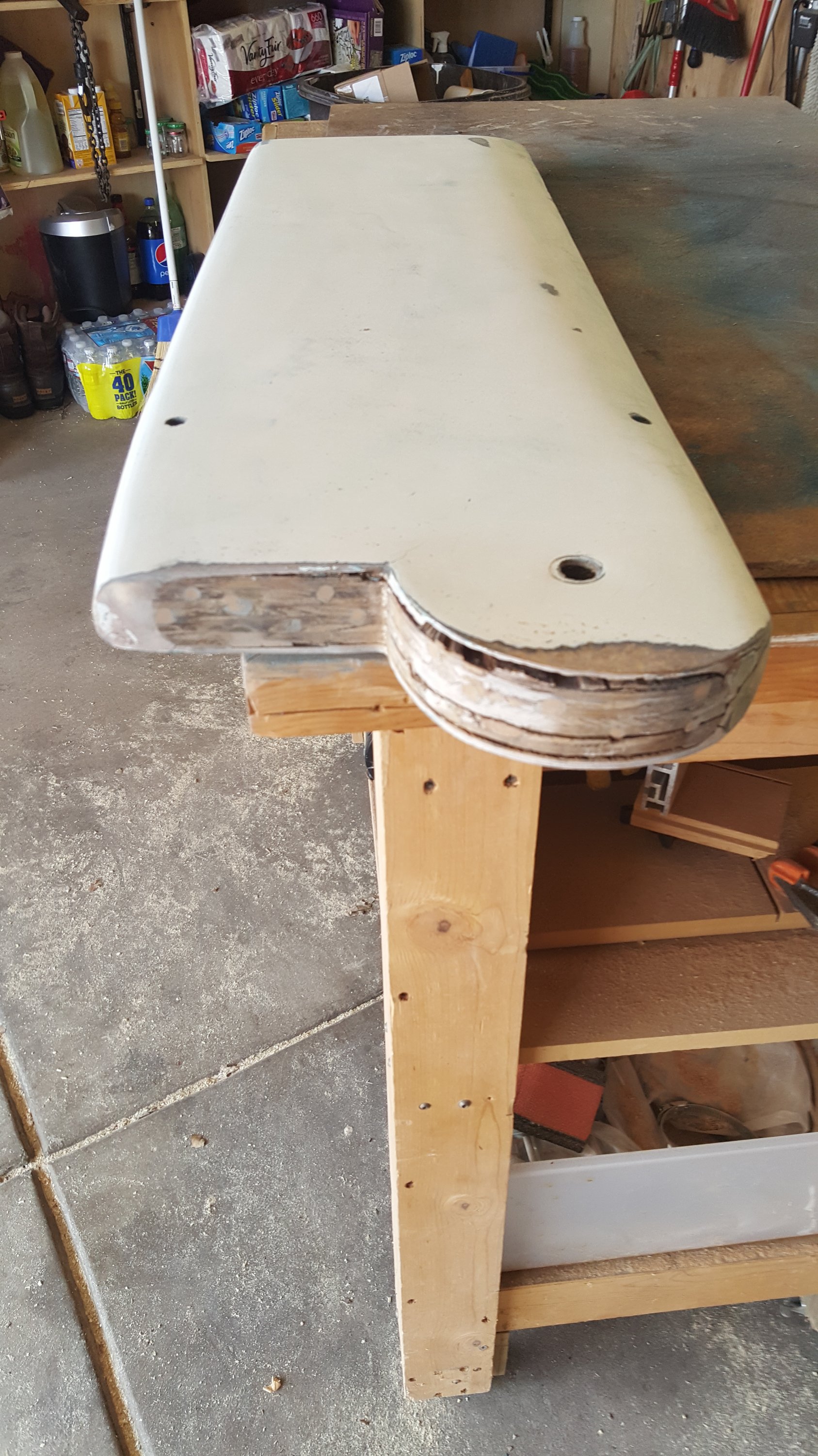

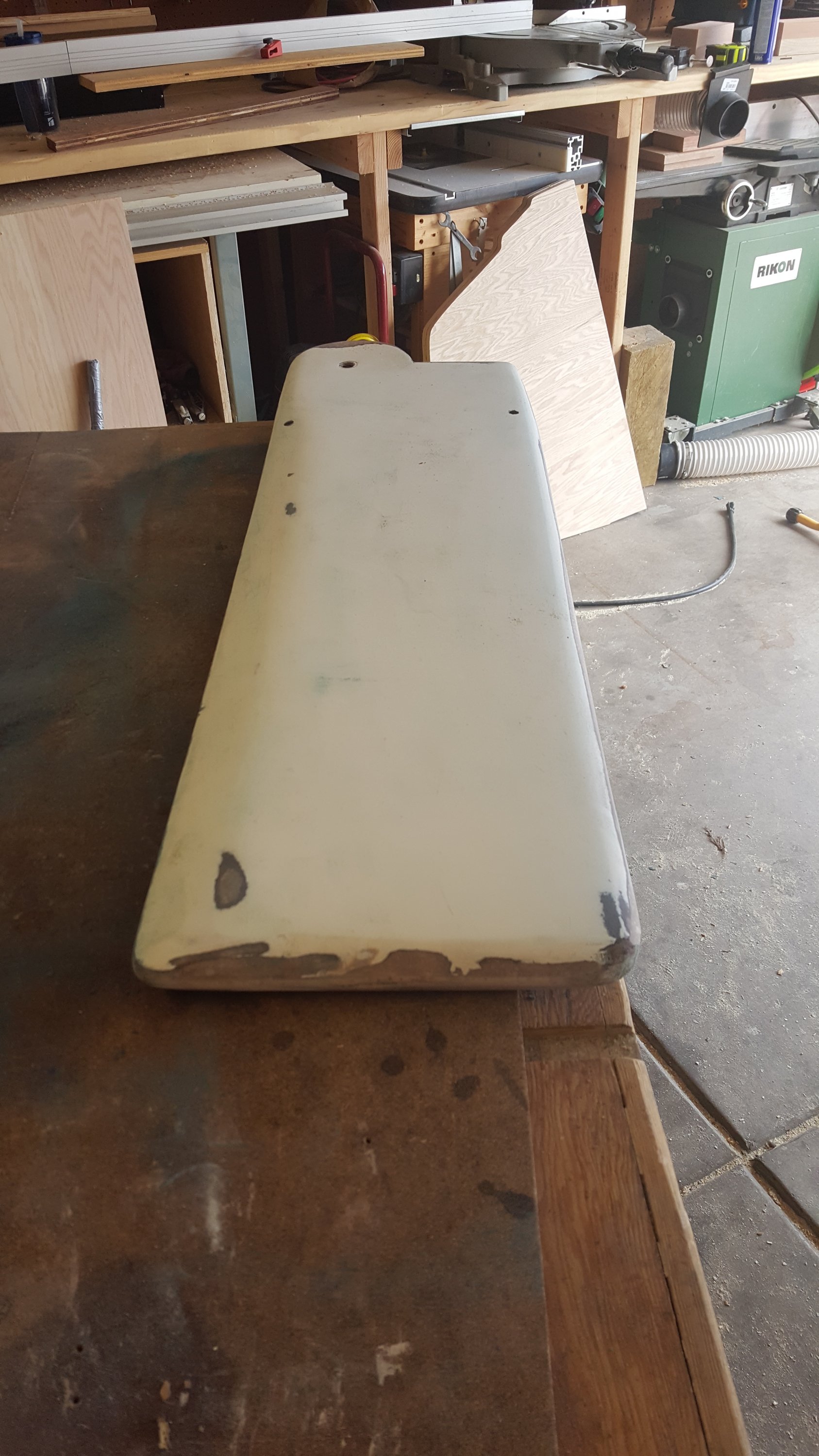

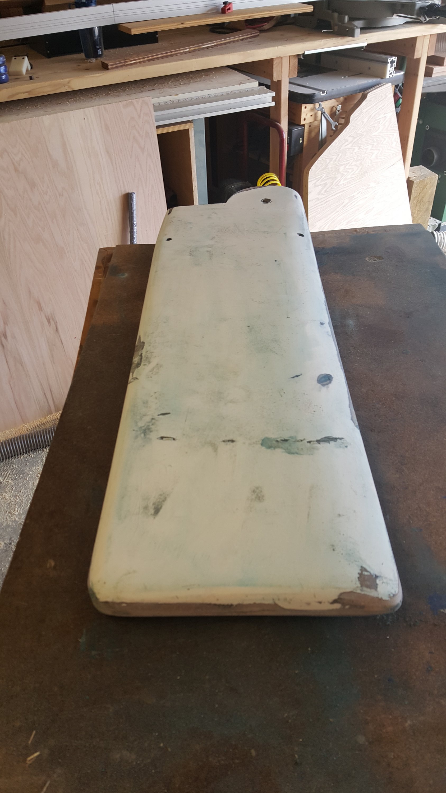

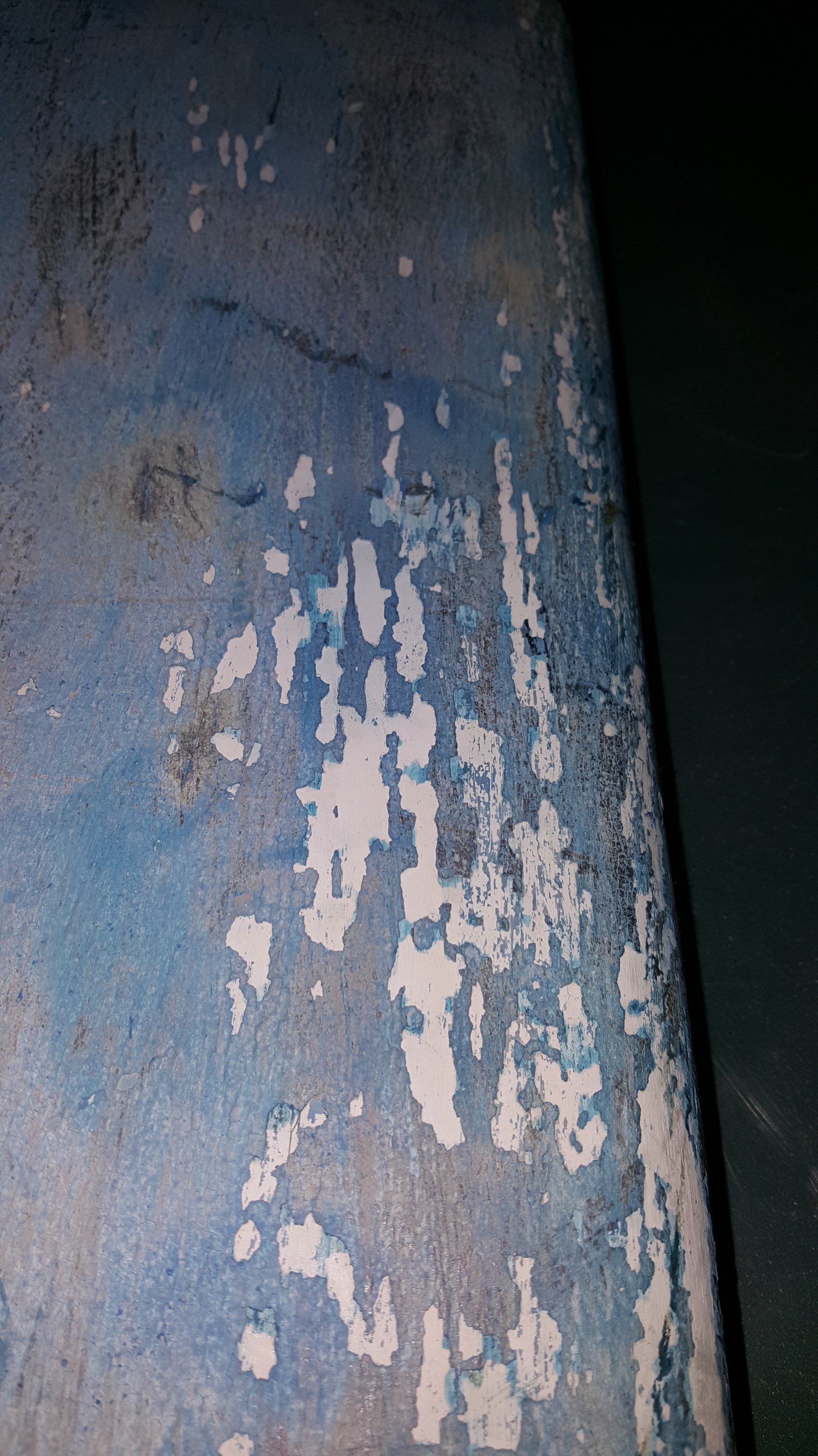

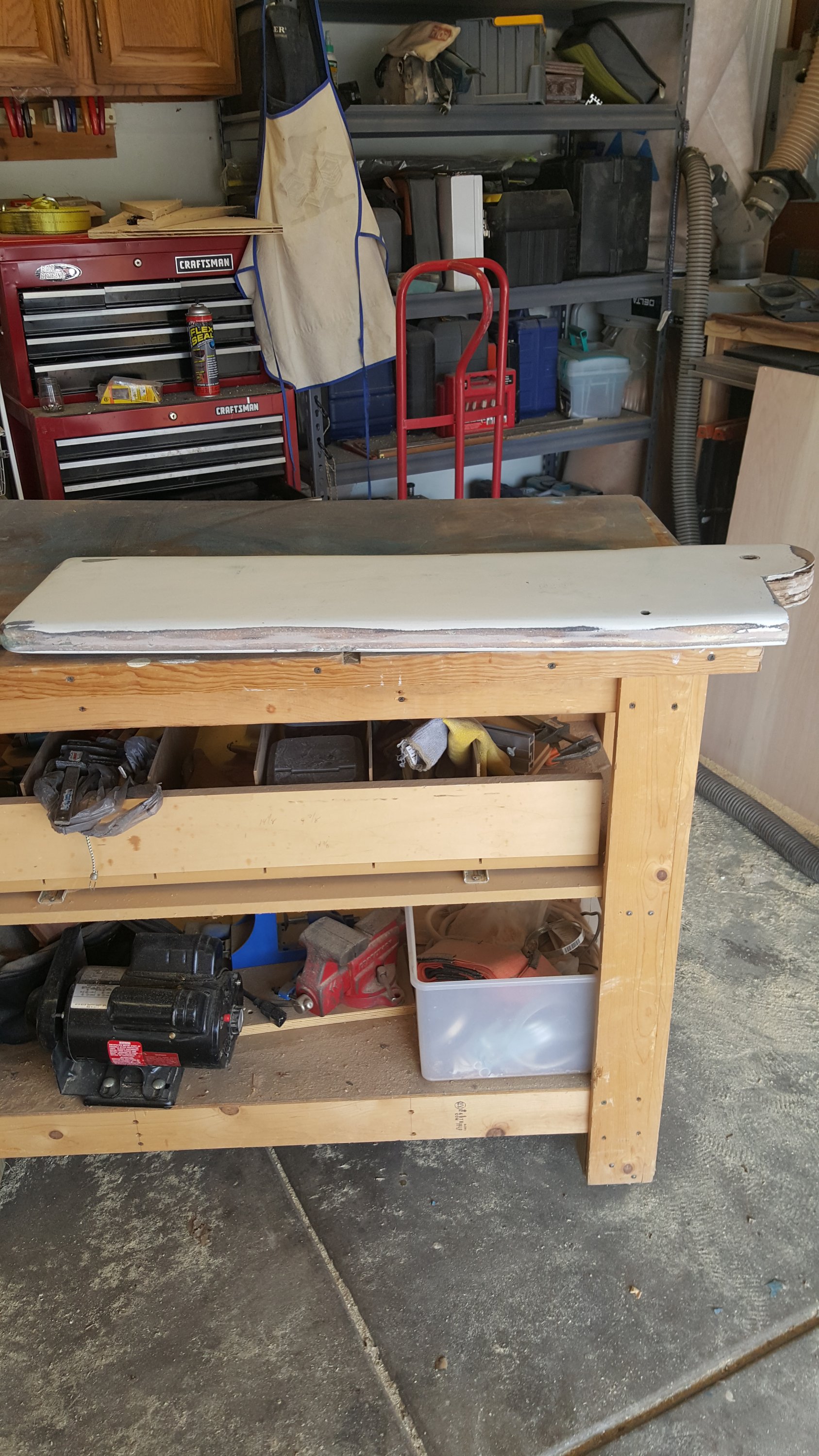

I own a Mac25 and I believe the bottom portion of the kick up rudder needs some work. I am attaching photos. The first photo shows the rudder from the top looking towards the bottom. It was at one time a nice shade of blue but most of the blue has come off showing the white color underneath (the upper portion of the rudder is white and in good shape). As you can see there is lots of wear around the pivot hole and the top where it sits against the other portion of the rudder has the worst wear overall. But, even with it open like it is, the rudder overall is very solid. No soft spongy spots that you might expect from water infiltration. Maybe its because how high up the problem is. The next photo shows the rudder from the bottom looking up. This part actually looks pretty good. The third photo is a close up of the surface showing the blue specks. Again, my thought is this is paint. My thinking is that I need to sand it down to get all the blue paint specks off. Then I need to do some fiberglass work on that top portion. I was thinking running some strips the length of the rudder with the sides wrapping up. It might need some more around the pivot hole also. The problem is, I've never worked with fiberglass before so I really needs some Fiberglass for Dummies level guidance.

Fiberglass is very forgiving. If you mess up, just grind or sand it back down. Piece of cake, really.
The oversized pivot hole can be filled with epoxy, re-drilled and a couple of bushings added to take out most of the slop.
The voids at the bottom can be filled with epoxy also.

So if I fill the voids with epoxy can i then just paint it over? Are you suggesting there might not be a need to use fiberglass or am I totally misunderstanding.
Yes, the fiberglass work could certainly be avoided.

So, I sand it down to get the chunks of old paint off. Then I mix the epoxy and paint it on. For the top part I would paint the epoxy on and let it drain into the voids then paint. Do I sand the epoxy with a high grit to make sure it is smooth? Any recommendations on what epoxy to use? Suddenly this project is not sounding so bad.
You can if you like. I don't race, so I sanded to 220 grit,
A thick, moldable type of two-part epoxy to fill voids on the exterior, and a thin, flowing type to drizzle into interior problem areas.

The only "Water Tite" I can find on the web is from Zinzer and is a paint. Is your suggestion that I use epoxy to fill the voids in the top and then paint on the water tite? My thought right now is to, step 1, drizzle epoxy into those voids and clamp the sides tite to the core while the epoxy dries. Then to do a "honey coat" of epoxy over the entire rudder, and to 220, and then paint with anti fouling paint. My hope is by putting the epoxy on thick I can do the entire rudder at once if I suspend it from the ceiling. As for the holes, I am going to insert a metal core (can't remember the official name of what the part is) into the hole that the bolt goes into and that way it won't wear on the rudder anymore. The other holes are just where the rope goes and I'll just redrill them.
Thoughts?

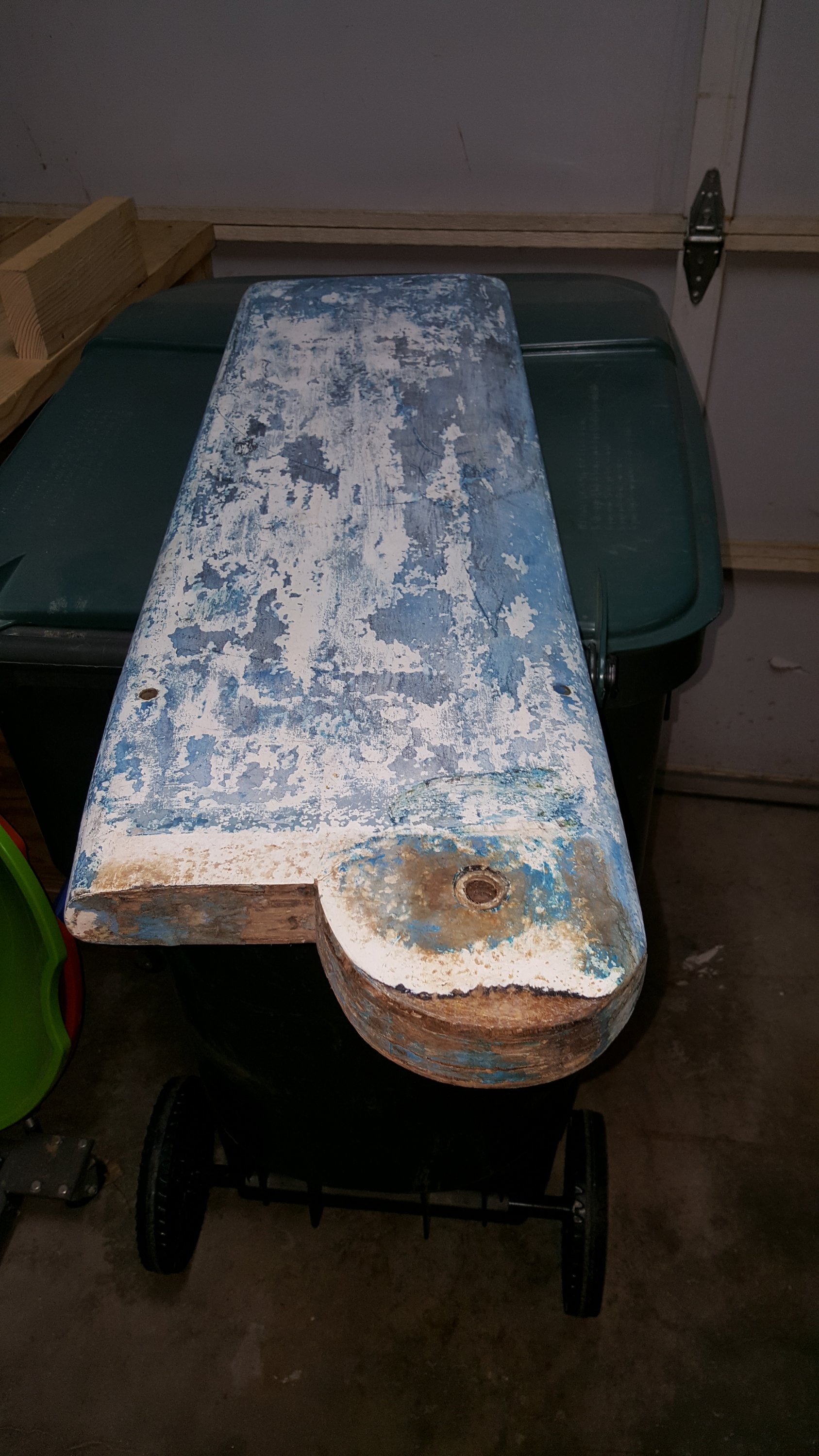

Update: Today I sanded off all the old blue paint from the rudder. There were just a few small spots where even the white base paint was worn through and just a spot or two on the edge that seemed to be past the fiberglass. I know in the picture there are areas that seem to be down to bare wood especially on the edges but there is still fiberglass there. Now, in the top part of the rudder I know I have to get some epoxy in there and clamp the two sides to fill all the gaps. My next step is to get the epoxy, do that, then, a good heavy coat of epoxy over the entire thing, repaint and reinstall. Overall, it sure looks a lot better than it did before.

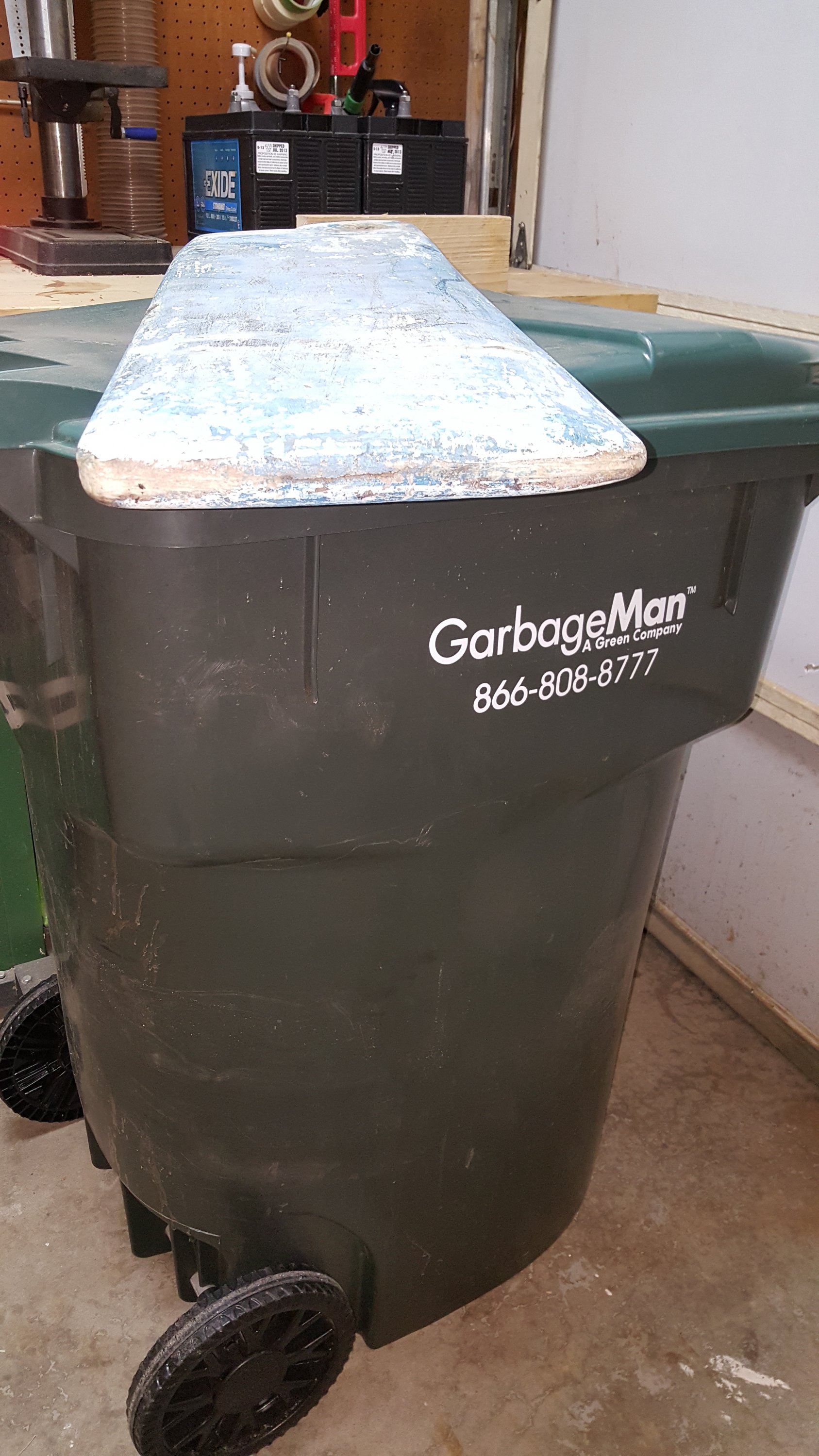

Mar 28, 2015
184

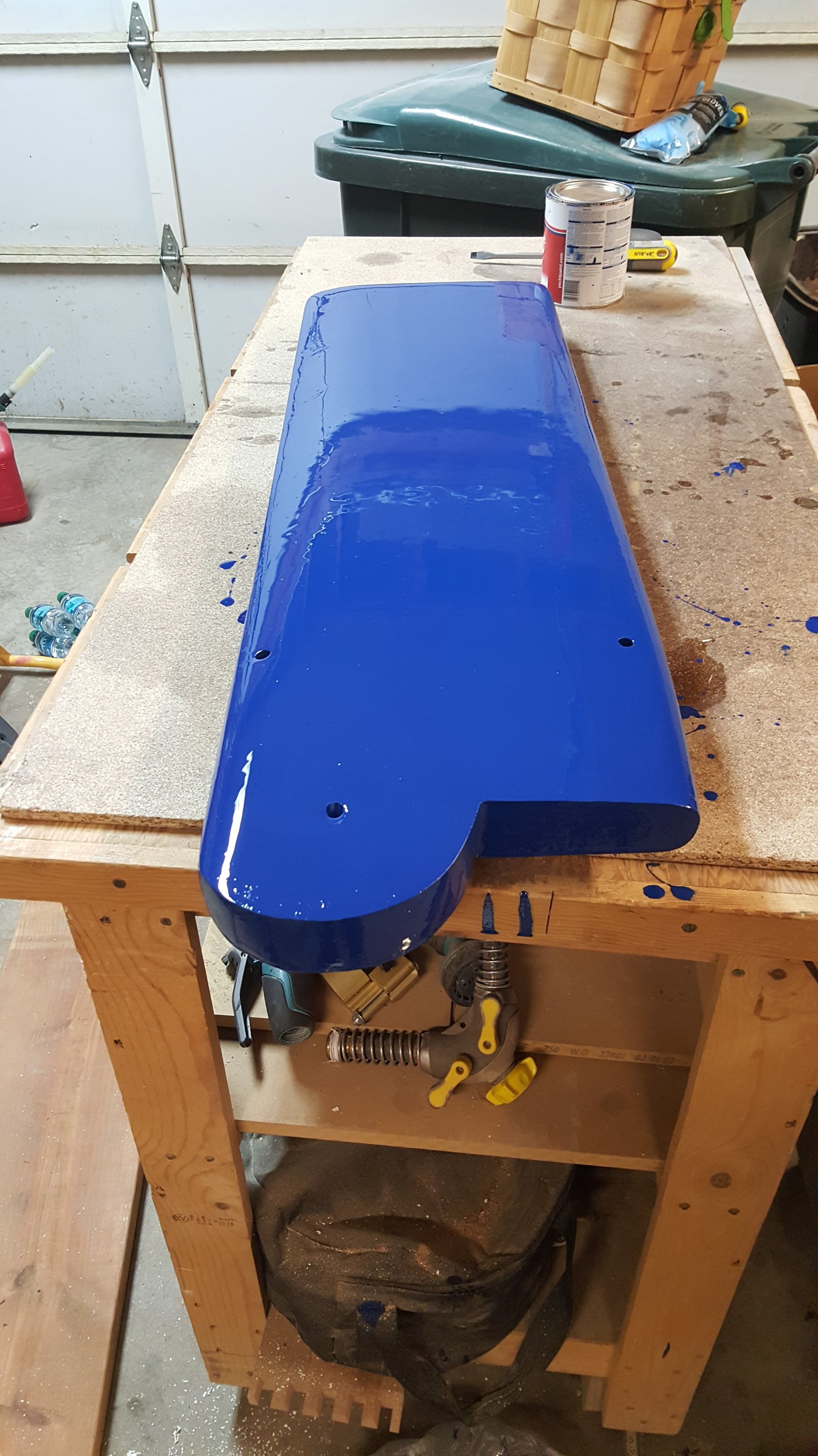

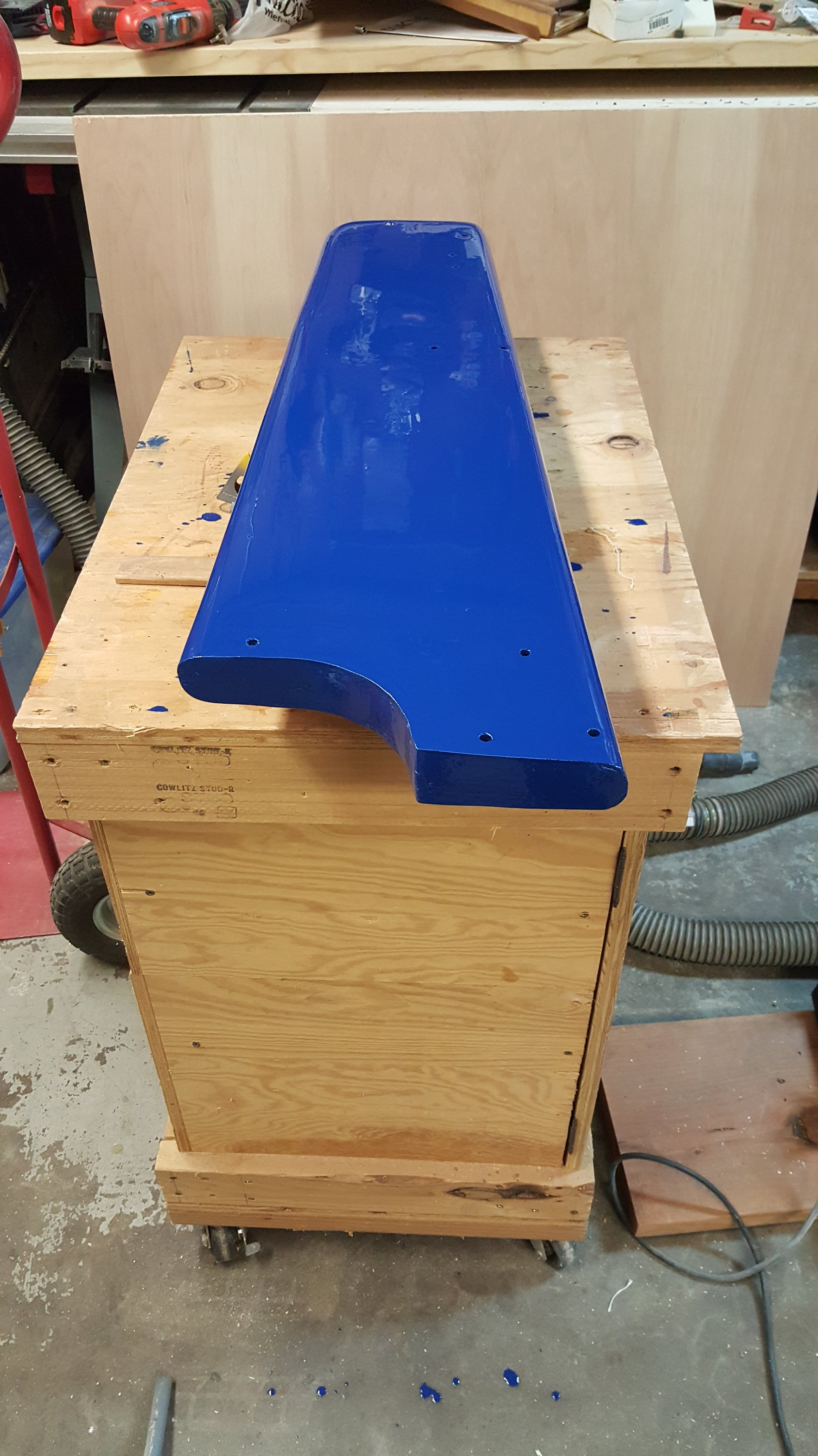

Macgregor 25 Cherry Creek
Got the new blue epoxy paint going on the rudder. The first picture is of the top portion and it has one coat on. The second picture is of the bottom portion and it has two coats on. Looking good so far. It takes 20 hours for the paint/epoxy to dry enough to sand and recoat so it will be a slow process. But since I want to splash the boat this Sunday I figured I would need a fully assembled rudder so... a painting I will go. The directions say 2 coats. But I'm thinking three for the lower half.
