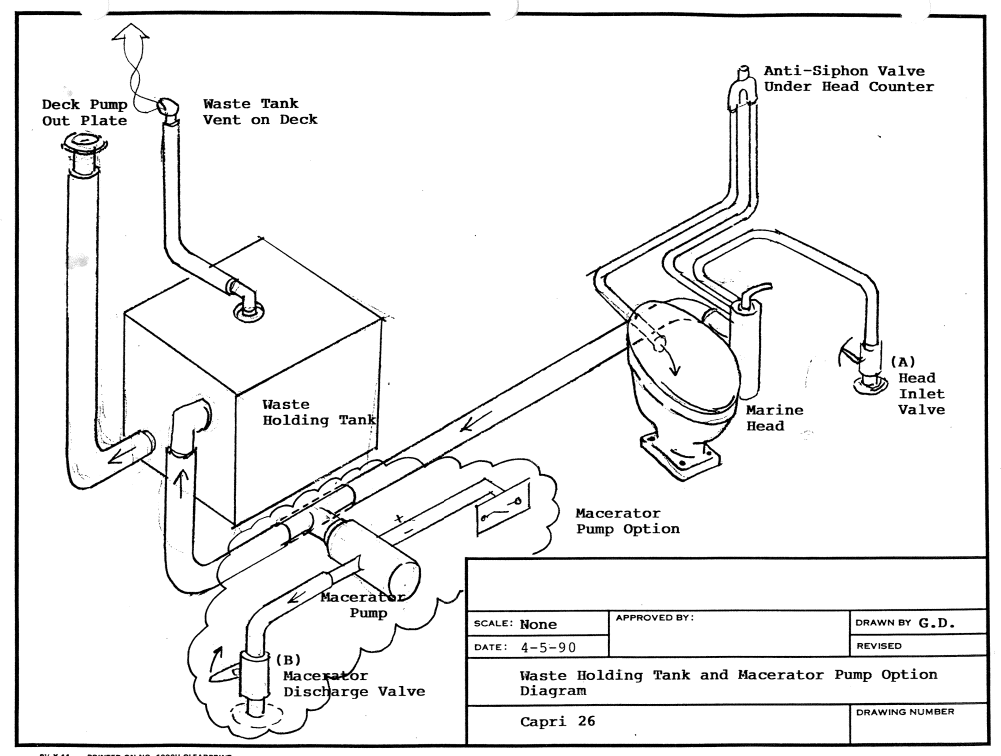

Also, just found this from the manual.
I think your "terrible" drawing is much better than the manual's drawing.
In the manual drawing, the macerator pump could never pump out the holding tanks as the pump's suction is near the top of the tank.

That drawing from your manual only makes my case that boat builders are the WORST sanitation plumbers on the planet! 1. The vented loop in the toilet intake is in the right place, but under the vanity is way too low to do any good. It needs to be at least 6-8" above waterline AT MAX HEEL, which on most sailboats puts it 2-3 FEET above the bowl and without any 90s;
2. The intake line makes a 180! 3.The vent line has 3 90s, the elbow fitting on the tank, another one in the vent line and a third one at the vent thru-hull. It shouldn't have any.

Ha ha - yes, you're exactly right. The drawing is not representative of how the macerator was actually connected. The pump out fitting on the tank is a T fitting. The top goes to the pump out and the bottom to the macerator. I removed the macerator hoses and capped off the T fitting.

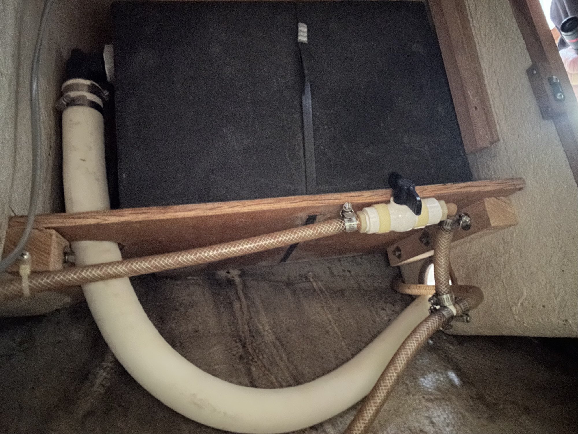

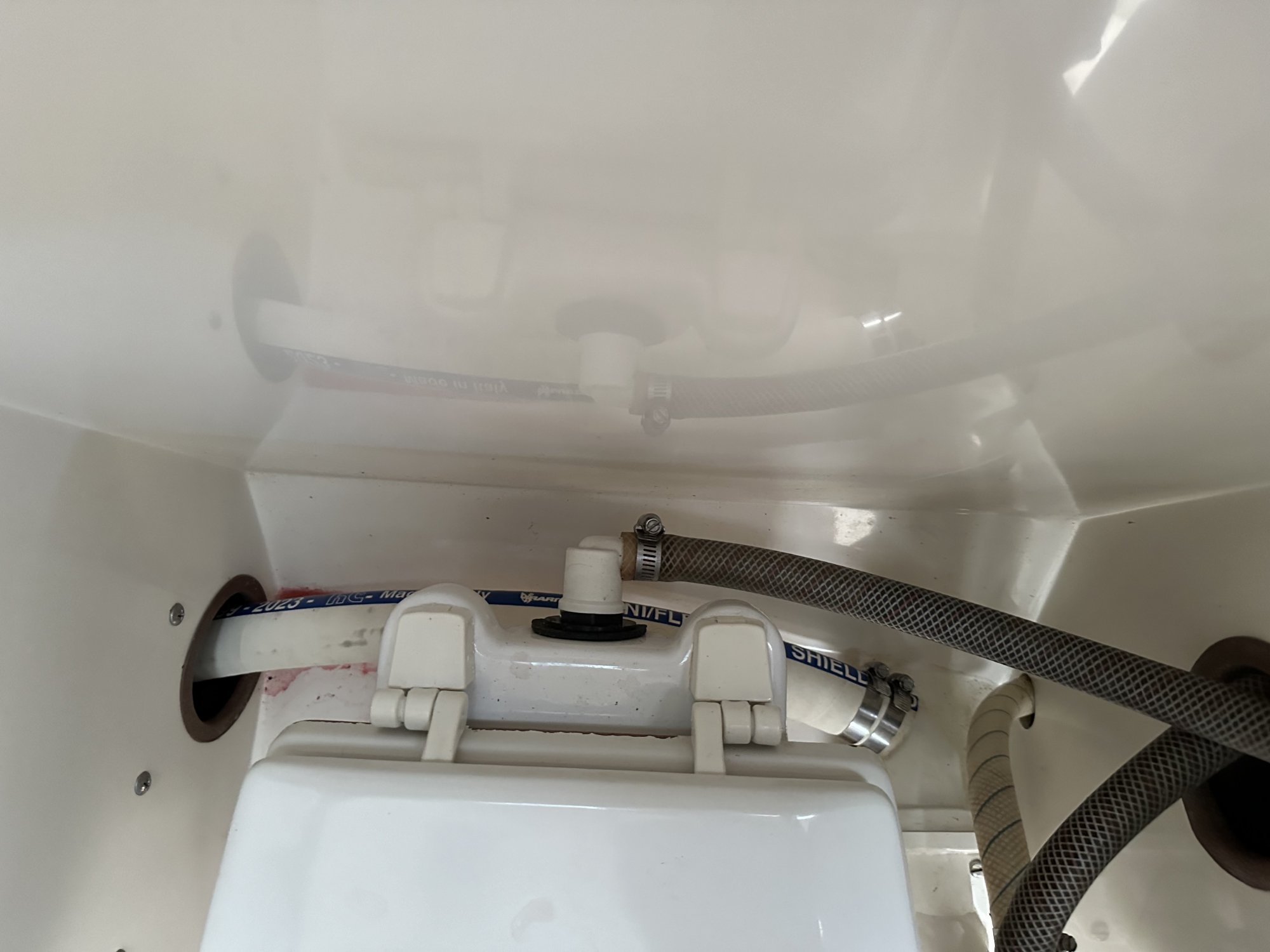

I snapped a couple of pics yesterday. Here is the line I am talking about. You can see it runs behind the toilet and then drops down slightly just after it goes through the bulkhead. Poor factory design notwithstanding would you change anything about the house run or leave it alone?
