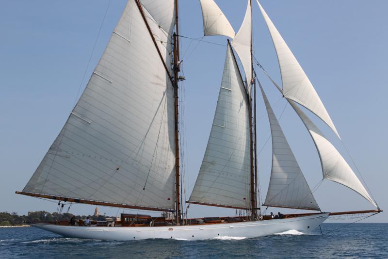

This is exactly why I believe there needs to be some new thought put into the design of a sail for in mast roller furling. We are going through the same thing right now, trying to get another year out of our main.
I do not think any sail maker has yet to specifically design a sail for inmast furling, or better, reefing, other than the battens thing.
I have decided that our next main will be cut like the sails in the attached pic. They will have very small panels and therefor they will be less likely to bag out between the seams. At the points that I reef the sail, there will be vertical chafe panels, as we sail reefed 90% of the time and that only makes sense.
If anybody can see a problem with these ideas, I would very much like to hear from you. Our main has probably only been used about 300 times and I'm very disappointed that it already needs replacement.
