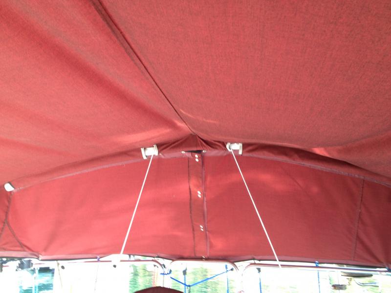

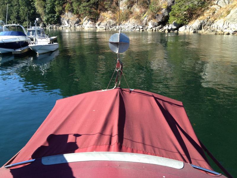

Sounds like you have got a similar setup as on Coriolis.
Like Skipper says, look for a channel in the rear of the canopy, the front attaches with the zippers to the Dodger, the rear is held up at the split backstay, really simple, took me a year to find out what the canvas in the bag was about.

Thanks for the picture. Does the aluminum pole attach to anything or does it just stiffen up the back of the canvas. Is there a connection to the backstay in the center of the canvas or just the two attachments to the split portion of the backstay?

Lou;
Answer is yes, to both, the pole stiffens up the back of the canvas, it is held aloft by a single center strap that clips on to the backstay at the split portion, next time ( tomorrow) when I am at the boat, I will take more detailed pics

I too have one of these that came with my boat. On the aft end of mine there is a pocket that the aluminum pole slides through. There are two cut-outs right at the split stays, the pole goes behind the stays while the canvas cut-out goes in front of the stays, creating a support system designed to hold up the back. I do not need anything else to hold it in place. On real windy days it will "wobble". I can use tie downs to keep it from doing that. Also, I have a separate, matching piece of sunbrella that I can attach to the side that hangs down to the coaming. A nice feature for late in the afternoon when the sun is low in the sky.
