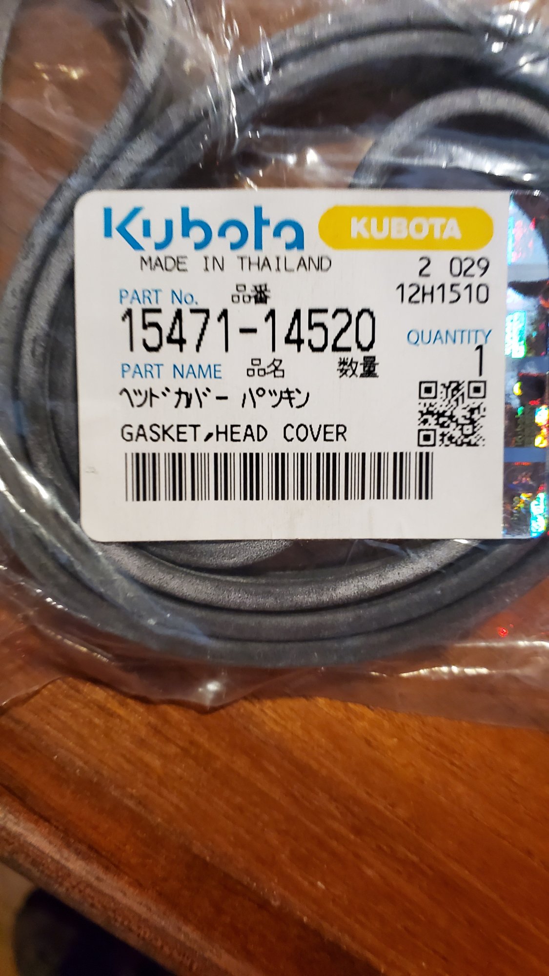

Did you get a new valve cover gasket or reuse the old one? If new, where did you get it?
Jan 5, 2017
2,447
I’ve gotten parts from my local Kubota dealer after I convinced them that my Universal 5411 was really a Kubota Z-500 in disguise.
