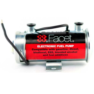

Check your fuel hoses, if they are old they could be cracked and leaking (I speak from experience). If your electric fuel pump is the first item in the system after the fuel tank it could be clogged. There is a course filter in the bottom of the electric fuel pump (I'm assuming you have a cylindrical fuel pump that has a hex on the bottom). Remove the bottom of the pump with a wrench and see if the filter is clogged. You can get replacement filters at auto supply stores. You can likely flush it out with fresh fuel to clean it enough to get you going again. The pump should be after your primary Racor so the fuel is filtered first before entering the pump. Re-plumb this when you get a chance if not already done. Fuel contamination is like slime so it is easy to clog up filters, remove the line from the racor and pump some fuel in a ziploc bag or mason jar and look at it. If it is cloudy and milky looking you have bad fuel and need to polish or dispose of it. As you use the fuel in your tank the contamination concentration in the remaining fuel increases. Also check the o-seal on your fuel fill cap. If it is old you may have had water leak into the tank. Another thing to consider is your vent line to the tank. If clogged you may be getting vacuum in the tank. Good luck and let us know what you find. Here's a picture of the kind of fuel pump I'm talking about. These were common on our M25 installations from the 1980's,
