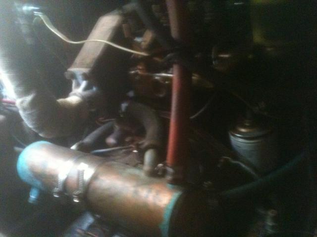

I've been thinking that I'd like to service my heat exchanger before there are problems with it. Sounds like a good idea to have it pressure tested. I've noticed a bit of corrosion starting to build up at the sides. Is this normal? The PO also profided a deticated zinc to the heat exchanger that I replaced two seasons ago. It is showing very little wear. The picture shows how the wire is clamped to it. I've read that it is a good idea to provide a dedicated zinc because the water that remains inside is isolated from the engine block and can lead to premature corrosion.
Is this the larger size?

rajhnsn, not sure what you mean by a dedicated zinc. The heat exchanger has a pencil zinc that unscrews from the bottom port side of the heat exchanger. The owners manual says to check it monthly, it is in the raw water circuit of the heat exchanger. You can buy just the zinc part of the pencil and save a few bucks but they do typically dissolve pretty fast and unfortunately the debris can clog up the cooling passages leading to flow reduction of cooling water. The exchanger is a copper based material brazed together so what you are likely seeing is corrosion of the copper causing the green film through the paint. Copper turns green like that. You can remove it, clean it up and re-paint it if so predisposed. I am looking to upgrade mine to the 3 incher. I think yours is a 3 inch but hard to tell for sure, take a ruler and measure it if you want to be sure.

Thanks for the heads up on the zink. I'll have to take a look at mine to see if it is worn away. The dedicated zink is attached to the hull of the boat. There is a grounding wire attached to the screw of the backing plate (small block of wood) which is attached to the heat exchanger.
