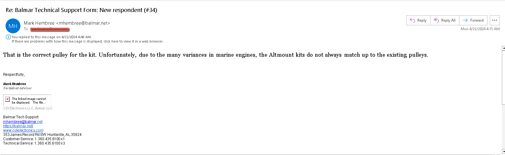

Balmar says that they sent the correct part which is sized to fit over a 128mm pulley but so far all M25XP engines I have been able to get a measurement from are 130mm. Does anyone have a 128mm pulley on their engine?
$450 for a part that does not fit, and their response is "Sucks to be you".

balmar says that it is the reseller PKYS problem and PKYS says that it is a balmar problem. Both of them tell me that they will offer me no refund. Buyer beware.

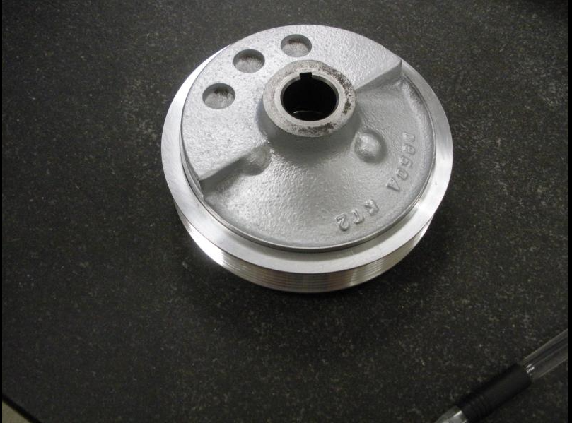

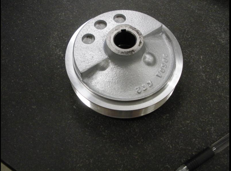

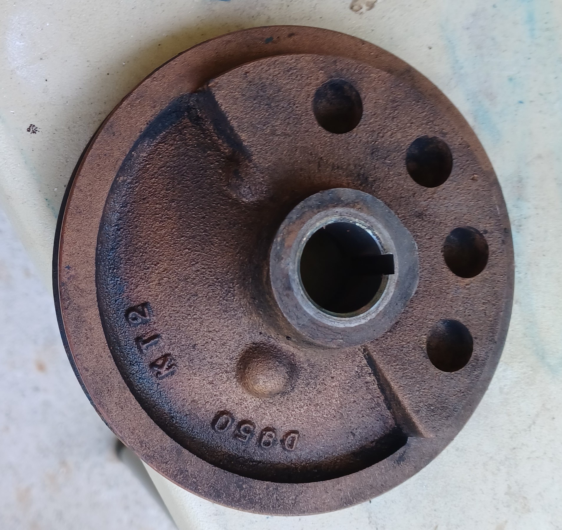

I beg to differ on the issue of balance, but the front pulleys are critical because they are balanced to each crank so changing the center of mass will affect the harmonics of the engine. On the M25, the pulley / balancer has a large cast counterweight and then there are holes in the casting to correct for each shaft pulley pair.
This is the pulley from your engine. note that it has three adjustment holes.
This is the pulley from Papillon and note that it has four adjustment holes. It is very important that the pulley made for the engine crankshaft remains on that shaft. If you must change pulleys or shaft due to damage, the pulley should be rebalanced to the crank.

On the otherhand, this photo is of a pulley that was made by a forum member, and he told me that the original OD was 5.1". The balancer is clearly stamped D850A KT2 which is an M25 and not an XP. As I said, I have measurements from two M25 and two M25XP and they are all 5.1" / 130mm in diameter.
