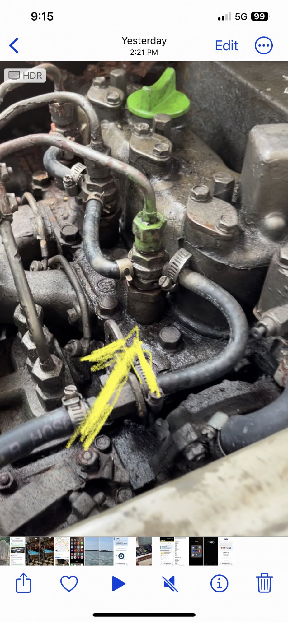

My M25 started stalling yesterday. I thought it was the fuel or water, drained the separator and replaced fuel filter, then bled the line, and she started. Ran for 45 mins and stalled. So I bled her again, and she started and ran for 45 mins, etc. I saw small bubbles coming from base of Injector Assembly where it touches the block, so I'm thinking that might be it?
What to do? Any advice?
If it is the injector, can I just tighten it somehow, without removing it, replacing washer, etc?

What I see is dampness on the engine head. It can be oil or diesel fuel. I suspect the latter. The return line hose with the hose clamp also looks damp. I would suspect that is the source of the diesel fuel that is found on the head at the base of the injector. I would replace that length of hose. New clamps, and clean/wipe down the engine head surface so you can see if there are any more leaks.
Now for the bubbles. The injector at the base is inserted into the head at the top of the cylinder. Fuel comes out of your High Pressure Pump through the steel fuel line at the top. It is forced into the injector which meters the fuel into the cylinder. At the same time the fuel is injected, the piston in the engine is pressing up in the cylinder. The pressure rises until the diesel air mix combusts driving the piston down.
If you have bubbles from this process they would be under extreme high pressure. You may have some escaping partially combusted exhaust from a failed washer between the injector and the head. A little tightening will not resolve that nor will it address the behavior your engine is exhibiting. I would address the injectors when you do an engine service. I would not wait too long. These issues never resolve themselves.
