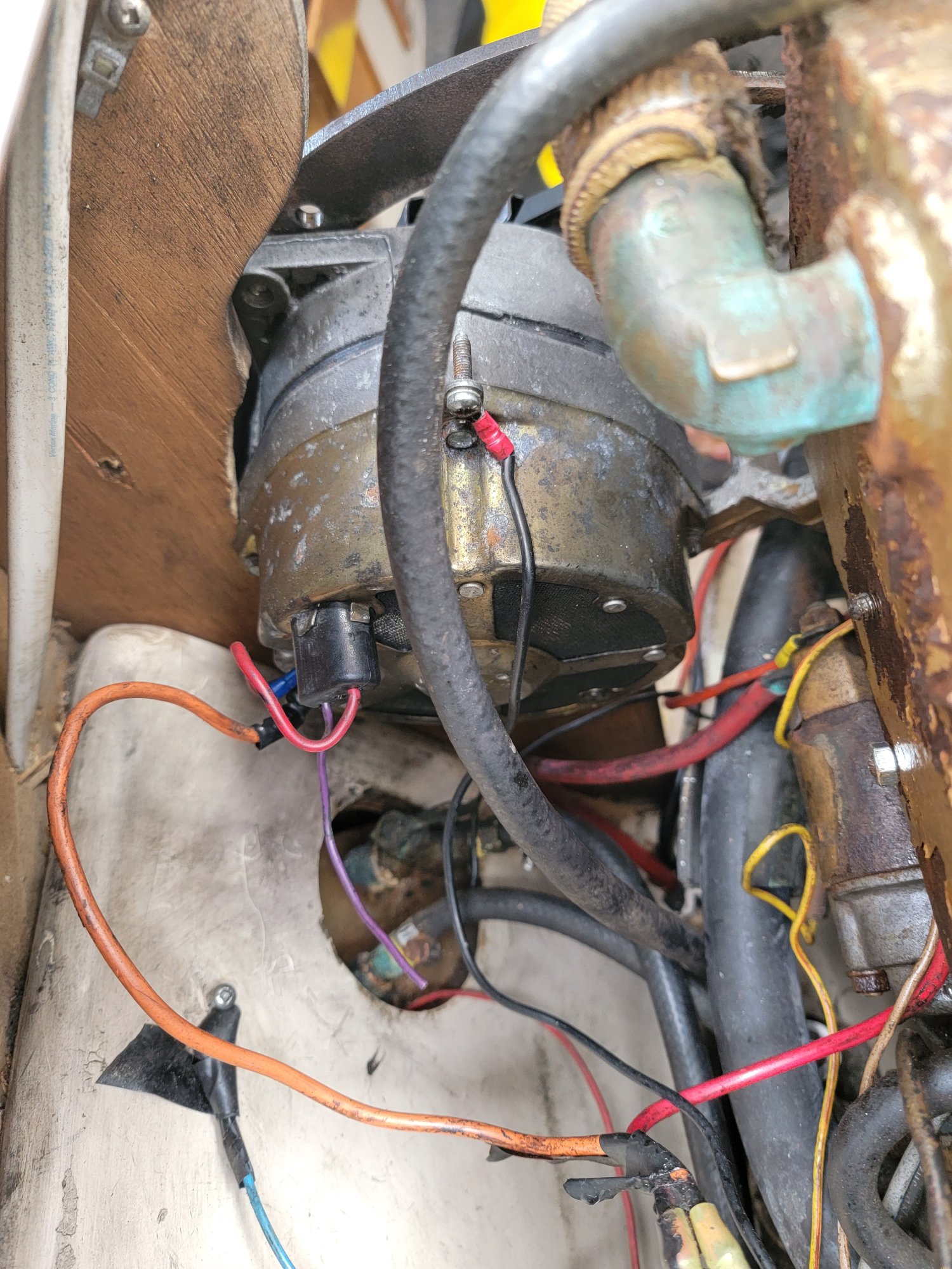

any recomendations for alternators for an m18? (i have 3 batteries + solar panel, autopilot. no fridge). ideally one with tach signal
backstory: the boat came with what im told is, incorrectly for this boat, a delco. certainly its preventing me installing the bracket upgtade as it fouls the tension arm... and the unattached purple wire always concerned me! What is this wire? Had assumed it was the tach sender (as the boat has no tach) but could it be intended to go to the ignition?

thanks both - actually looking more closely I think my current alternator is not a Delco as someone had suggested on another page but looks more like an Arco - just not the model recommended.
The problem is @jssailem is that the alternator that is in my boat isnt correct- at least i cant use the upgraded bracket. I could certainly ask for a 'smaller alt than this one' but its kind of hard to quantify. Its not like buying a washing machine for a tight space where the dimensions are everything

Pictures will help the shop help you. Use a tape to help the image. Configure the new bracket upgrade then show the image. They may or may not have what you need.
I have often heard that it is the technician who manages the install. The manufacturer just makes products. The shop I visited the guy was helpful. The images I provided gave the shop what they needed.

1. The upgraded bracket should be your HIGHEST PRIORITY. Why? What is your ENTIRE engine worth to you? If that old bracket lets go, your engine is KILLED because the gear case gets rapped and they don't make those cases anymore. Believe me, buddy, my old bracket let go in 1999 and I was lucky: the oil filter saved the day but it got dented and leaked all over. I was running at slow bell when it happened. Do NOT minimize this risk.
2. Then go learn about different alternator sizes, go measure what you have, put a ruler down in where you took your picture and take pictures of the measurements, draw a diagram, take a video, and find the right alternator(s). Denial is not helping you here. ASE Supply has tons of alternators and they know your engine. Maine Sail's www.marinehowto.com discusses Universal alternators and describes their feet and sizes. A little Googling will "learn you" all about alternator sizes and descriptions. Really, don't tell me you can't do that?!?
You NEED to replace that alternator and mount the new bracket. NOW, before you go use your boat again.
Back again: this link shows the wiring colors in a wiring diagram. Make one for your boat and do some research to see if your colors are the same.

Thanks @Stu Jackson and yes I have been following your recomendations and thats why i find myself staring at an alternator that is now evidently wrong for the boat, and am looking for the right one so i can finish the job. I got as far as bolting the bracket and alt in before realising there's no way it will fit without further action; perhaps fabricating a new, longer tension arm (a friend has offered, for free) but my preference is to get the correct alt so i dont have to mess around with non-standard belt lengths, hence my question as to any advice on an average alt for an average M18 boat
