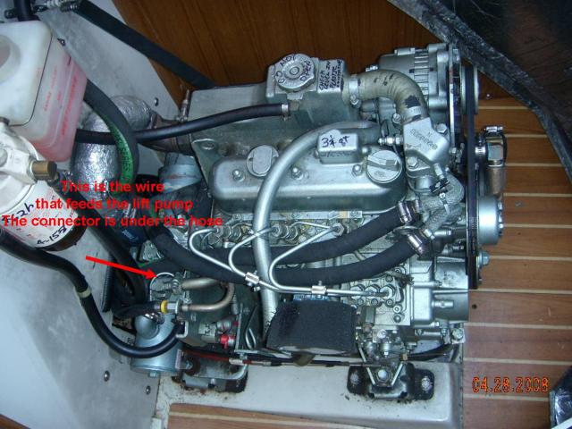

Just reterminated starter solinoid cable after came out of its crimp ......now replacing the lift pump cause thats stoped working yeah...not that easy getting parts for these engines in Australia :cussing:

When you turn your start key to the on position but before you press the start button, do you hear the alarm ring? You should be hearing it until the engine starts. If you don't than clean the shovel connector that supplies power to the lift pump. The wire with the shovel connector that feeds current to the lift pump is located right on top of the engine where the lift pump is, see pic.
The alarm circuit is designed to provide it's ground through the lift pump. Once the engine starts that same wire is now providing the power thus changing from 0V to 12V silencing the alarm. If there is an open circuit to the lift pump the alarm will not sound. The engine will run fine with a full tank of fuel, but when it gets to ~3/4 than it will start loosing power, and will eventually quit from lack of fuel. Your lift pump may be fine.

Lift pump
Got a new lift pump the old one did not pump at all , took some effort to bleed the fuel system the secondary filter seems to hold on to a bit of air for some reason ,,,,,,Is there any benifit in having your primary filter where it is in your engine bay Witzend ? does it make it easyier to bleed the system when you change filters etc ?
