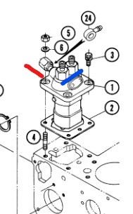

4 - bled the high-pressure engine fuel pump where the fuel comes in (red in the picture below) and all was fine.

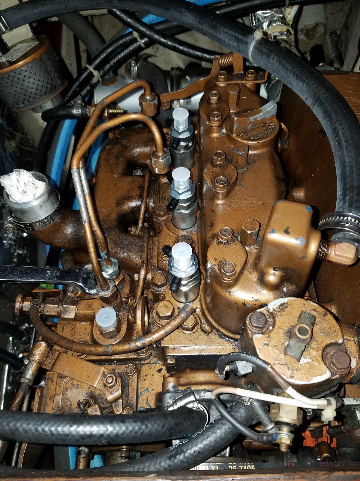

5 - loosened the lines that go from the pump to the injectors. Cranked the engine but nothing come out from either one (before the lines to the injectors - blue in the picture below).
It would appear that the engine fuel pump is dead.

How does that pump work? I haven't found any pictures of it other than the diagram I attached.
It looks like there is a cam turning below it, and it presses on the bottom of the pump, which looks like a little piston that goes up and down and pumps fuel.

Is there any way to have someone crank the engine, stop cable in the run position and you very carefully unscrew a supply line at an injector to check for the injection of fuel from the high pressure pump ? Extreme pressure fuel at that site so goggles and a rag around the fitting are mandatory.

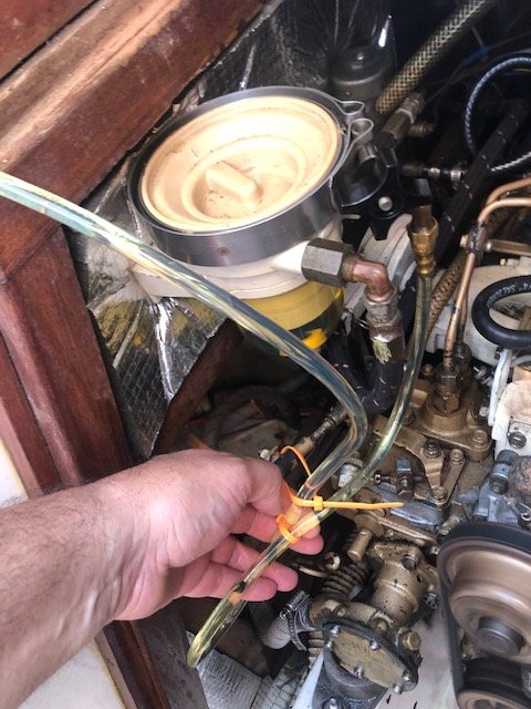

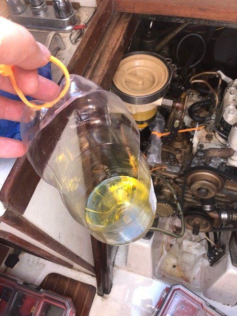

UPDATE:
Yesterday I closed everything up.
I supplied clean, new (automobile) diesel into the Racor via a soda bottle and some appropriate plumbing fittings.
I bled at the input to the high-pressure pump.
Cranked the engine, and VIOLA !!! it started and ran like a champ (knock wood).
