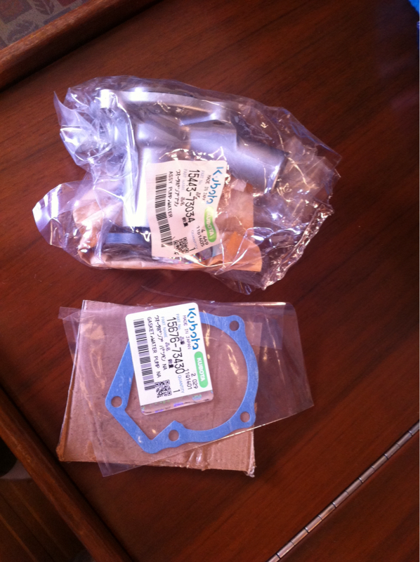

I just installed the coolant pump new in 2015. Original Kubota part.
Now it’s leaking from the weep hole. It spit about a 1/2 teaspoon out when I fired the engine today for a few minutes to run it after sitting a month.
Also it’s rusty coolant dripping, but I open the expansion tank and it’s all green. I replace the coolant about every 2 years.
It’s been about 150 hours. 5 years.
The original one from 1984 lasted 1,300 hours and 31 years.
Is this new one failing just a fluke?
Why the rusty coolant color at the weep hole?

It was an original Kubota part. I’ll try to attach pic of it packaged.
I understand the weep hole. Hence my identifying the pump as having failed. My question is, is such a relatively quick failure common?
I’m guessing that the bearing rusted, causing the red color. So that means the seal breached. Seems odd considering the healthy longevity of the original pump.
10,108
My opinion is that 150 hours is not normal.. That one had a bad seal from the beginning .... only way the bearing could have rusted is if the mechanical seal was leaking/weeping from the beginning or close to it.. I see the brand name on the part but could it be a cheap knock off that someone marketed as an OEM part?
Was the new one made in China? Unbelievable how many household items, batteries, car parts, hardware, etc. have failed recently that were made in China.
