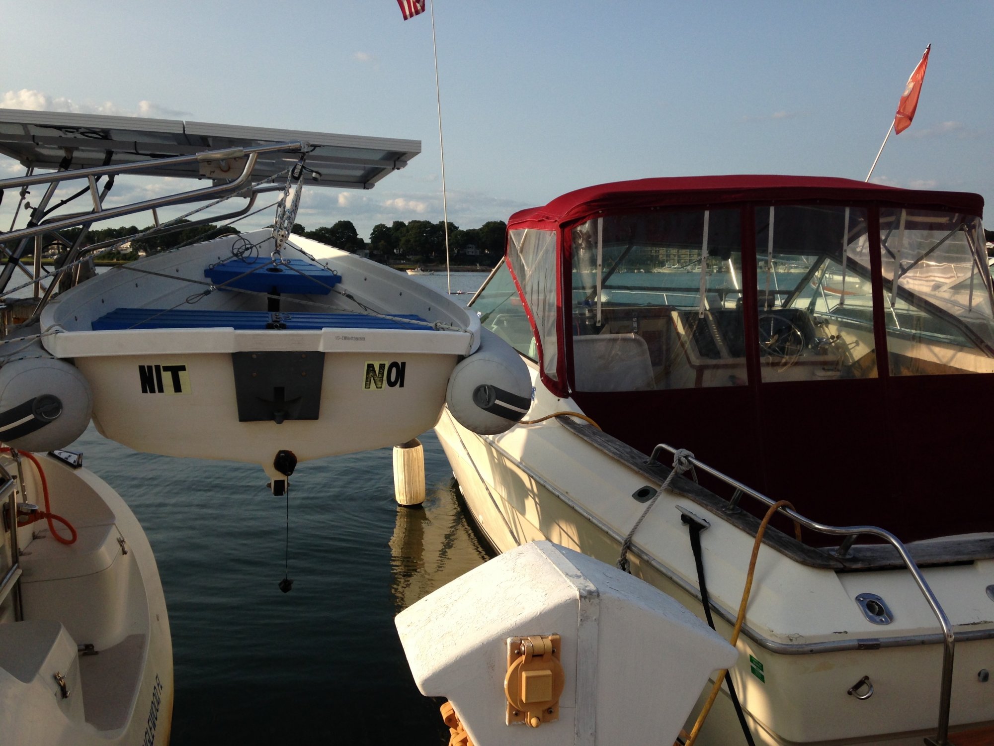

4. I'm trying to figure out an affordable way to keep my dinghy out of the water. Has any one use the type of davits that you glue to the boat, and clip to the transom? other recommendations?
I very much enjoyed having these davits on my boat (Martek, I believe). You might find the Snap Davits that attach to the transom to be useful.

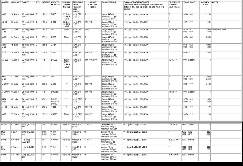

This is a cross reference chart I found some years back. Sorry it isn't sharper, I can't remember where I got it and I have looked for a better copy, but no luck.
This shows the M25XP as a Kubota Z-950 and the M25XPB as a D-1005E
When I
had that injector pump rebuilt, I gave him the D-1005E info and that worked out.
