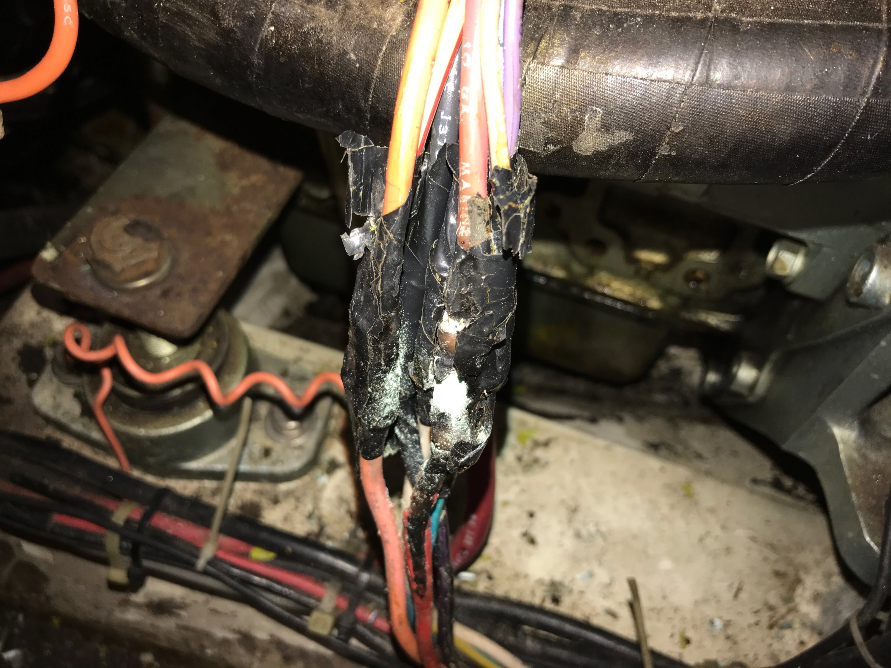

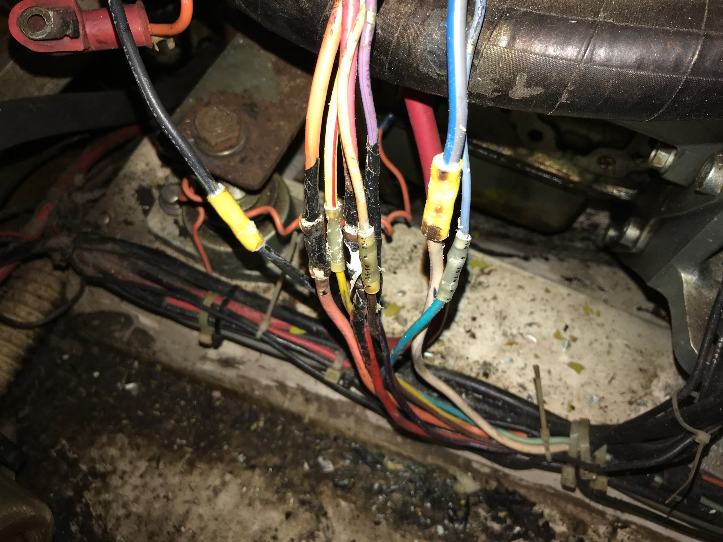

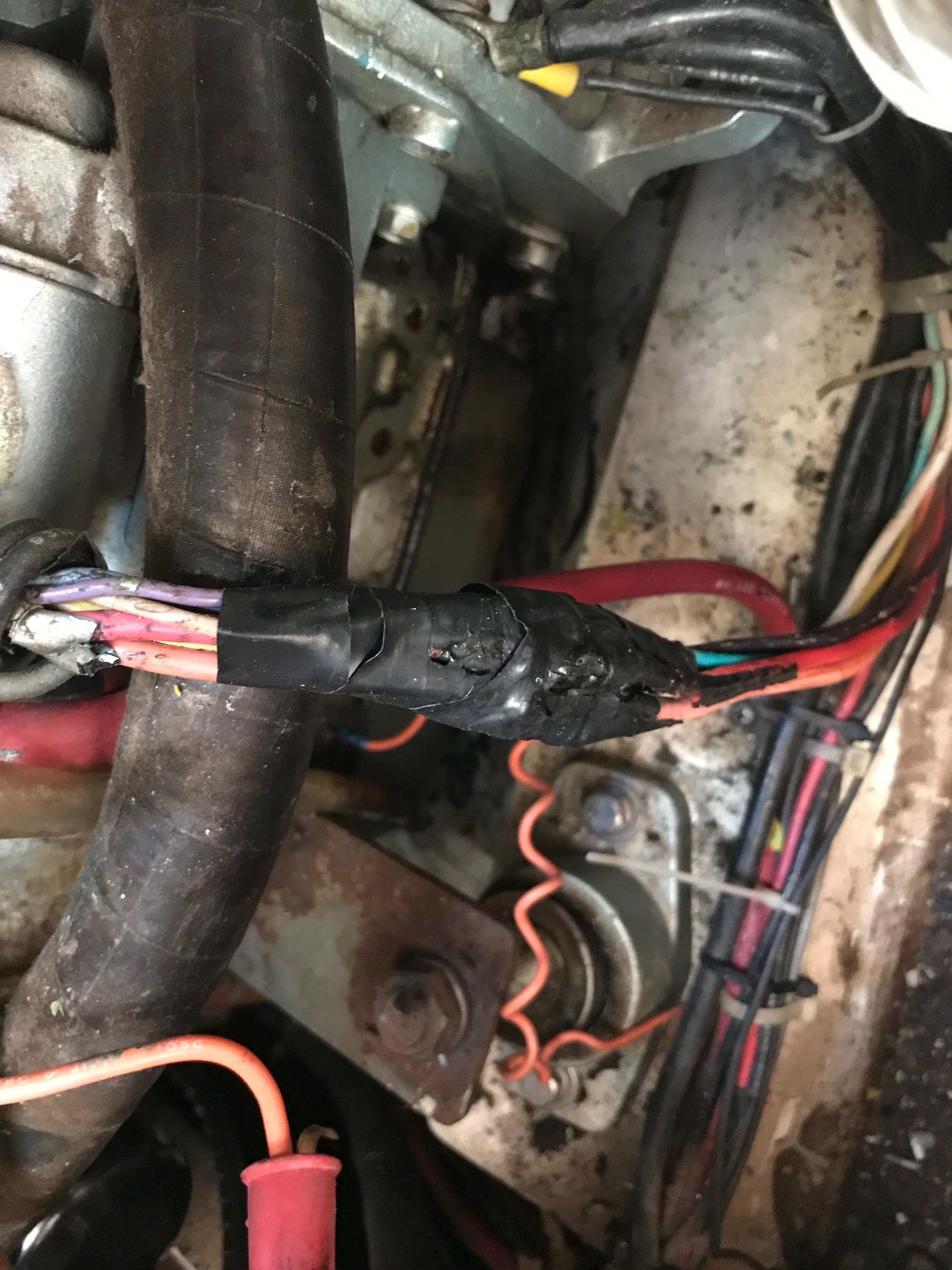

After I pulled the alternator I started to trace the orange 10 Ga wire. As I untaped and took off the plastic wire loom, I noticed a bump in the harness that was taped up. Uh-oh #1.
As I took off the tape I found it to be hard and brittle on the hump. Uh-oh #2.
When I opened up the harness it was Uh-oh #3.
Whoever removed the trailer plugs only went half way with the upgrade. Instead of running the alternator charging wire to the starter, they left it running to the engine panel then back forward.
Not sure if there is enough slack to cut out the bad sections and reconnect or if I will need to buy a new harness. One advantage to a new harness is I can install new terminal strips and use heat shrink rings instead of butt connectors.
Opinions on this?
As bad as these wires look, the motor started fine during the sea trial. I'm surprised because I thought the panel got it's power from the red wire whose connector is in the worse shape.
Good thing I enjoy electrical work.
In the photos below the orange 10 Ga is to the left of the yellow w/ red strip wire. The red 10 Ga wire is to the right of the yellow w/ red stripe wire.
Opinions on this?
It is rare that the wires go bad, as you said, it's the connections/connectors.

Yep, I've studied every one of Maine's articles that might pertain to my C30 and that one alerted me to the trailer plug issue. Which is why I was surprised the plugs were taken out but the alt was not wired to the starter.
The "deal" with the AO wire to starter is explained here:
OEM 1-2-B Switch Wiring History http://c34.org/bbs/index.php/topic,4949.msg30101.html#msg30101
The connections are discussed in detail in a series of different posts in our Critical Upgrades topic, which you most likely have seen: Critical Upgrades http://c34.org/bbs/index.php/topic,5078.0.html
Yes Stu, I've studied all the critical upgrades threads on the C34 site so I knew that I had to investigate where the alt charge wire went. When I'm done with my electrical upgrade the alt Bat+ will be connected to the house bank.
As I see it I have three options.
1. Cut out the bad sections and use butt connectors, which will end up closer to the engine/heat.
2. Install terminal strip and add new wire from terminal strip to engine. I doubt I can stay with the color code that way.
3. Buy the CD wire harness so I stay with the proper color code and wire size from engine through terminal strips to engine panel.
Leaning towards #3.
I had the pleasure of speaking with Maine Sail on Monday. He suggested I go with this option. He said the butt connections are just fine when done properly. I am also going with his idea of replacing the inline fuse near the starter on the start button/starter wire.
Don’t forget option 4 get the wire and build your own harness. I have two local places I can buy all the colors I need to build the bundle. If you use relays for the glow plugs and fan - it can all be #14
Les, I found all the wire colors and correct Ga at genuinedealz.com in 25' lengths. Costs would be about $60 less than the CD harness. If I decide to change out the harness, that is the way I will go.
Part of this repair will include adding the glow plug solenoid and another inline fuse on the red wire at the starter that feeds the panel.
I am already planning on running the alternator Bat + directly to the house bank.
What I won't do is tape up the bundle of butt connectors nice and tight, then put them in wire loom so they are well insulated. I believe that will trap any heat from any resistance in the connections. If done correctly with adhesive heat shrink connectors they should be fine in the open.
