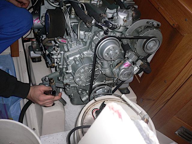

It is time for my first oil change after acquiring my boat in October. I do not find any posts that are specific enough to help me decide how to proceed. i know some use a pump and extract the oil via the dipstick, and i see in the owners manual that the tube leading from the oil pan to an attachment at the front of the engine is designed to empty the crankcase. What is the best method and best vacuum system to use for the uninitiated to this task?

PS Somewhere, a few months ago, I saw a pictorial article on this topic but for the life of me can not retrace my steps to locate it. (per attachment in case someone recognizes this photo)

If you have the tube coming from the bottom of the oil pan, using that option will allow you to remove more oil, especially from the bottom of the pan...which equals superior results. This is also a larger diameter tube that allows more flow and a quicker oil change. Run your engine a while to warm up the oil, take the nut off the top of the tube, attach your pump, and pump away. I easily get 4+ qts. out using the Jabsco hand pump, but there are many other types that are fancier and work well. Since I only have to do one oil change per year, I have never taken the time or effort to try another model...it works fine for me. Don't forget to change the oil filter. Best of luck.
23,137
Use the attached hose and
don't take it off because it has a crush washer on the engine side, a one-time use connector.
It's extremely difficult if not impossible to get the oil out using the tube without some kind of pump because it can't go down low enough to use gravity. So your choice is what type of pump. That's like asking what kind of anchor is best!:)
What we use is a Par Jabsco Handy Boy hand pump. I've built an attachment from the pump hose to the fitting at the end of the hose from the drain pan so that we can screw the two hoses together.
There are many commercially available 12 v pumps and oil drain collectors available, your boat your choice. Since there's so little oil to remove, we chose to pump manually - the time spent arranging the electrical connection for a 12 v pump we use to empty the oil.

Stu, I looked at the Handy boy but it seemed to only be for pumping out a sump. How do I pull the oil up into the pump? It appears to have several choices for output tubing sizes or can these be used for the intake side as well?

George, don't know what gives you that idea. Any pump can be used in a variety of applications. We bought the smaller Handy Boy, forget the specific name now, and not at home to check my boat inventory, but it's the smaller of the two or three models they make. It comes with a single sized outlet hose, and two sizes of intake hoses with an adapter for the smaller tube for using the oil dipstick and a larger hose for other uses. We use the larger hose, to which I attached a threaded fitting by use of a hose clamp - this fits into the female part of the engine hose fitting (once you remove the plug in that hose). Pretty simple. Does this explain it for you?

Gorndorff, I'm pretty handy when it comes to engines. But I have to tell you, I bought a cheap syphon pump that is designed like a syringe. It was terrible. I got oil all over the engine, all over the bilge, all over me.
I highly recommend the system that Stu talks about where you hose clamp to the dip stick. Also if you pump it into a container with a small mouth, it would help reduce any splatter. The biggest part of the problem I had was the cheap pump leaked at every joint while pumping hot oil. I will not do that again until I get a good pump.
By the way, is the engine in the picture the engine in your C30, or did you just use that pic to demonstrate your question?

The concept is to hose clamp a fitting onto the end of the pump's hose that fits into the fitting on the hose that is already connected to the bottom of the engine oil pan. This avoids the dip stick hole. Hermit's right about the small mouth receiver container. I agree that a quality pump is absolutely necessary. The Par Jabsco we have is a very good pump, it's a "Little Boy"as I now recall. A friend has one and uses it for transmission oil changes, too, which is a good idea for you as well. He also uses it to prime the raw water pump and "burp" the fresh water side.

Just to clarify, in #2 above, I am not recommending to take the fitting off of the bottom of the oil pan...I am recommending using the tube by taking the nut off the top of the tube and attaching your oil pump hose directly to that fitting. I was lucky enough to have some spare reinforced tubing that attaches tightly and allows me to pull a good suction and get no air in the line. I found that plain tubing would quickly "collapse" when a strong suction was applied and stop the flow of oil.
For what is worth, I pump about 20 stokes on the Jabsco pump extract all the oil.
