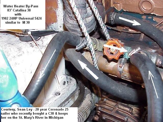

This isn't mine in the pic, but it looks exactly like this:
There's a pipe with connections for the engine coolant hoses and heater hoses on both ends. If the valve in the middle is closed, all of the coolant flow is forced through the water heater. This can lead to overheating. If that happens, you open the valve some, to allow some coolant to bypass the water heater, increasing the flow.
