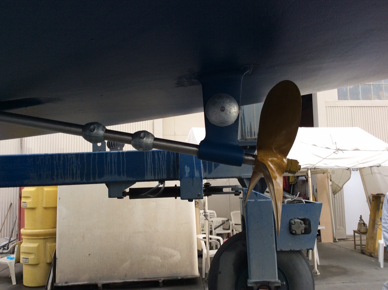

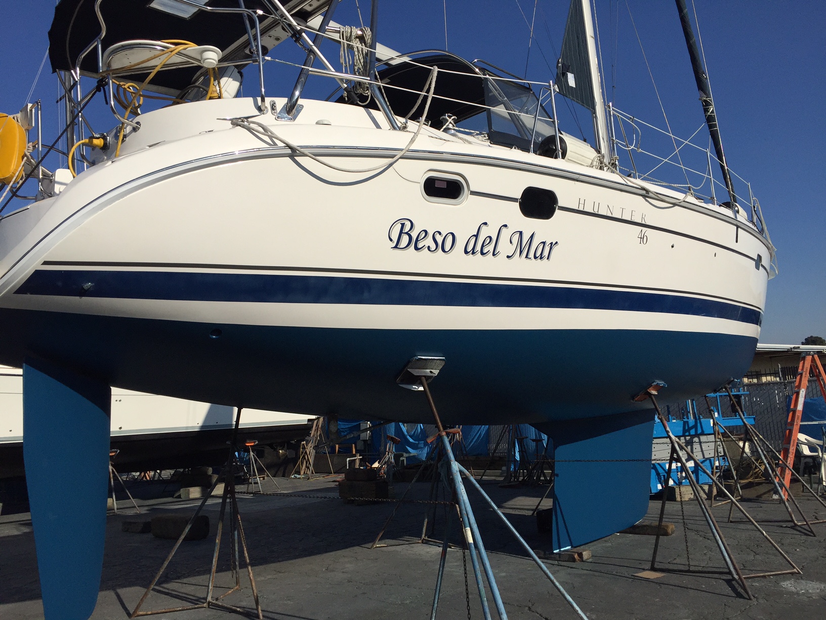

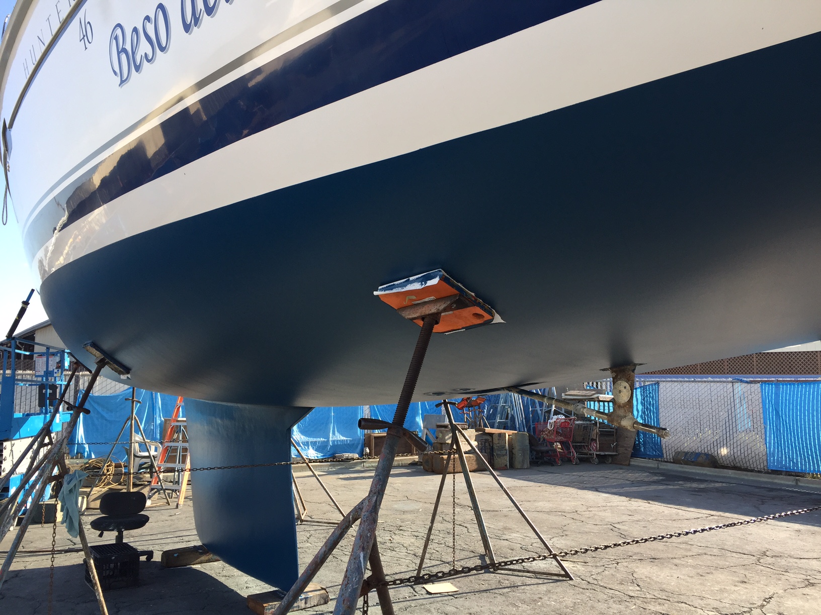

did they paint the through hulls too?...................
Through hulls were painted with anti foulant paint (photos attached). Also attached in a photo of the new prop after Prop Speed Primer and Prop Speed Clear Coat.
