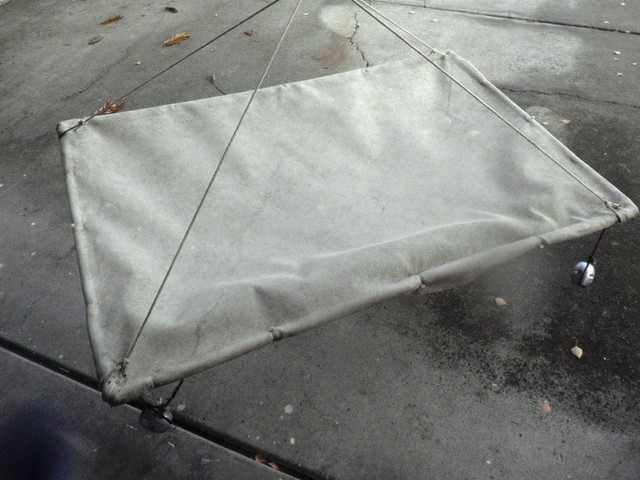

Knowing I would drop the screws and zerc fittings I grease mine on the hard with a tarp under it. Years back I dropped 1 screw onto the gravel and spent an hour removing one pebble at a time.
If I hadn't edited the video down (the actual job was a repitch of the prop), you'd have seen me lower this below the prop:
