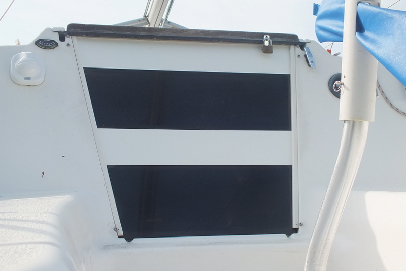

I've been having to drag out the cushions for the same reason. Without a cover, the rain seems to collect on the Plexiglas, forward of the wooden grab rail. If the rail isn't sealed, water drips through the screw holes. If it is sealed, water pools up against it and wicks under the starboard edge of the plexiglass and drips below. My GF suggested simply drilling holes in the grab rail to let the water out. That would definitely work, but it was cheap and way too easy, so I ordered the Ameriseam companionway cover from SBO. It's pretty awesome and I think it will do the trick, at least when the boat is moored. I stuck a square throwable cushion over the plexiglass to elevate the cover and provide some run-off. I'm hoping the pop-up canopy will keep out the rain when we're aboard.

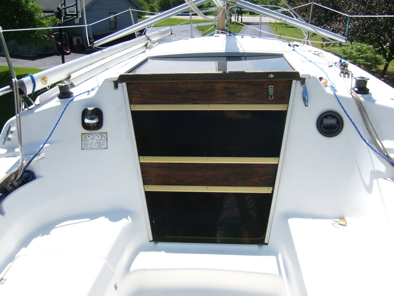

There are two strips of wood teak that run across the plexiglass slider. The first is the most obvious which is the handle. You need to remove and all screws clean or remove the old caulk. You can use alcohol on plexiglass but NEVER USE ACETONE ON PLEXIGLASS OR YOU WILL CRAZE IT. If asked if I ever used moonshine to clean plexiglass, well it was a darn good cleaner. Run a bead from one end of the handle to the other end and around the screw holes. Also coat the threads of all screws and reseal onto plexiglass. The second strip of wood is the brake which keeps the plexiglass in place from coming out which cannot be seen as it is under the slider and on top of the plexiglass. You will for safety need an extra pair of hands and remvove the plexiglass from the slider which is held in place with screws on the side of slider or fiberglass top of the companionway hatch. You will then see the second strip of wood and do the same. I would use a pure silicon architechual grade like the stuff you use on the windows is the best.

As for the Plexiglas, ours seams to have warped a tiny bit, so it doesn't seal perfectly against the rails it slides on. The Plexiglas offers a pretty good drip edge, but water does seem to wick under and drip in. We thought that adding a few weep holes might eliminate the pooling and allow the water to drip through into the cockpit (after landing on the hatch cover, probably). I would probably drill them as half circles and bed a short piece of 1/2" pvc (cut in half) to act as a liner. What do you think about this?

NO to that idea of drilling into the plexiglass. Creates more problems as I did that once/. YOu could put two boards or aluuminm strips long wise to try to straighten out the curvature of the Plexiglass with nut and bolt screwing in from the top which I did a few times but hard to describe here. The screw would have to be oval to slid under the fiberflass portion when coming out. gotta run to the dr. appt.

when its on the mooring bouy no water. I think its because when its on the bouy the boat faces the rain. The first wooden strip always needs to be sealed. Also velcro strips help the hatch slide and help with sealing the hatch.

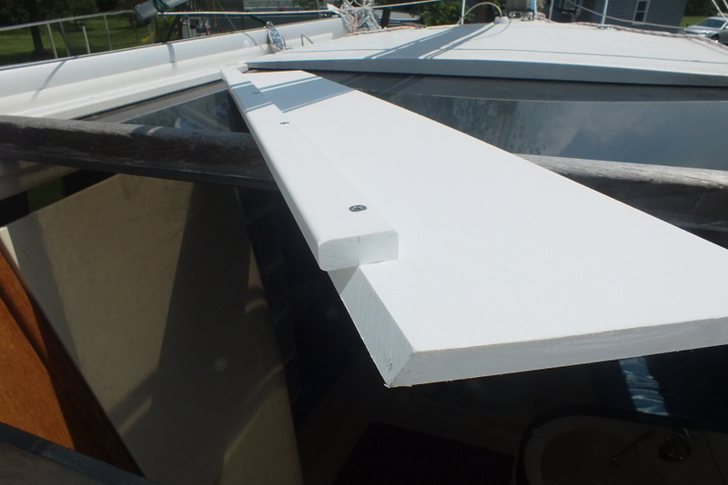

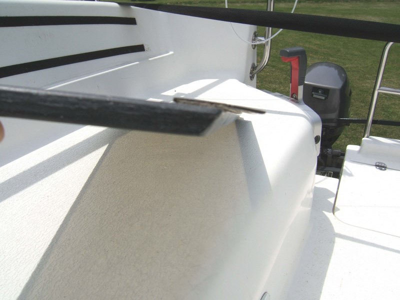

I've found that on my boat the water only came in through the hatch boards during a hard rain. The only time water comes in through the sea hood or the plexiglass top hatch is when I use the pressure washer, never from rain. The boards sit an angle and quite a bit of water seeps in at the joints. I first solved it by adding door threshold pieces and that worked quite nicely. Eventually I cut new pieces from HDPE because I got tired of trying to get the wood hatch board to stay nice looking . But when I did I found most of the angles to be a little off and the bottom piece didn't sit level because the fiberglass on the port side had a bump on it. I cut a relief in the bottom plexi, then made sure every piece was level as I put them in one at time or corrected it. One of the replaced wood pieces was way off because it was cut to fit the un-level plexi bottom piece. Once everything fit tight, I have no water coming in and I didn't need the threshold pieces, although I had the option of adding them again if needed. The last picture shows the white plastic board with the backer attached to lock it tight, not over the front to stop water. I would try the above, but first use a hose outside with someone inside to check and see where the water is coming in and then solve the problem
