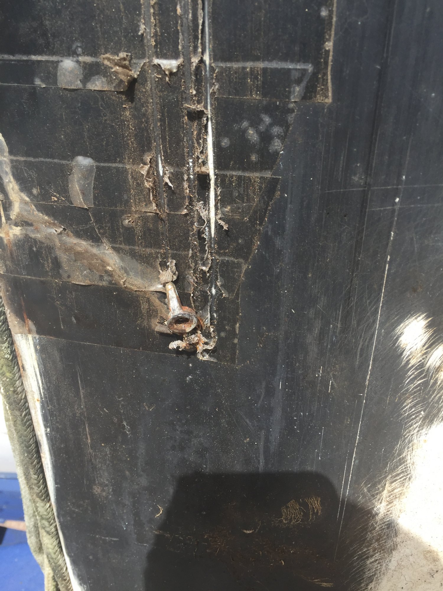

Been finally able to pull it out. But I have had a little surprise... There is a wingnut that must have felt in the daggerboard pit...
However, the daggerbord seems to be hollow with foam at the front and at the back only. I do have what I could figure out as draining holes at the complete bottom. I'll fix the wingnut hole for sure but should I open it and fill it up with foam inside? Thanks for your advices

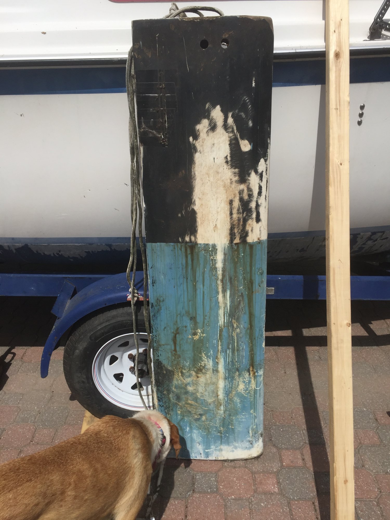

Wow, wasn’t expecting that. Any idea what the black stuff is on the top? Is that some type of tape under the black stuff? The black stuff looks like it may be ablative paint, but it’s on the part that is mostly out of the water.
The blue paint is on part of the boat that only gets seen by fish and divers. Seems like an odd thing to paint.
Welcome to the world of guessing what the PO (previous owner) did and why. I guess you usually know the “What” but the “why” is the bigger mystery.

However, the daggerbord seems to be hollow. with foam at the front and at the back only. I do have what I could figure as draining holes at the complete bottom. I'll fix the wingnut hole for sure but should I open it and filf it up with foam inside? Thanks for your advices
I don’t have first hand experience with this boat so do research BUT I believe the holes in the bottom and top with hollow centre let the board fill with water when it’s down. That keeps it from trying to float UP. The holes and hollow centre are there for some reason. Filling them up without knowing why they are there doesn’t sound like a good idea to me.
Cleaning the goop off and filling and fairing the outside seems like a good place to start.

Ken am I correct in thinking the holes and hollow centre are normal?

I believe the holes are normal and it is designed to allow water in and out depending on being raised or lowered. If you sealed it up, you would have to have some way other than gravity to get it down.
On our boat we had holes and I assume hollow center. It only weighed about 15 lbs (I'm guessing) but took a pretty good pull to pull it up out of the water. It was way easier once I mounted the block. The only downside was I had to remove the screws holding the block in place to completely remove the board.

MacGregor centerboards were known to have holes allowing water to fill the centerboards. Former dealer for them but long ago
