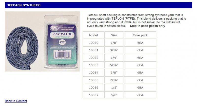

After talking to Charles, I believe he'll be contacting Western Pacific Trading to see if their synthetic yarn/teflon packing is graphite free. The material is called Tefpack and shown below. Will post the reply.
If graphite free, it may last even longer than simple flax/teflon packing.

I know this is an old post, but I’m trying to find out more concrete info about TefPack, and was curious if anyone from this post ever got a conclusive answer from Western Pacific as to whether it contains graphite or not?
I would call them myself, but it appears they’re temporarily closed due to the Coronavirus situation.
thanks so much!
-Paul

I haven't been able to find any info from WPT lately. A few years ago they had an excellent web site but that seems to have disappeared.
May 11, 2020
9
Sabre 42 CB Winterport/Benjamin River, ME
That’s too bad. I feel like the stuff must have graphite in it, based on appearance, but I wish I knew for sure! I got a package of that and a package of the basic PTFE flax. I’m thinking I’ll use the flax to be safe, but guess I need to get some syntef lube as well?
