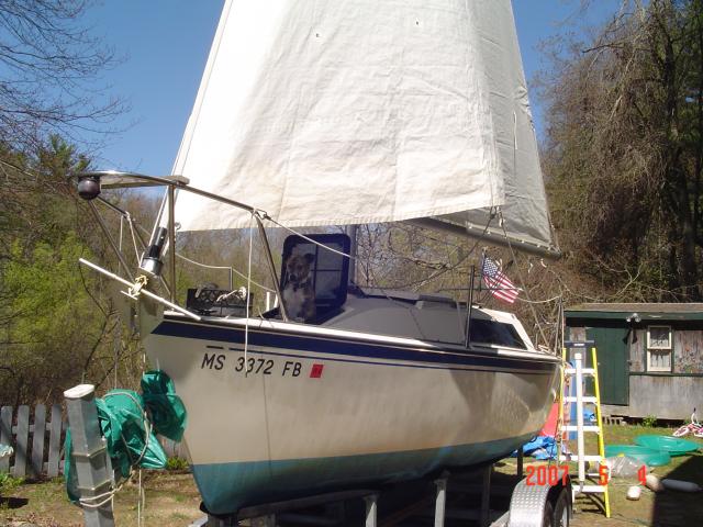

Are you referring to the bail under your boom that your mainsheet is attached to? You may be able to just rivet it back on again.

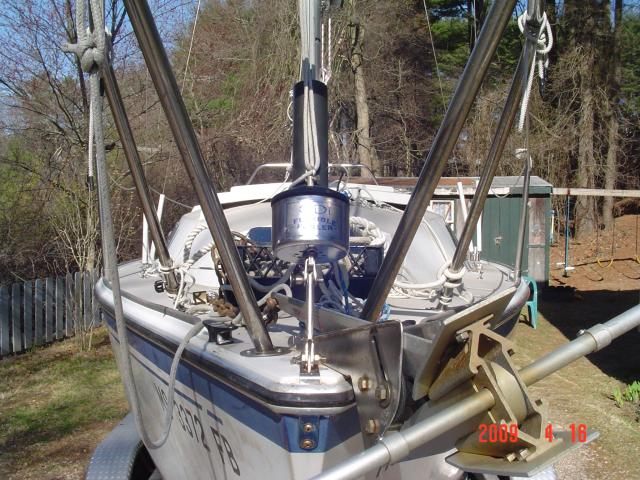

As for the roller furler; I have a CDI Roller Reefing Furler on my boat and I love it. The whole thing including the sail refit can cost about $8 or $900. It really depends on whether you want to have your sail converted or buy a furler and have them make the sail for it. Make sure you have a UV shield sewn to it. Without the shield, the sail will only last about three seasons. Check out Sail-Rite for info and pricing. I bought a CDI FF-2 without the ball bearings. The drum on mine spins on a large washer and that's all that is needed on a boat the size of mine according to Rudy at D & R Marine where I bought it. I think that I paid about $390.00 for my furler when I bought it a few years ago. I had my Gennie converted to fit it by a sail maker in Bristol RI. I love my furler. You can't beat them. I installed it myself with the help of a friend and I have the drum mounted about 5" higher so that it doesn't interfere with my bow anchor roller.
