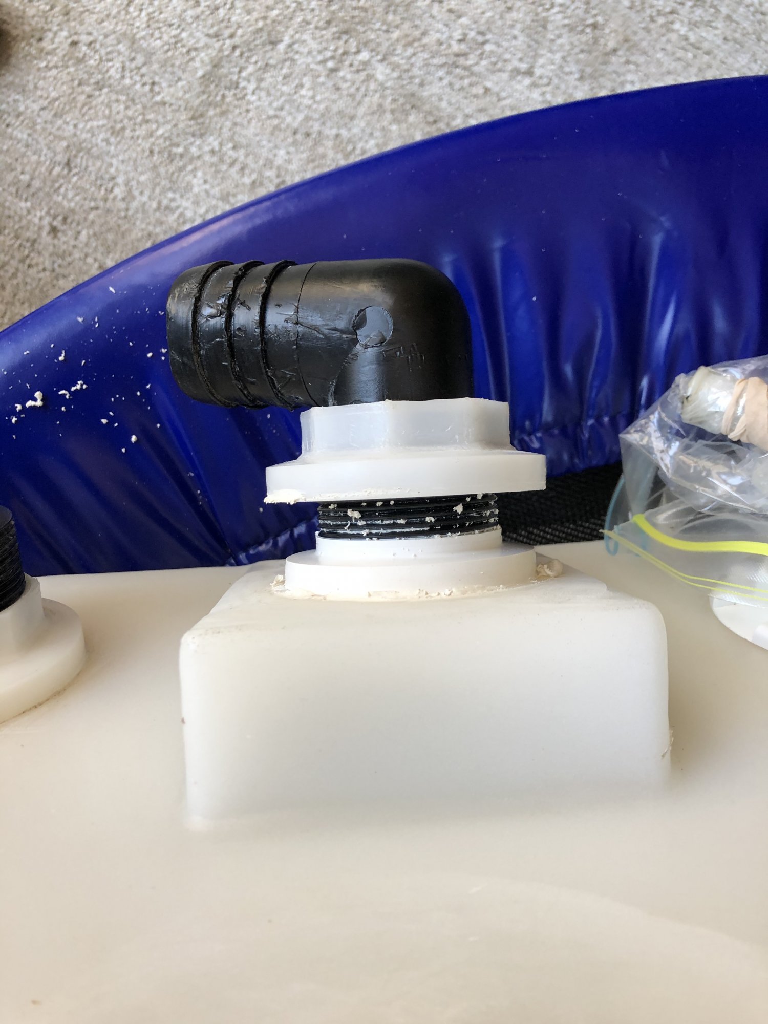

So I am converting my aft holding tank to gravity fed. In doing this I would like to re-orient a 90 degree fitting on the top of the tank to get a better angle for new deck pump-out. I don't see any sealant or glue but the thing won't budge..... applied pressure, but didn't want to just break it so waiting till I have a bit more info. Its 15 years in the same position... maybe heat it up? Some 5200 remover down the threads? I was going to start with heat.

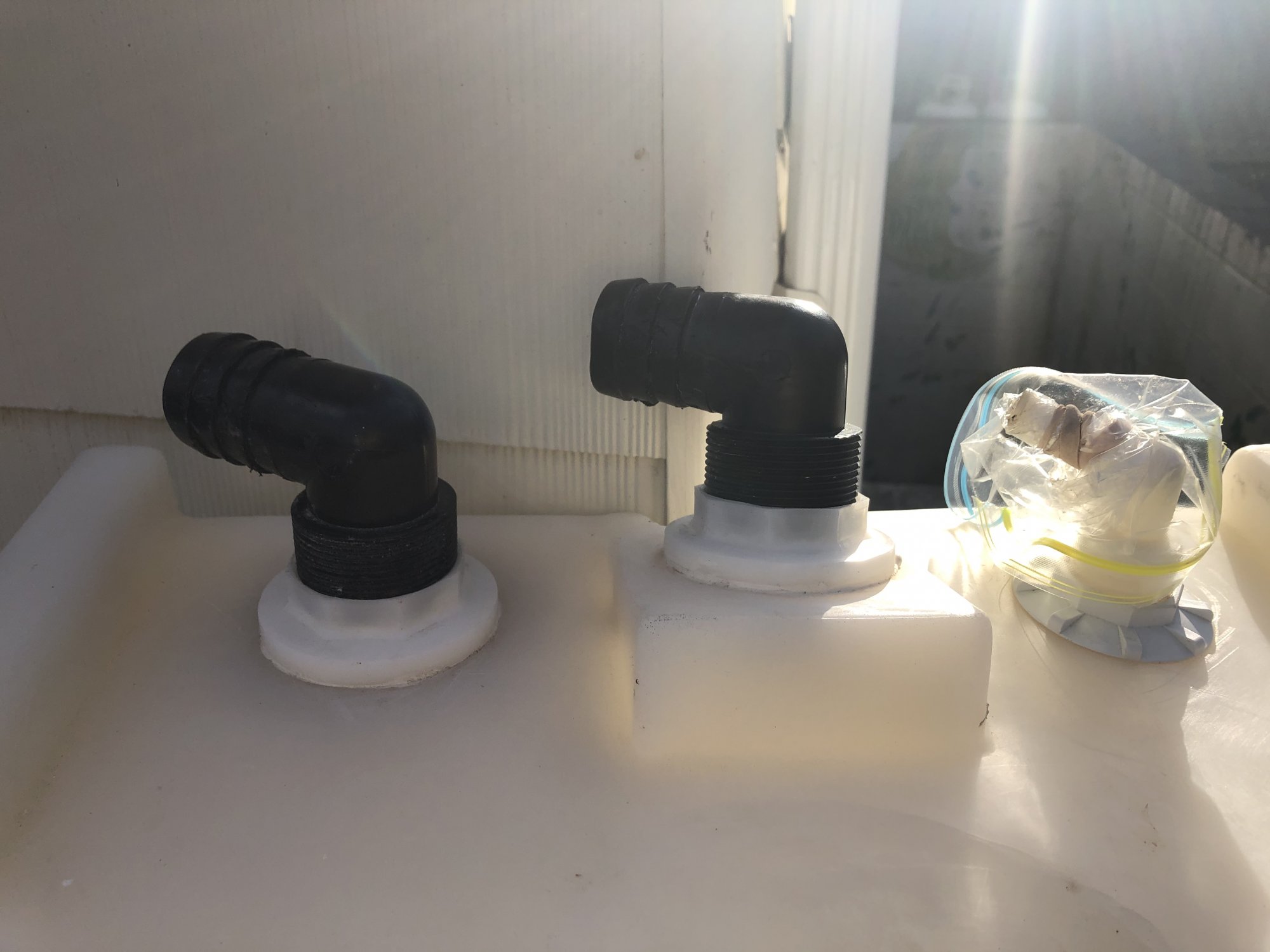

Its a male threaded 90 degree fitting going into female tank fitting. I was hoping just Teflon tape.... but it didn't budge and so far I have found beneteau does some crazy things..... I'll start with a bit of heat to soften things up and gently twist! Just need to move about a quarter turn, but if it starts moving will remove, clean, re-tape and insert to new position.

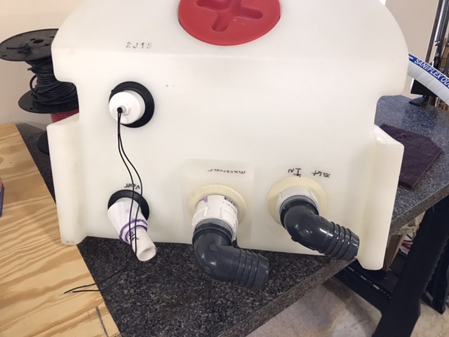

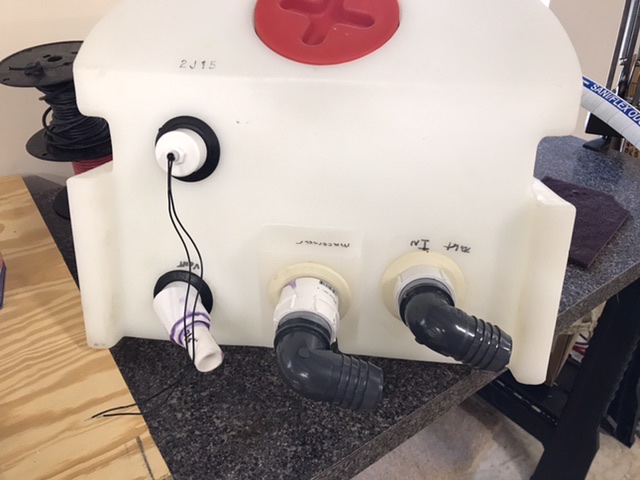

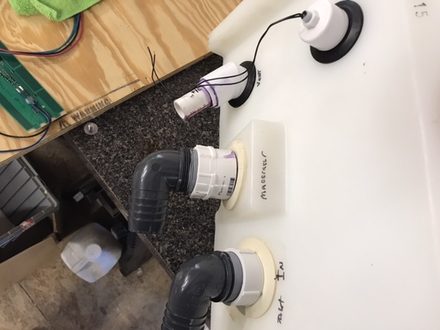

You don’t have to plug it, just open the existing to fit a uniseal. I tried to turn mine and couldn’t. It,s a bulkhead fitting that Beneteau used a permanent adhesive. I broke the seal trying to turn it. i made a wooden plug with a lip to fit the existing hole to guide the hole saw. I also found the pvc pipe attached to the fitting had fallen off which explains why my macerator didn’t work.

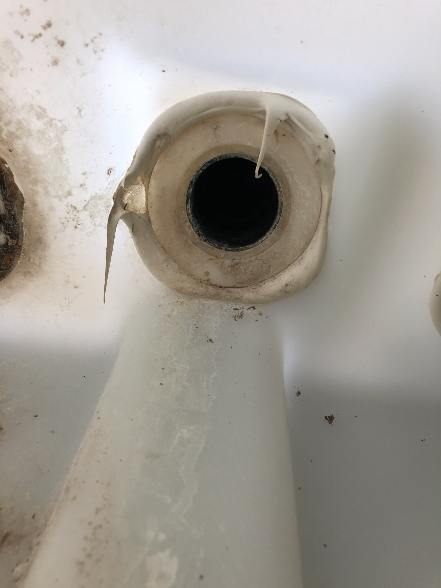

So yes I added a bit of heat and the only thing that turned was the top “retaining nut”. As bob said the fitting appears to have been put in place with adhesive with the pick up tube actually sliding into the fitting. And yes bob the glue failed on my front tank and was just about done on this tank..... came right off. I think what I will do is 1-clean and re-glue pick up tube as I did on front tank and 2- live with and work around the current position of the fitting. It’s not perfect but I tried..... if there are any hiccups I will go the uniseal route. So bob when you added the uniseal do you now have a similar set up with a fitting on top and tube below??

First picture is inside tank.... pick up tube slides into “black sleeve” which is the fitting itself.

Wow... thanks for the photos. So you removed current fitting got uniseal and inserted.... guess you had to attach new pick-up, then added the 90 degree fitting. Looks nice. Not trying to leach off all your hard work but..... you wouldn't have the part number handy for uniseal and fitting would you??
It will make it so much cleaner with less hose by moving fitting.
