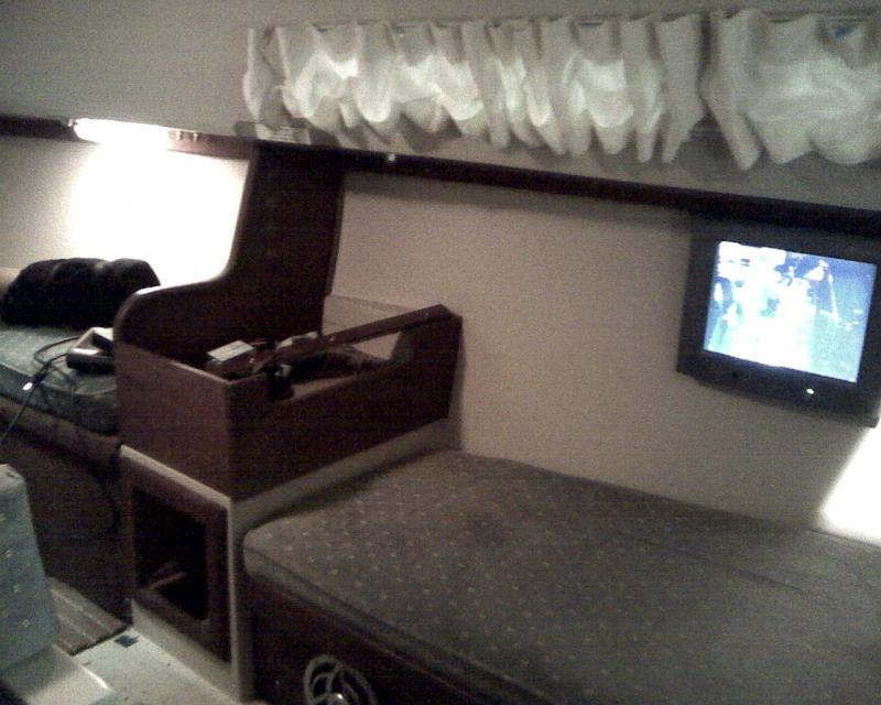

For the C-22, I find that a good mounting location is to starboard above the settee.. See TV install pic of my old '87 C-22 with a 12" TV for size considerations.
BTW, were it me, I would not go bigger than a 15" TV on a C-22.

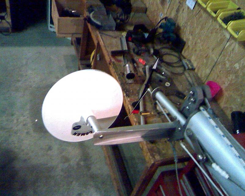

In all of this, if you want terrestrial TV, consider installing an amplified omni-directional UHF antenna at the top of the stick... Here is the Glomex antenna I had on the C-22 showing the custom bracket, (this is lying horizontal in my shop).
You may find you are close enough to the broadcast antennas that a set-top or more simple antenna will suffice, but I am 50+ miles away from the TV stations, so on top of the stick was a must.
