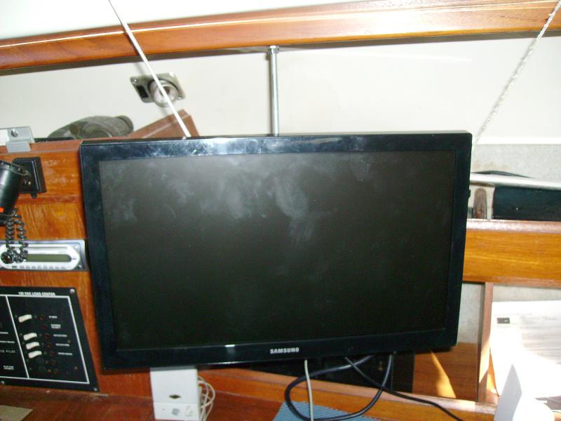

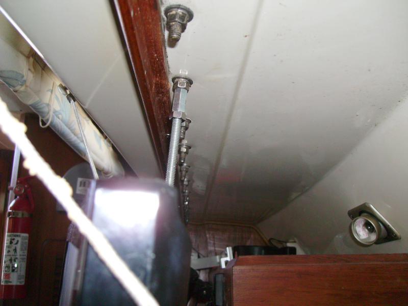

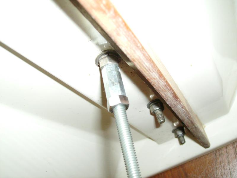

Last year I tightened the nuts on the bolts from the jibsheet-car track and thought I should make them more useful. So I used coupling nuts and threaded rod to make a mount for the TV and to hang a shelf for the galley.
