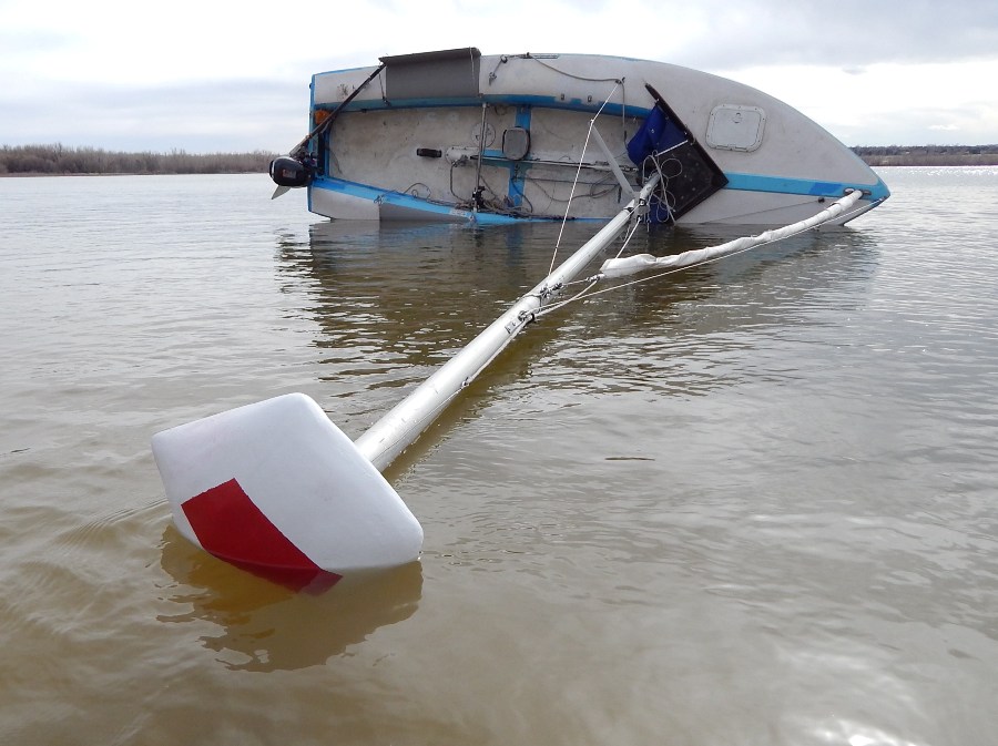

Internal mast floatation isnt always enough to keep the mast from sinking plus you want a little reserve for high winds, waves and the initial impact from the capsize. You may also need an external float at the top of the mast.
Easy to test on a small boat.. the picture below is a test in no wind. When I did capsize this boat, I could not see the float (very high winds at the time) but the float and mast floation made it fairly easy to upright the boat. Float has saved me from needing a rescue several times but I also look like Im out sailing with training wheels.. lol
