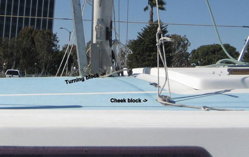

You could use deck mounted turning blocks and cheek blocks, but this is much sexier.

You could use deck mounted turning blocks and cheek blocks, but deck plate is much sexier. The organizer plate is not that expensive.

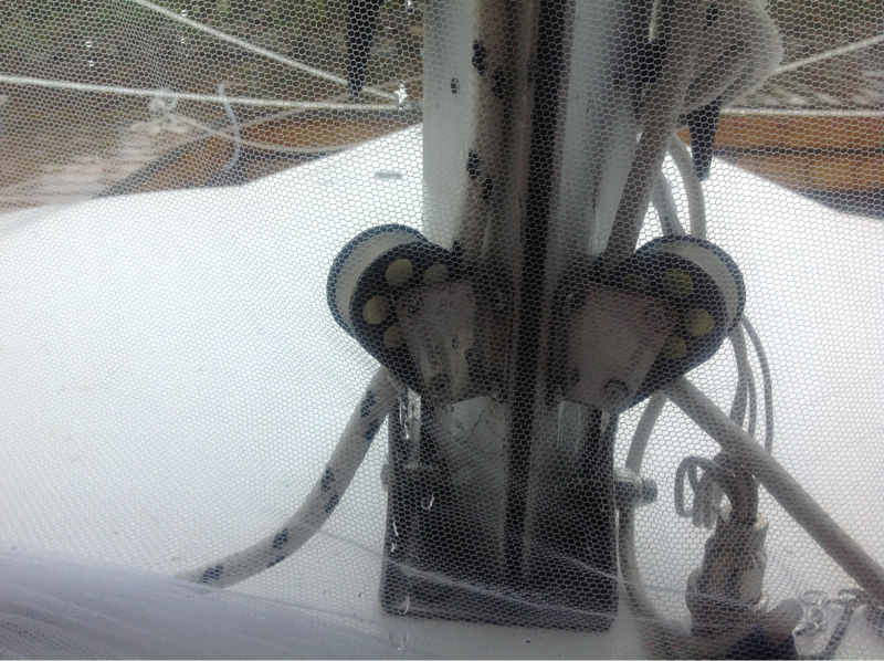

Or use halyard turning blocks. They mount on the mast and stay on the mast, so no line threading plus they don't jamb or rattle when the line is not under tension. No backing required like deck mounted blocks (or holes in deck).

Hey Chris, that is something like what I had in mind. I like that. I think I'll take another look at modifying the plate that I have. As well as the Halyard turning blocks you mention. I considered the deck mounted blocks, but can see several downsides to them as you mention a couple.

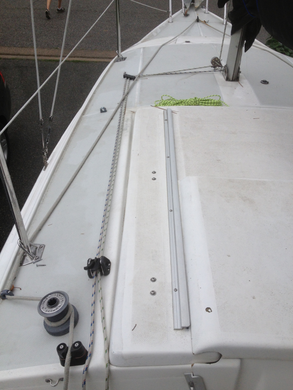

I swiped the plate of my old boat before I junked it. This was before I put the plate on.
I then put a deck organizer and a set of clutches in. In hindsight I should have brought the organizer aft a little rather than have it at a 90 degree angle but the holes are punched now.

My '94 26S has a 2-up version of that mounted on the deck leading to starboard at about a 30 degree angle to a double organizer then to a double line clutch.

If you add halyard turning blocks to the mast, be sure the fleet angle is as close to zero as you can reasonably get. If you have to mount it/them on the curved part of the mast, use the split footed type like that in Chris' (holdech) pic. You can gently bend the feet to conform to the curve in the mast. Or use a hinged unit, but they're much more money for the same series block, and not necessary IMO, as they're really intended to handle changes in line direction, whereas a halyard always follows the same line.
