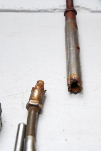

BobM
Jun 10, 2004
3,269
S2 9.2A Winthrop, MA
Mainesail posted this on another site. Now, I'll be the first to admit that the S2 turnbuckles are darn beefy compared to this and that this one is quite rusty, so perhaps concern of water retention / corrosion is minimal for the 9.2A. However, I can personally confirm that galling led to the yard turning a double kink into my back stay (because the turnbuckle wouldn't rotate) and a $200 back stay replacement I hadn't planned on. At least be sure to clean and lubricate.
