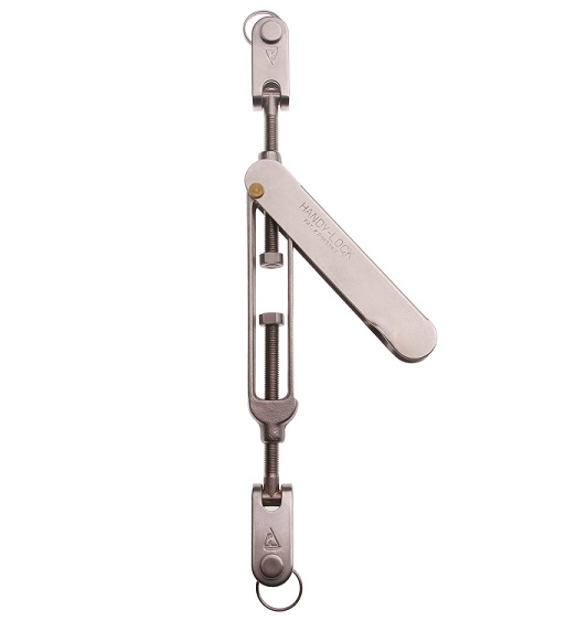

C.S Johnson Handy Lock Turnbuckle
"The 01 Series Handy Lock turnbuckle is one of our oldest products and still stands the test of time. Neat and compact and positively locked without cotter pins or check nuts, the Handy Lock has all the features needed for easy adjustment in a compact package. There are no sharp points to catch lines or tear sails, just flip the lever up to adjust and down to lock. Use the Handy Lock anywhere an easily adjusted turnbuckle is needed."

@jviss are those easy to install?
im not with my boat right now so I can’t see how the turnbuckles attach to the shrouds and back stay.
nevermind . . . Just looked it up, it looks stupid easy to install.
thanks!

They come with a variety of ends on them. Only thing, they are expensive.

I used them on my Hobie 16' . They are the cat's butt . I need to loosen my shrouds to raise or lower the mast .

THere's a few variations on what @jviss posted but these things are invaluable for a trailer sailor. Well worth the $70 or so. I can't imagine trailering a sailboat without it. I had one on my forestay, quick disconnect (PTO) pin on the backstay and would leave the sidestays connected all the time. An electric winch for stepping the mast was probably the biggest upgrade

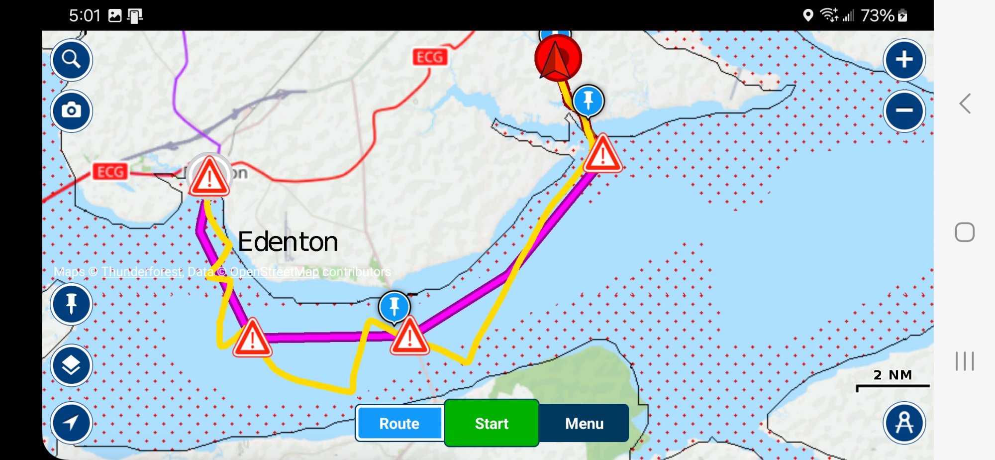

I don't know what you want to call it. I was sailing 13nm to windward solo in my 19ft Mariner in 15 knot winds with full sail - the forecast had been for 7-9 knots. The ENE wind had full fetch of Albemarle Sound, so I was in 4ft seas. I was not too sure of heaving too and trying to reef in those seas (and losing all that ground to windward in the process). Tacking angles were worse than I would have liked. So I was trying to figure out what I could do to make the distance to windward more efficiently in the conditions I had.
Jib halyard had stretched slightly, the forestay was sagging a little less, so had slight scallops in the jib leading edge. Strapped the jib in hard, eased the main slightly (no traveler on a Mariner) so the front 1/3 of the main was bubbling, and pinched as close I could while maintaining boat speed (4.2 - 4.6 kts on GPS) and the jib full. Settled into the best groove I could.
