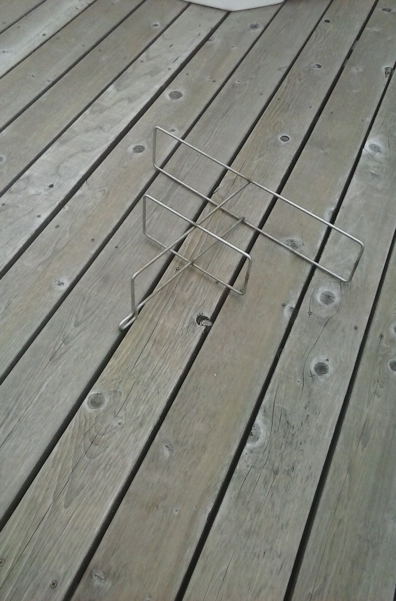

Jan 27, 2008
3,092
ODay 35 Beaufort, NC
Yes. It is used to hold a horseshoe throwable life preserver. You mount it on your stern pulpit and use a couple stainless hose clamps to hold it in place.
Mar 26, 2016
45
oday 27 newport, or
IAMCCF, I was totally posting from my phone and clicked the wrong thread. Sorry for hijacking. Everyone else, thanks for the info!
