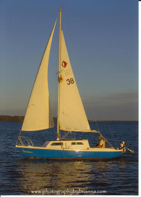

In preping to tune my rig in a few weeks, I am doing some reading, and looking at pictures of my rig. (see pic) I have a masthead rig (forestay) with a set of uppers that go to the FORWARD chainplates, a single set of lowers that go to the AFT set of chainplates, and a single backstay. All have turnbuckles for adjustment. As I read various tuning guides I always come to the point about tuning in about an inch of mast prebend, but it would seem that with my set up, the uppers and lowers may have been reversed by the PO. The way I look at the angles created by my uppers and lowers, there does not appear to be any way to induce prebend. The uppers are inline transversly with the mast base, and the lowers are aft of the transverse position. If I tighten the lowers the mid mast would move back, to create reverse bend! I can't see how tightening the uppers would induce the top back, even with the lowers looser. Is it possible that they have been reversed on the chainplates? If any of you are near your boat, or have a picture of a similar sized and rig set up as my boat, check it and tell me if your lowers go to the forward or aft chainplates.
