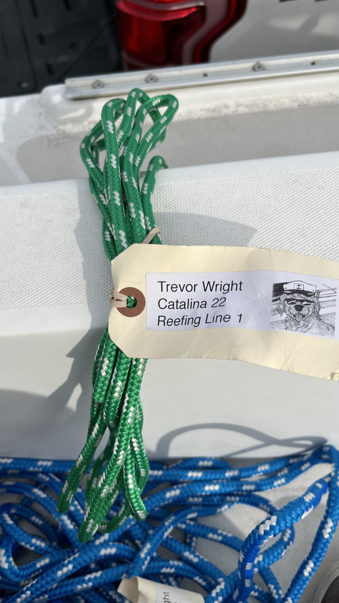

I am doing an inventory of all the lines I inherited and would like to identify the vendor where these were purchased. Does anybody recognize this logo and tag?

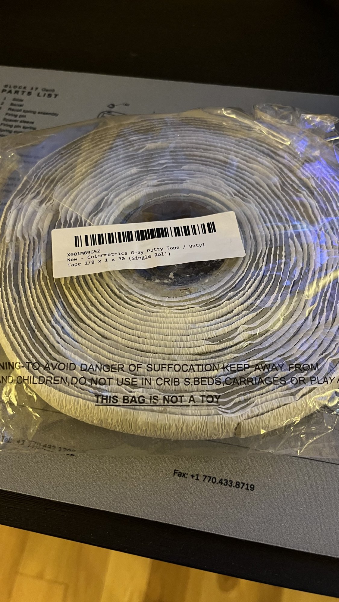

I have a roll of butyl tape that might work
