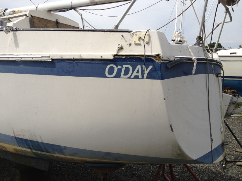

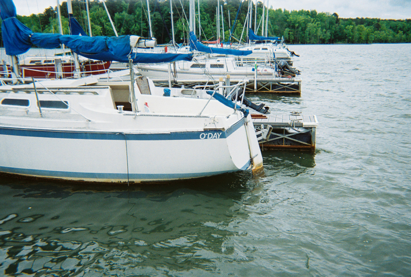

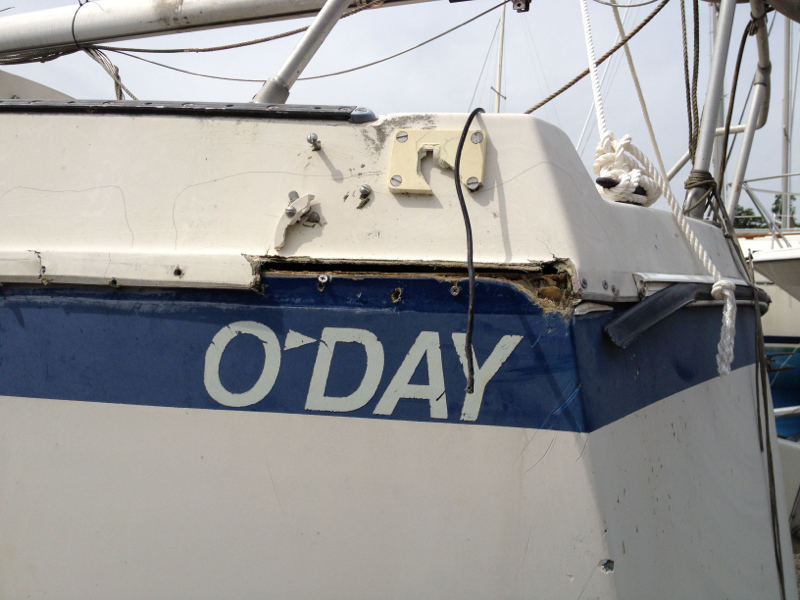

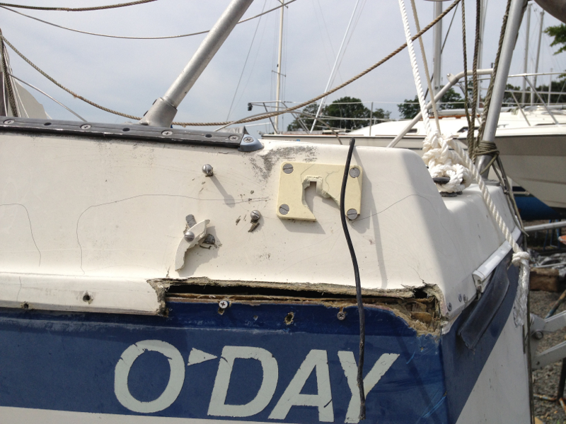

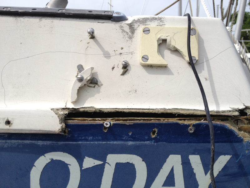

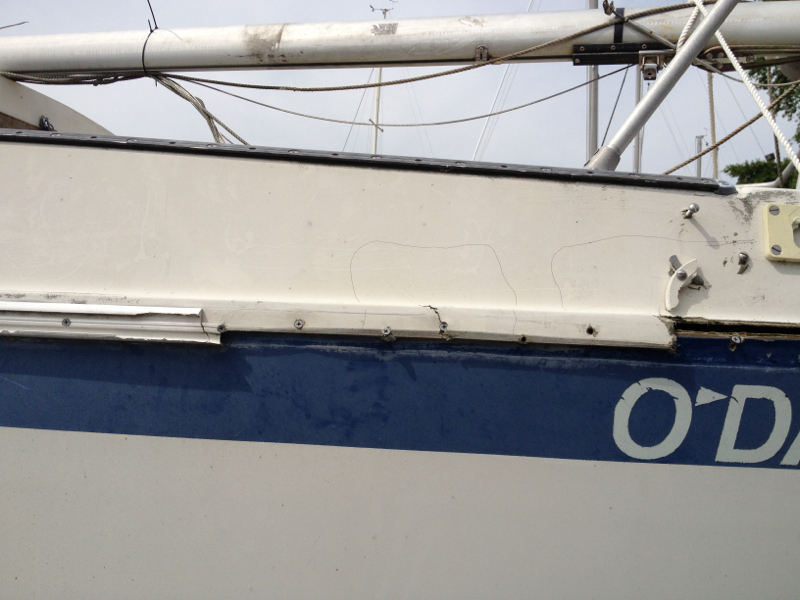

I figure I'd put the Question to the Group I have a 1979 O'Day 25" I was wondering if I should Attempt a repair myself or leave it to the expert I have included some pics (both up-close and from far) I have little experience with fiberglass repair.I got a quote from the yard guy for about $1800 which I feel is way too much

Concur- $150 on the outside - you will learn things you really should know too! FG work is fun, and creative! Finding the piece of rubrail will be the hardest part of the whole job.
Find a book: "This Old Boat" by Don Casey. Will explain everything, in great detail.

Rudy at D&R Marine has that rub rail and the insert. Nasty hit. I too would try to fix it myself rather than spend that much money on the repair.

The quote is reasonable especially if you are looking for a "perfect" repair and have the new gelcoat match the remaining.
With that said, if you have time and patience AND are a hands-on type of person, you will do well with repairing it yourself. Epoxy systems are well defined and straight forward to use. You can also grind out the repair and start over if needed. Applying gelcoat is akin to spray painting. There is skill involved in making it look "perfect", but it is doable. The rub rail is available at D&R Marine.
Do an initial repair to keep the boat sailing for the season. Do the permanent repair at the end of the season.

Unless you are experienced with fiberglass repair, the end result will look like crap. $1800 is very reasonable. And BTW, you would NOT use epoxy here!!!

The torn fiberglass needs to be repaired. Unless you know of something magical, epoxy is the best repair material for torn or damaged fiberglass. In this repair I would expect that a sprayed gel coat would be the best finish to cover the epoxy.

Hey, it's already broken. What's the worst that can happen if you repair it yourself?
Search for Nate Bayreuther's rubrail repair on his O'day Mariner, Orion. He had this same damage exactly. I believe the pics are on the Mariner Association website, but Google will tell you for sure.

Gelcoat does not really do too well with epoxy- it tends not to dry, or when it does, it will soften the epoxy underneath, while being firmer on top.
You can put epoxy on poly, but not poly on epoxy.

A couple of years ago I had to repair my forward hatch after the wind caught it (my other half claims it was dogged down, but that's another story). Anyway, I jumped in and gave it a shot which was a very gratifying learning experience. Although your job is somewhat bigger, many of the concepts are the same. Built up the damaged area with West System resin and fiberglass cloth, then applied gelcoat with a Preval sprayer ($5 at many locations). The gelcoat was then wet sanded with decreasing grit count, followed by buffing it out with compound. Couldn't have been happier with the final result. If you're not averse to tinkering, then I would encourage you to go for it.
