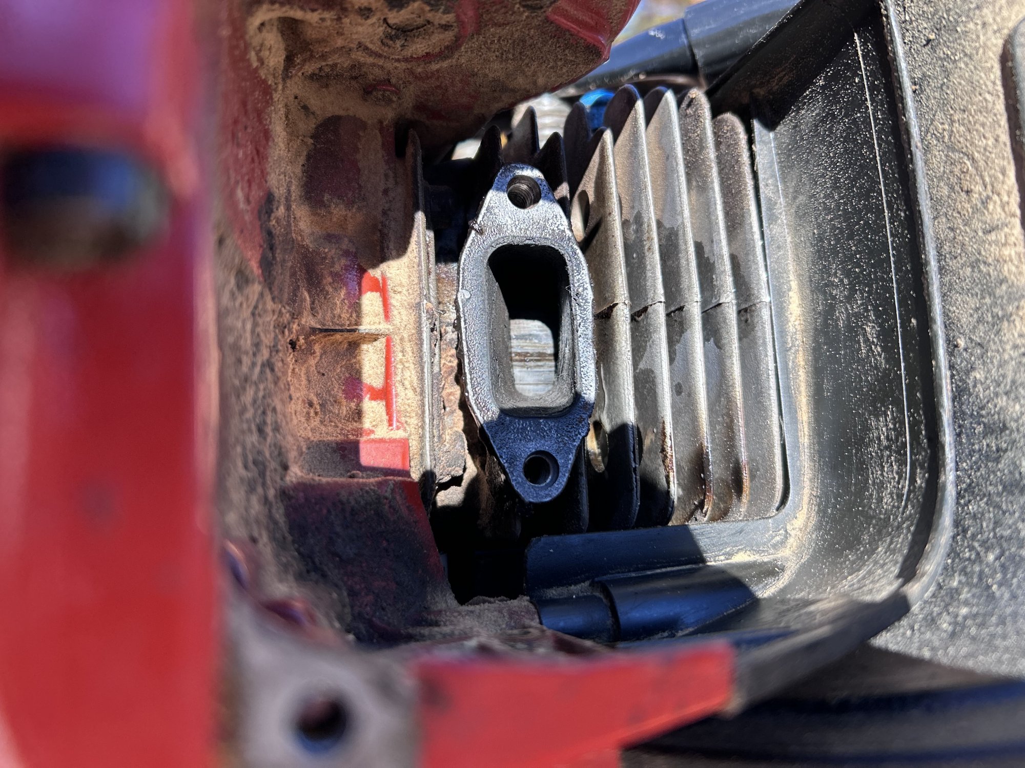

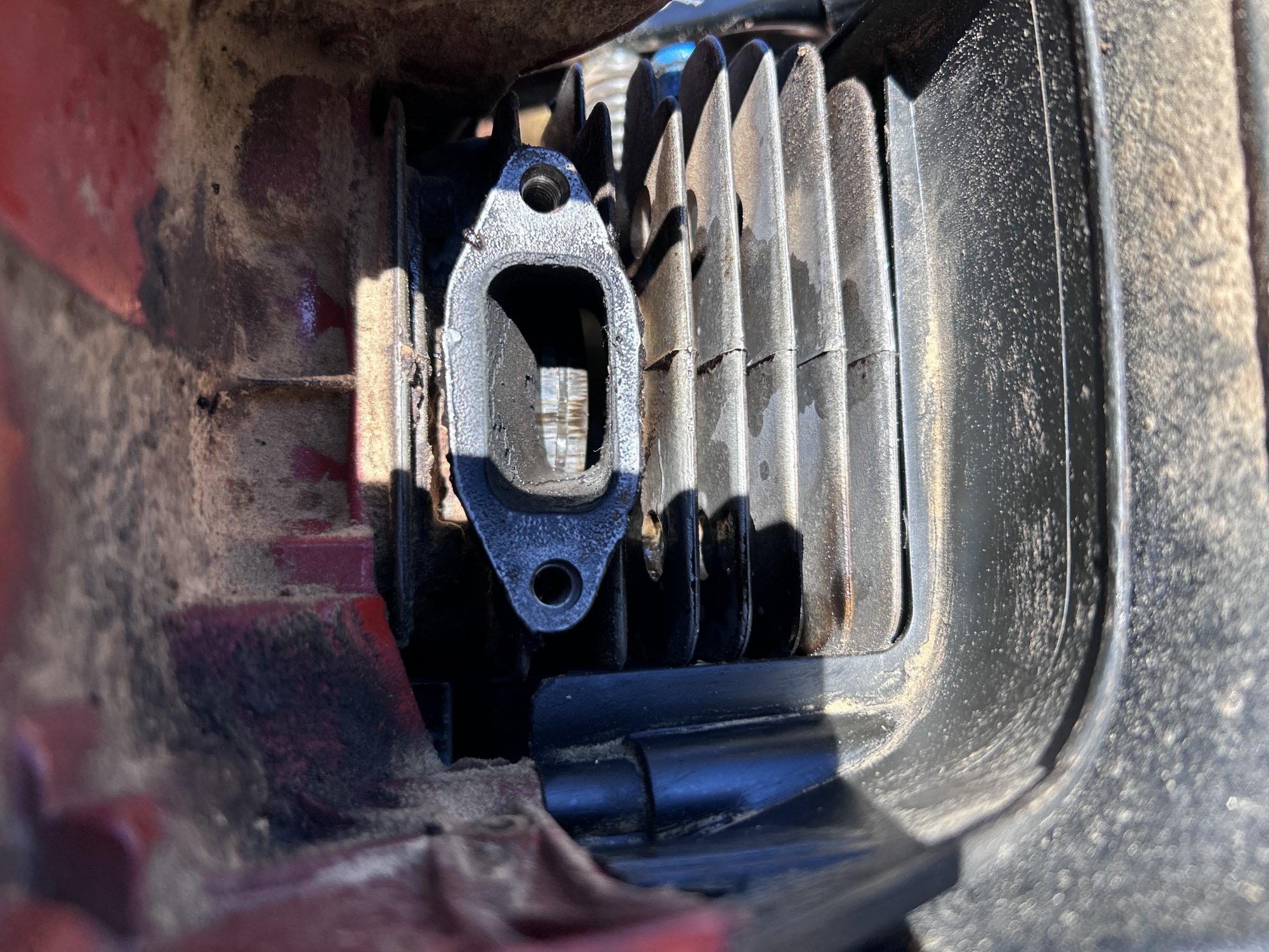

Hi all,
I have had an issue with my chainsaw (two cycle engine) not starting and got the local service shop to look at it. He asked me how old the fuel was and I replied that I had been using TruFuel and would run it out by the end of the season. He asked if I kept the can for the following year which of course I always have a can around. He said that most people don’t know that TruFuel has a limited shelf life once it’s open. He kept talking but my mind was already racing ahead to the number of two and four cycle engines I own and my personal best practice for the end of the season, including boat motors.
Back home I got online and there’s info about the shelf life being five years if unopened and two years once it is opened. I also watched some uTube videos on where to find that date. I checked my cans and found one full can dated July of 24. The other was April of 25. I bought them in June of this year after using my previous supply which ran the saw every day during May and June that wasn’t raining. (about two gallons of TruFuel) I didn’t run it completely dry but I could see a little fuel in the saw when I filled it earlier this week. My best practice ruined my 25+ year old saw. Now I’m staring at my outboard and wondering if it might have already been trashed as well since I haven’t had it in the water for two years.
So I hope you all can avoid this experience and improve your best practices.
Tom

OK, I read some replies and got my jaw clenched and went back to the garage. I saw the black line on the cylinder and thought “there’s the score. I rotated the cylinder away from the plug and shot some Fogging oil into the block. I left it for a while to go to the local dump which to my surprise took my old flares. Coming back with new energy, I took the air filter off and added a teaspoon of fuel by the butterfly valve. Two pulls and it sputtered. So I added another squirt and the saw started. I don’t know why it didn’t start three days earlier, but there it was. Glad I didn’t make a scene at the local home center about their fuel. I did have to go there for long Allen wrenches since mine couldn’t mount the muffler on the block.
Sometimes life throws you a cherry. I learned a lot about checking out what I buy. Three trees to cut up to fit in the stove.
Thanks for the replies.
Tom
