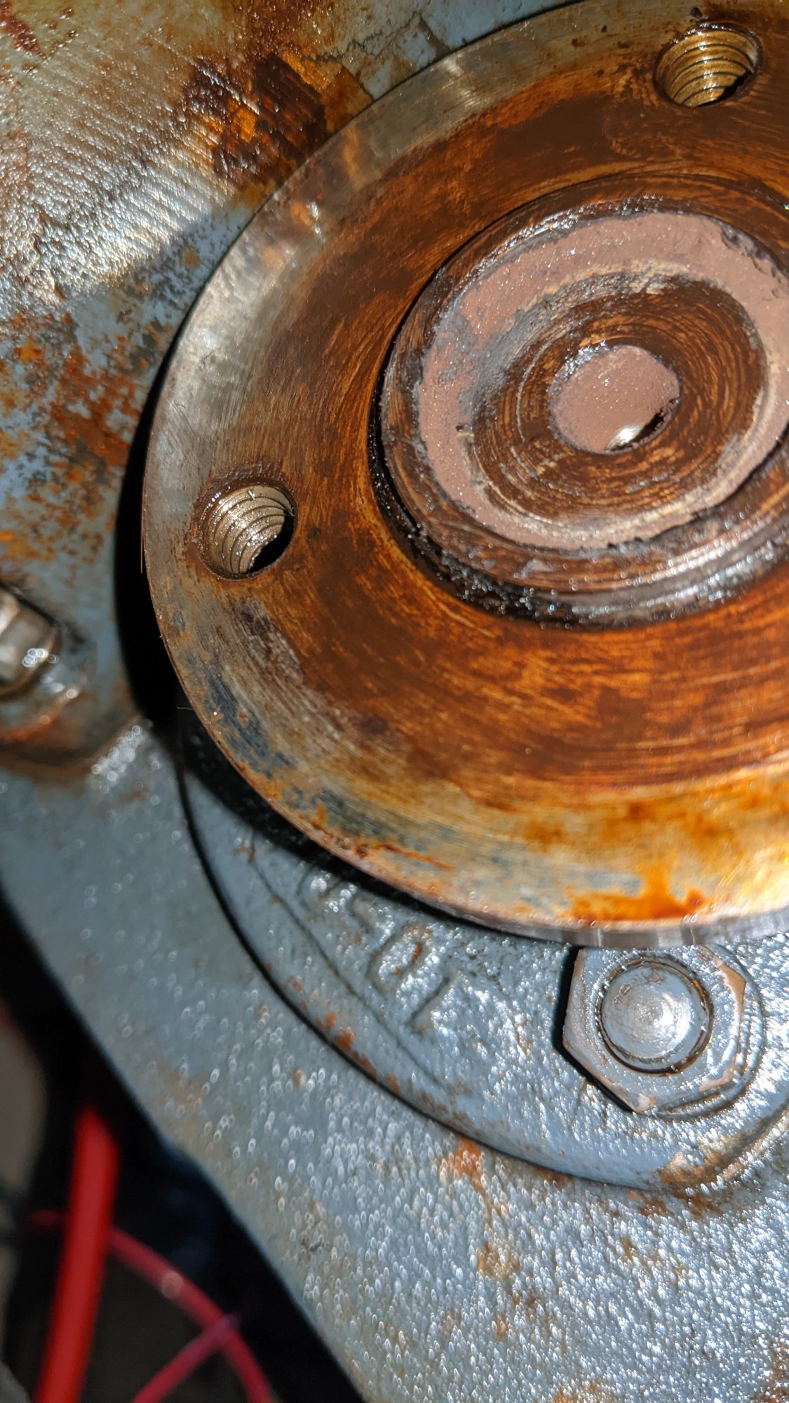

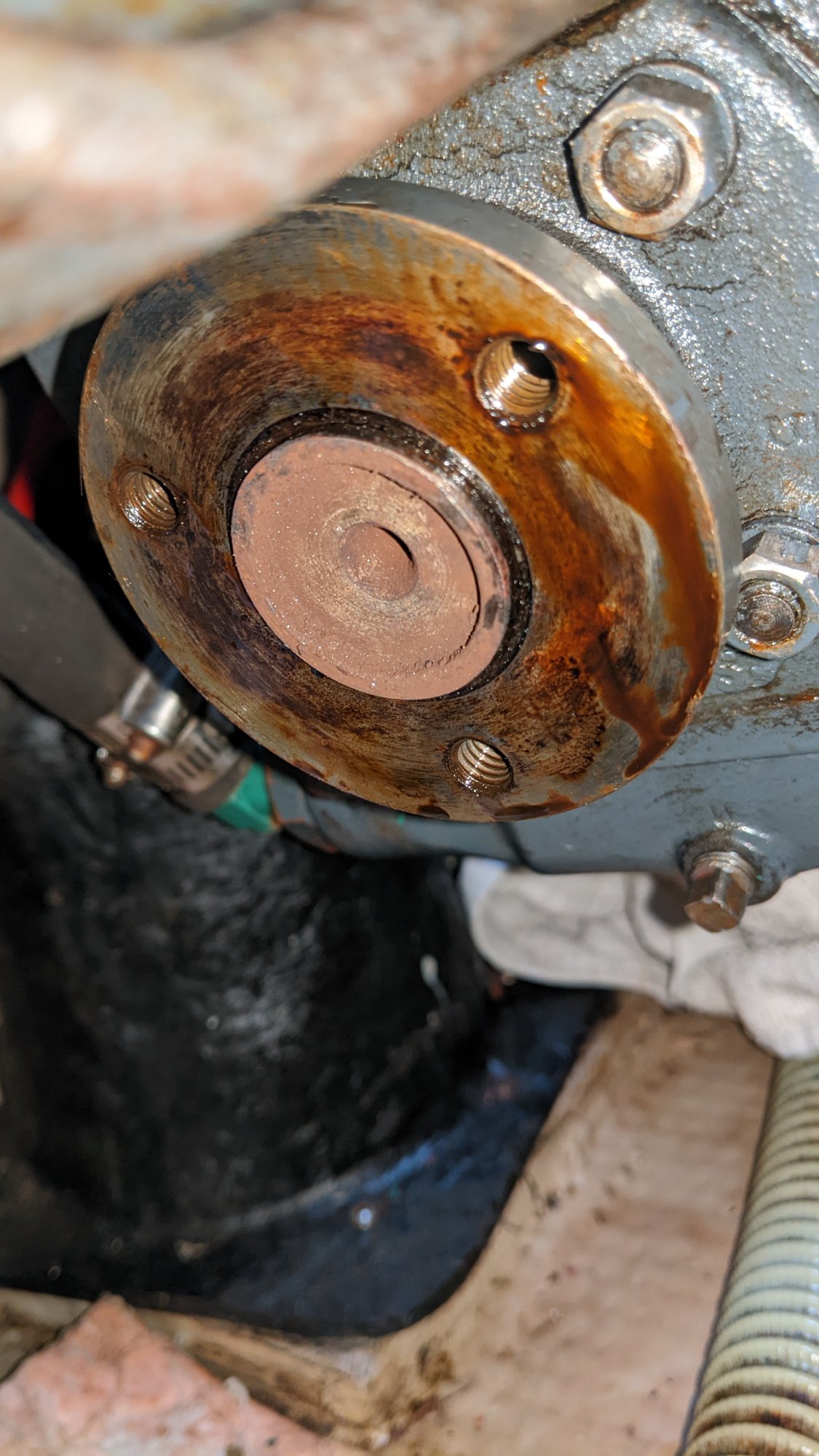

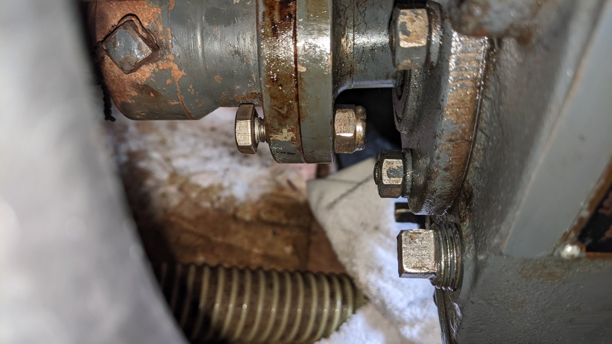

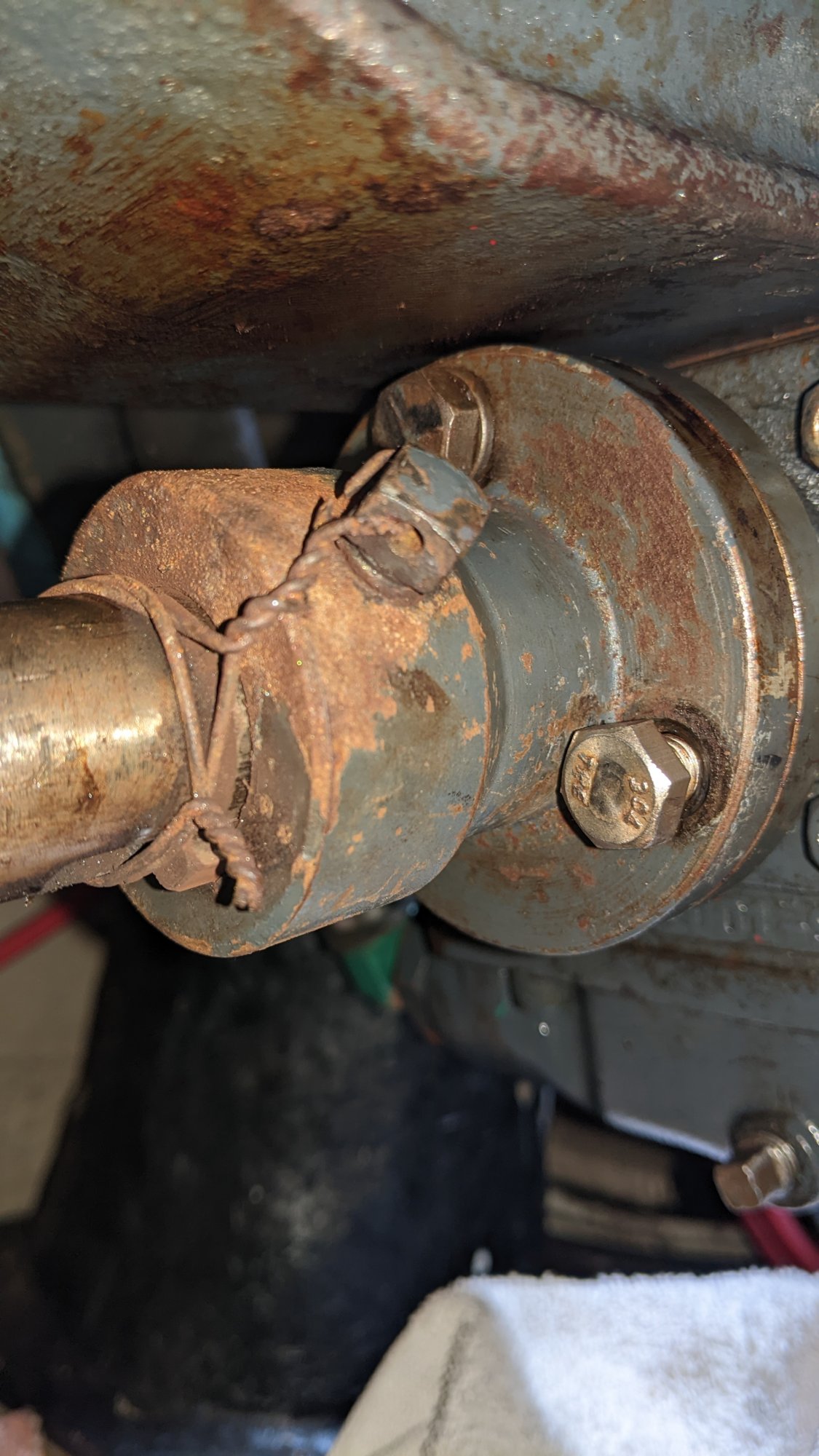

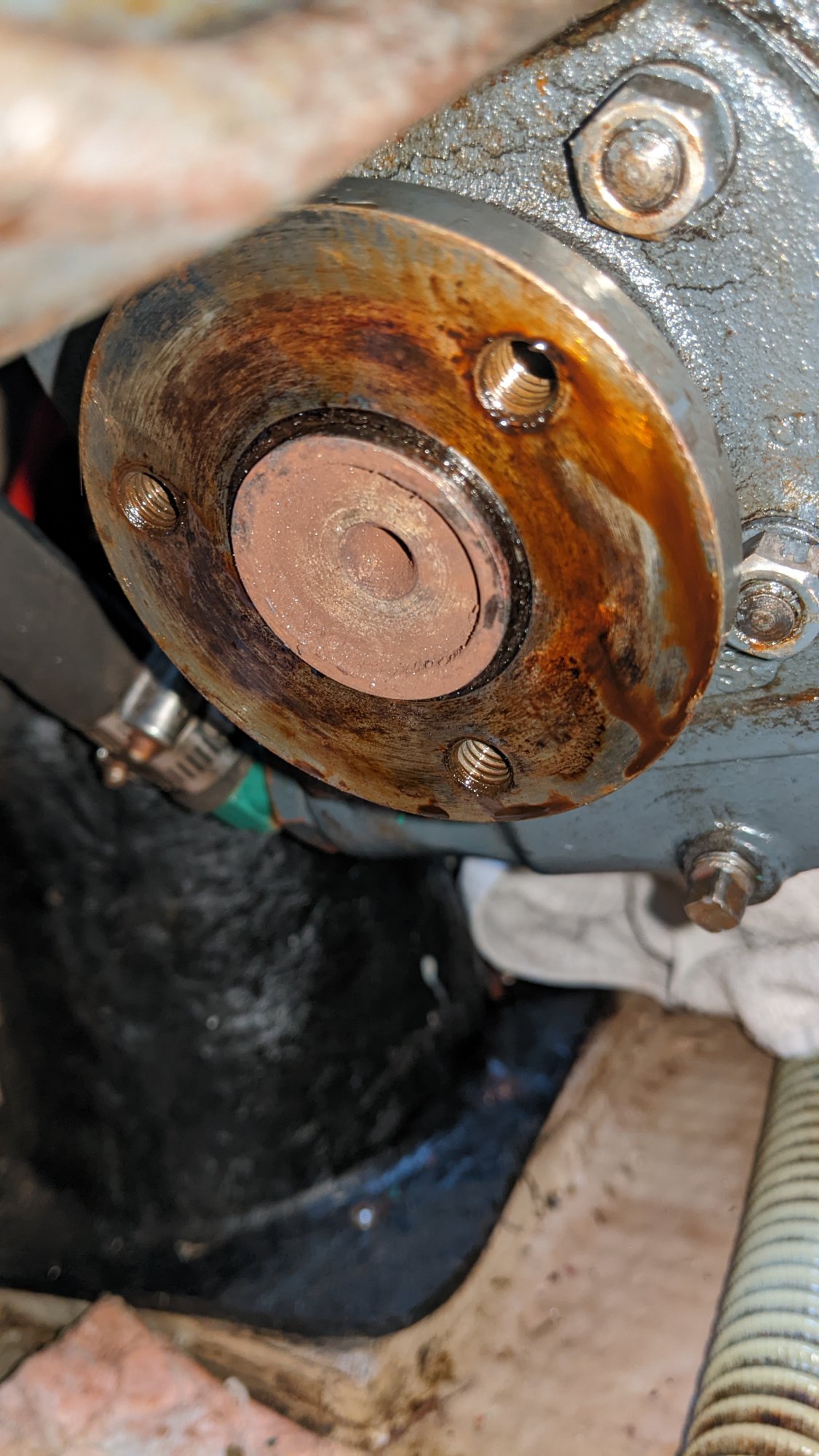

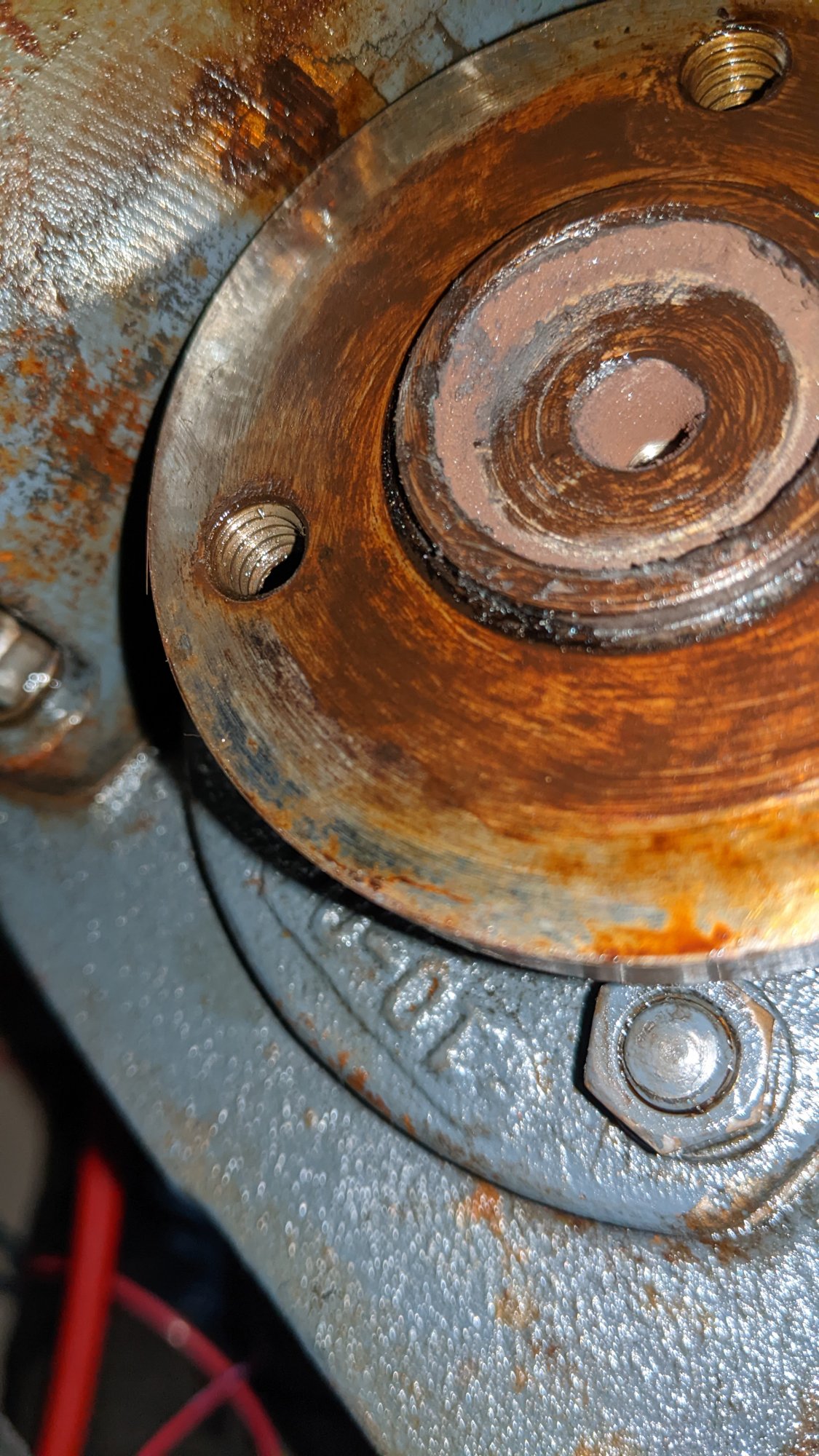

I have an S2 11 with Volvo penta MD 17C, Walter v-drive. I need to replace the propeller shaft bearing. I tried using a homemade strut-pro like device along with a "smoke wrench" and and half can of PB blaster without success, so I am on to removing the prop shaft. The three coupler bolts came off easily, as did the hex headed set screw. I can pull the prop shaft through the shaft log and strut freely, however I cannot get the coupler flange off the prop shaft. I am concerned that it is not a normal press fit tapered shaft, since the coupler flange moves about 1/8th inch back and forth on the prop shaft. Any advice?

Ya probably have a giant burr on the shaft where the set screw point was pushing. That is keeping the shaft from coming out. The fit is ruined, as Maine says, since the shaft is sliding in the coupling.

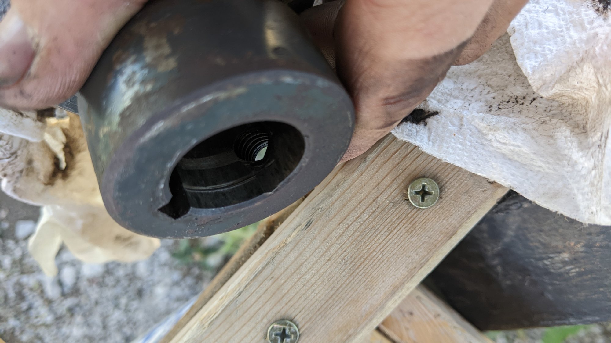

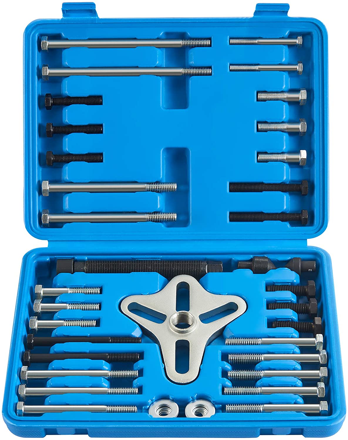

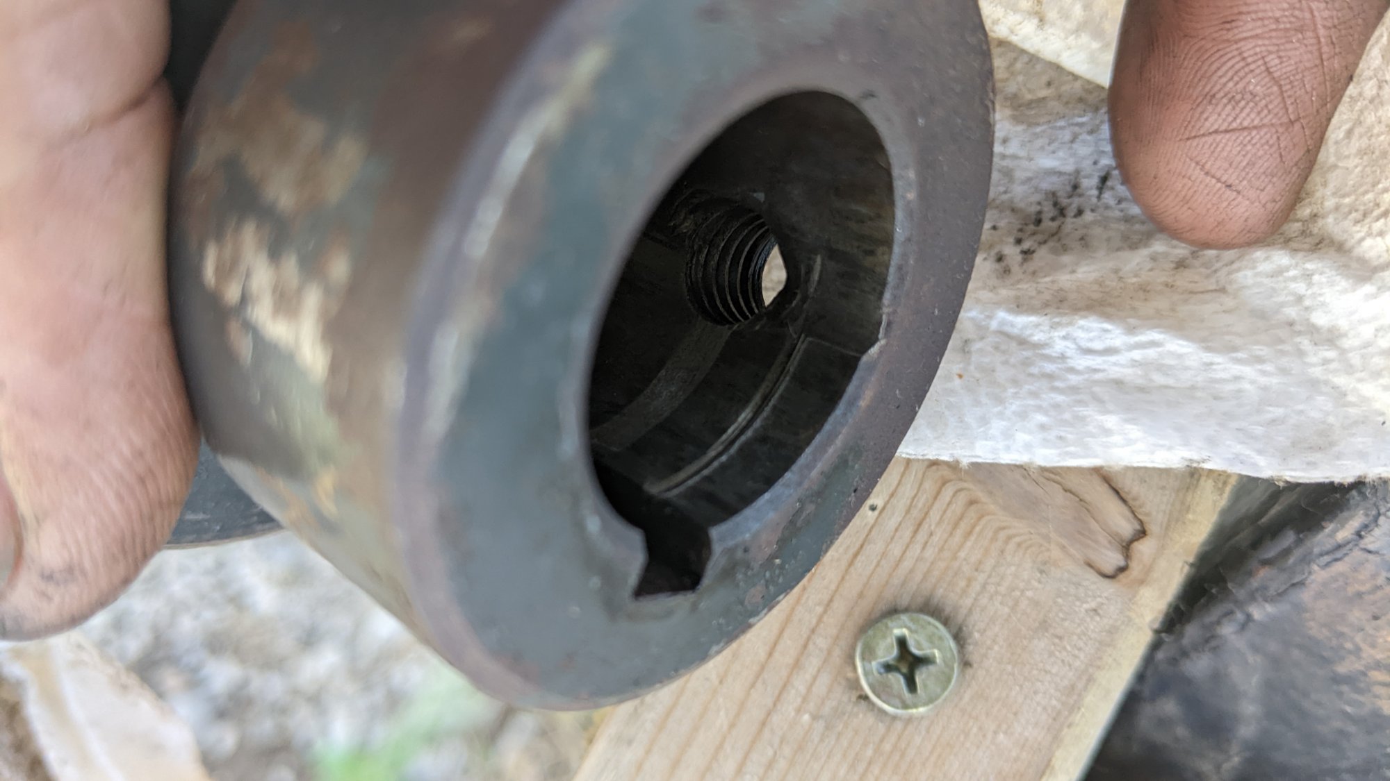

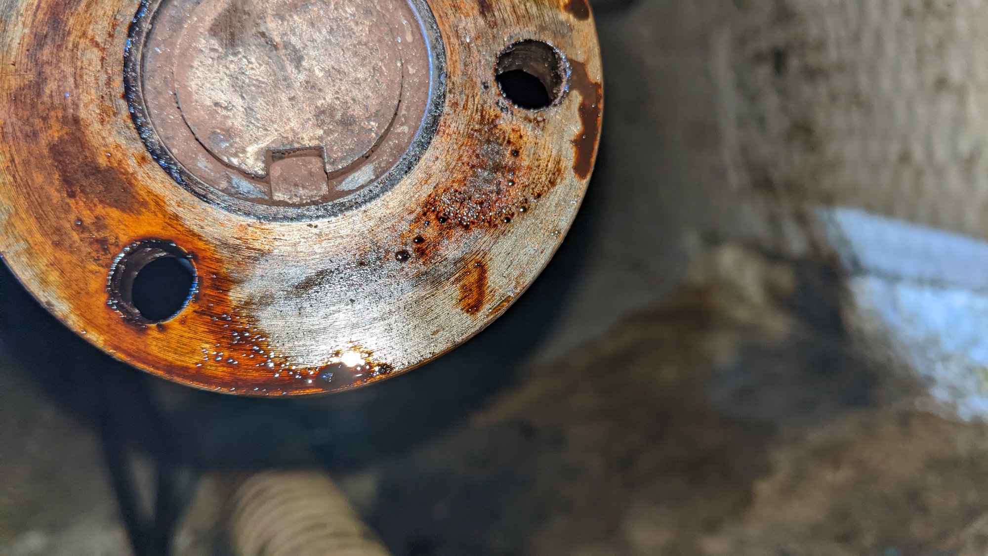

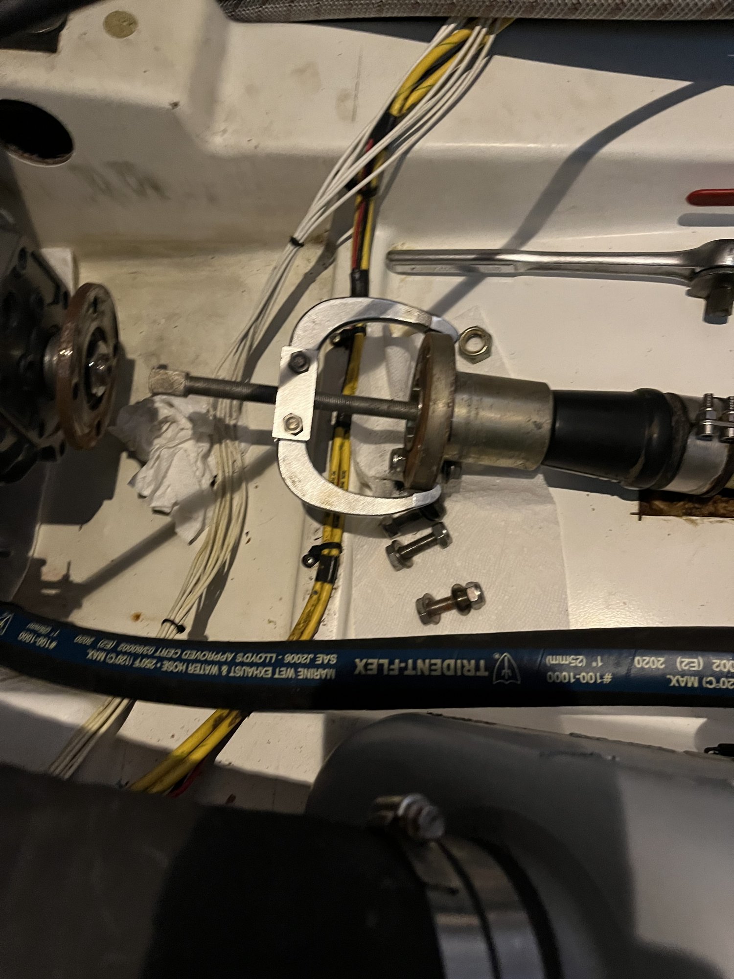

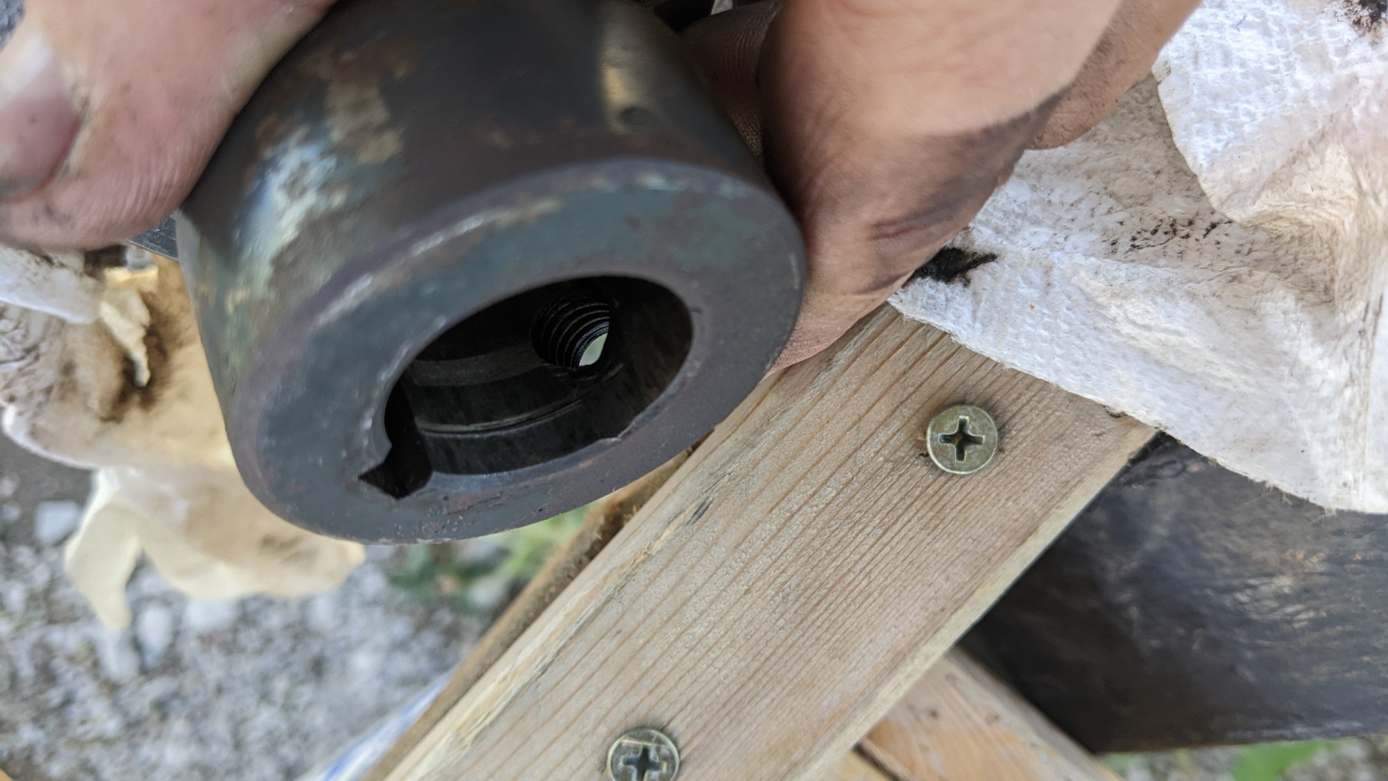

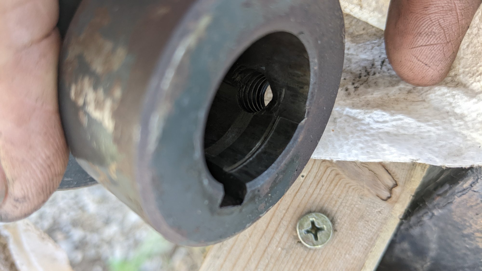

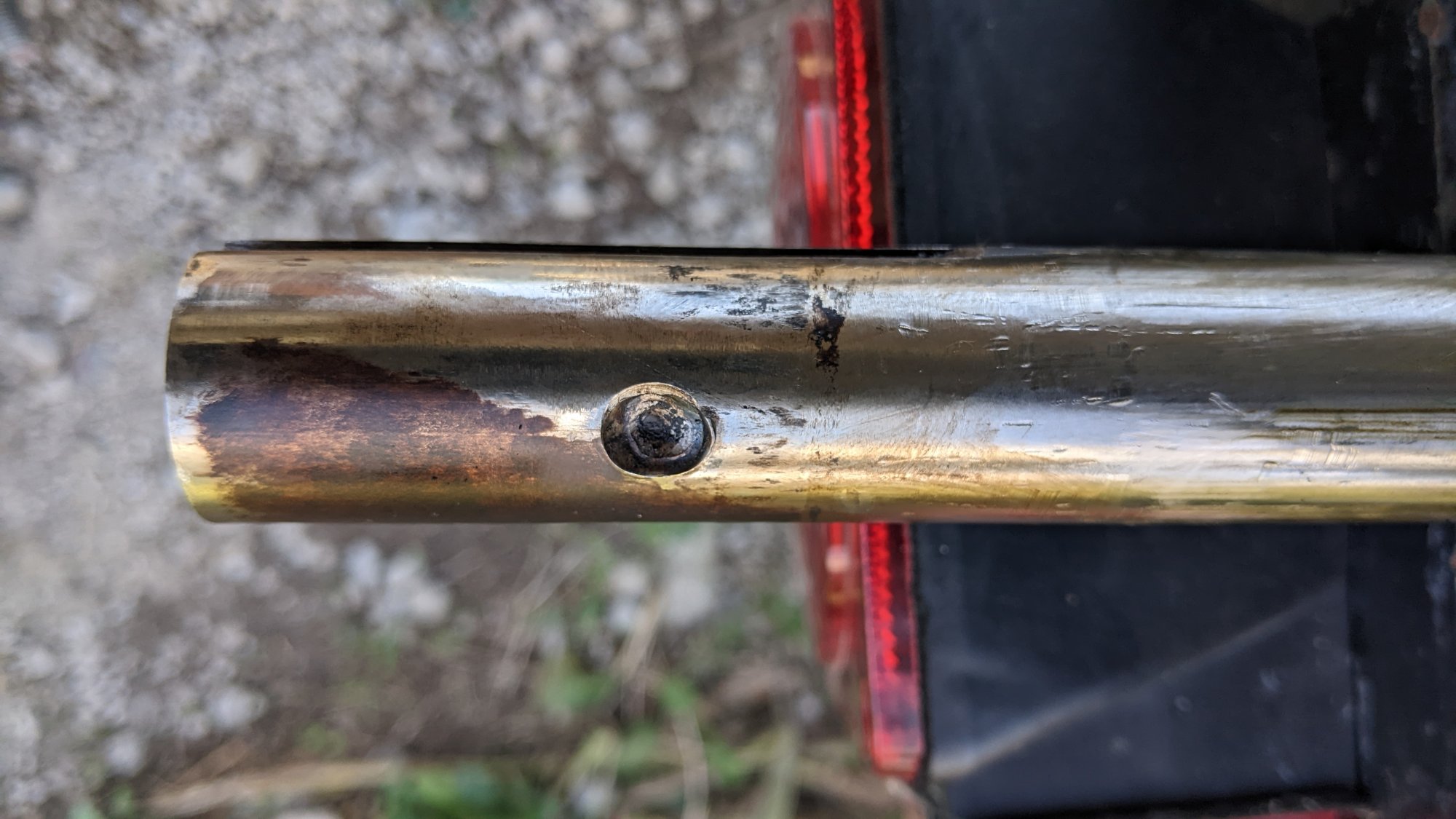

For the record (because I always like to know how these things turn out): I used a steering wheel puller like the one pictured, and the shaft came out with no problem. The shaft did not appear tapered on the transmission end. The inside of the coupler was slightly scored at the end. The end of the set screw was damaged but the dimple in the prop shaft looked OK as did the prop shaft itself. I replaced the set screw, polished the inside of the coupler flange with a scotch-brite type scrub pad and put everything back together. Coupler lined up perfectly with zero clearance in any direction between the two haves using a 0.0015 feeler guage, so I guess the shaft is aligned pretty well too. Launch is Tuesday.

You cannot take the prop shaft off without dropping the rudder and that mean removing the skeg boot which is glued on with a permanent adhesive on the S2 11. But that is a whole 'nother story. We had taken the rudder off to repair a leak and some delamination anyway. Correct me if I am wrong, but I thought a press fit required a tapered shaft. With a straight shaft you rely on the key to keep the coupler and the prop shaft rotating together and the set screw to keep the prop shaft from sliding out of the coupler, and your boat. The old set screw was slightly damaged, less than finger tight, the prop shaft dimple showed some wear, and the coupler is a scored right above the dimple. We replaced the set screw and used blue loc-tite and a wrench.

Got it! Makes sense the difference between a tight press fit with a tapered shaft and and "light" press fit with a straight shaft. We probably do need a new coupler. Our shaft went back in the coupler with only manual effort (no need to tap with a dead blow hammer) and although the coupler does not slide back and forth on the shaft 1/8 and inch like it did before, something was not right. I am pretty sure the prop shaft has not been pulled for at least 20 years, if not 40 years, and who knows how long the coupler has been loose, or if it was a loose fit to begin with. A poorly fitted or loose coupler could explain why the set screw looked damaged (it had been doing all the work of keeping the shaft in the boat!o_O). Keeping an eye on it for now.
