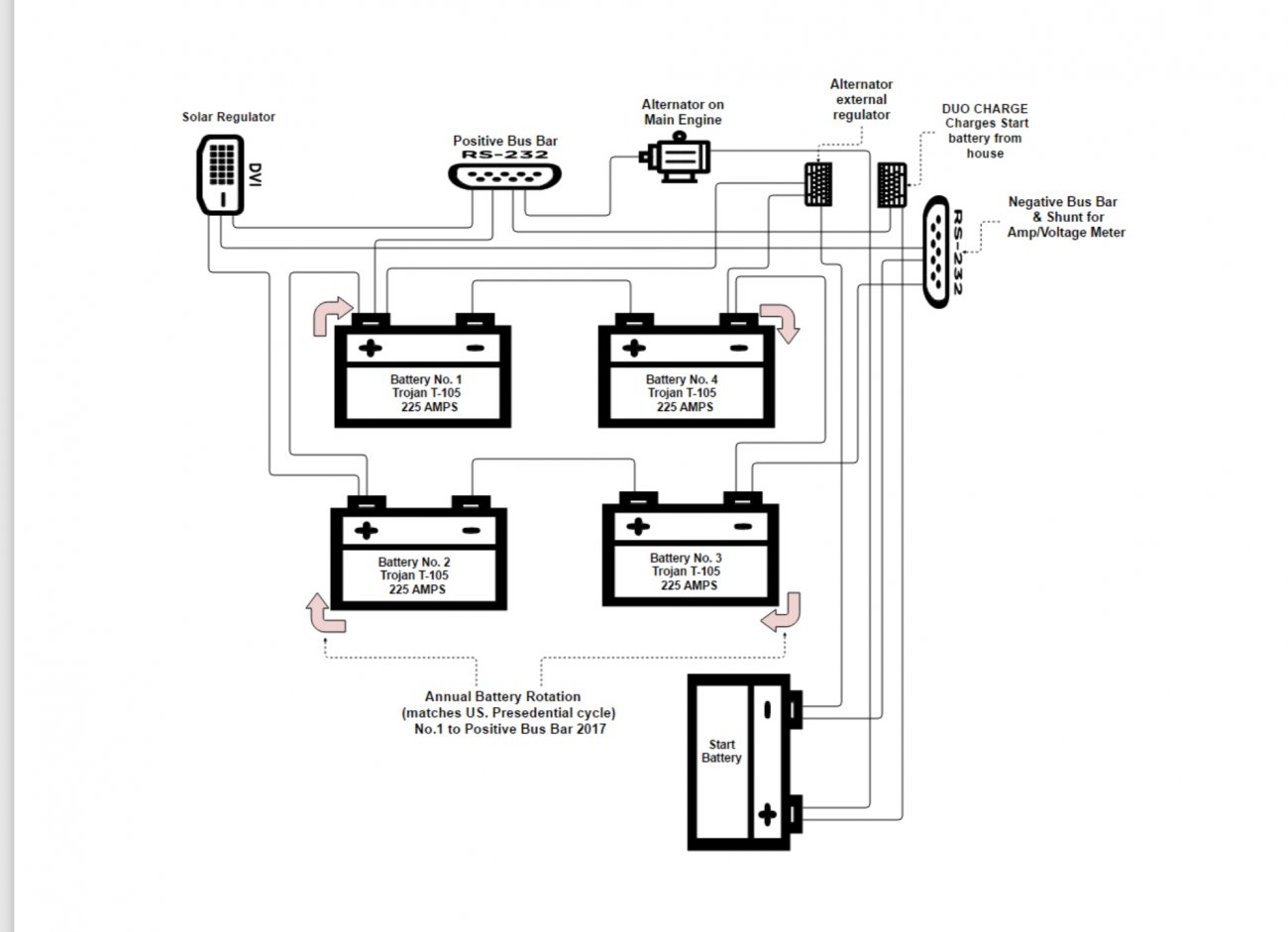

  • Each year batteries are rotated “one” spot as per photo below . Is this a no-no.

Umm...
On your drawing you are showing the bus bars as RS232 serial connectors.
Respectfully, I don’t think D subs are rated for 200 Amps.
