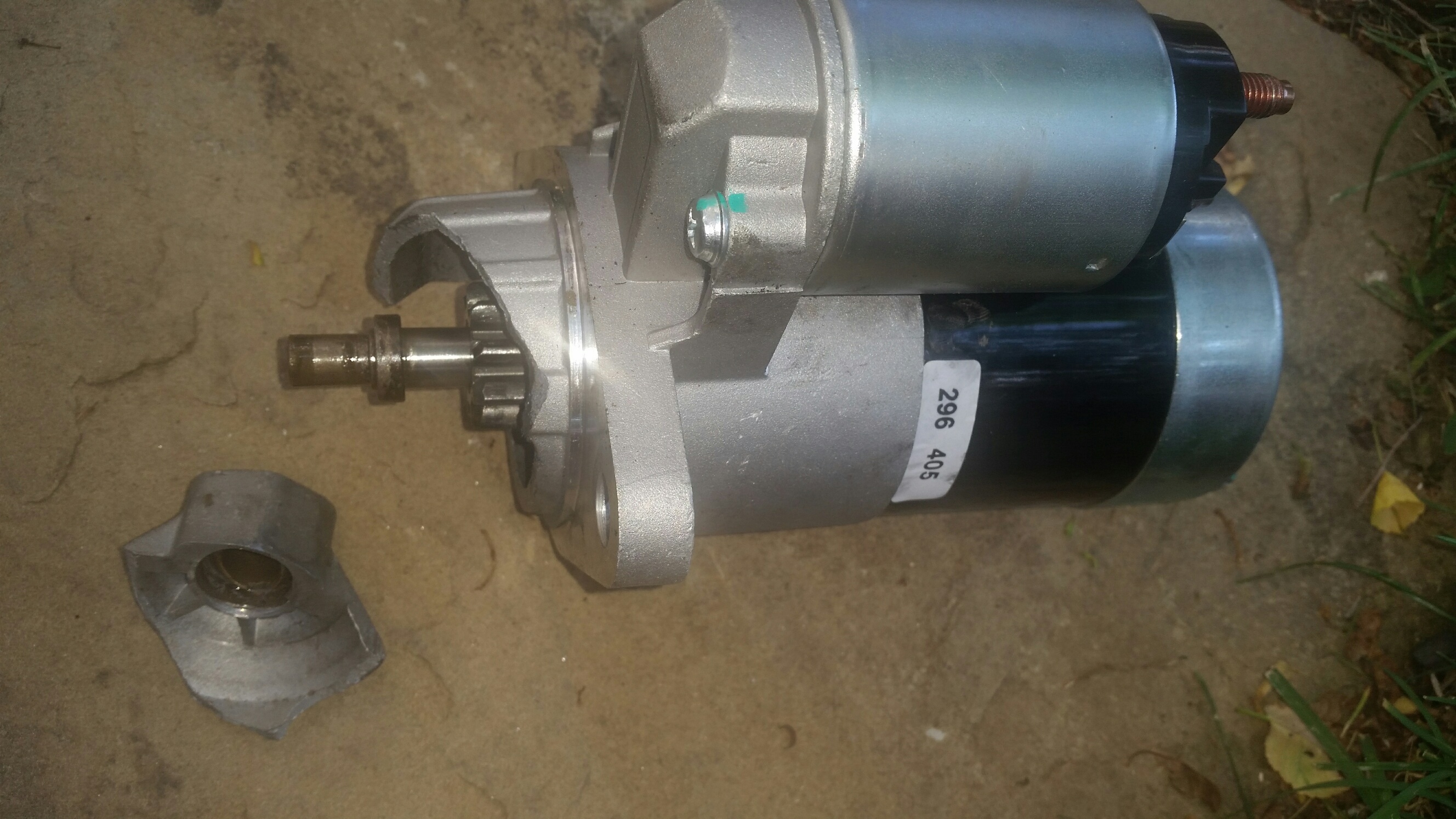

It's not the money so much as I don't know what would cause 2 starters to break the same way. My confidence level is not to the level I feel that it won't happen again. I'm sure if I wasn't doing the work myself the project would have more zeros behind it.

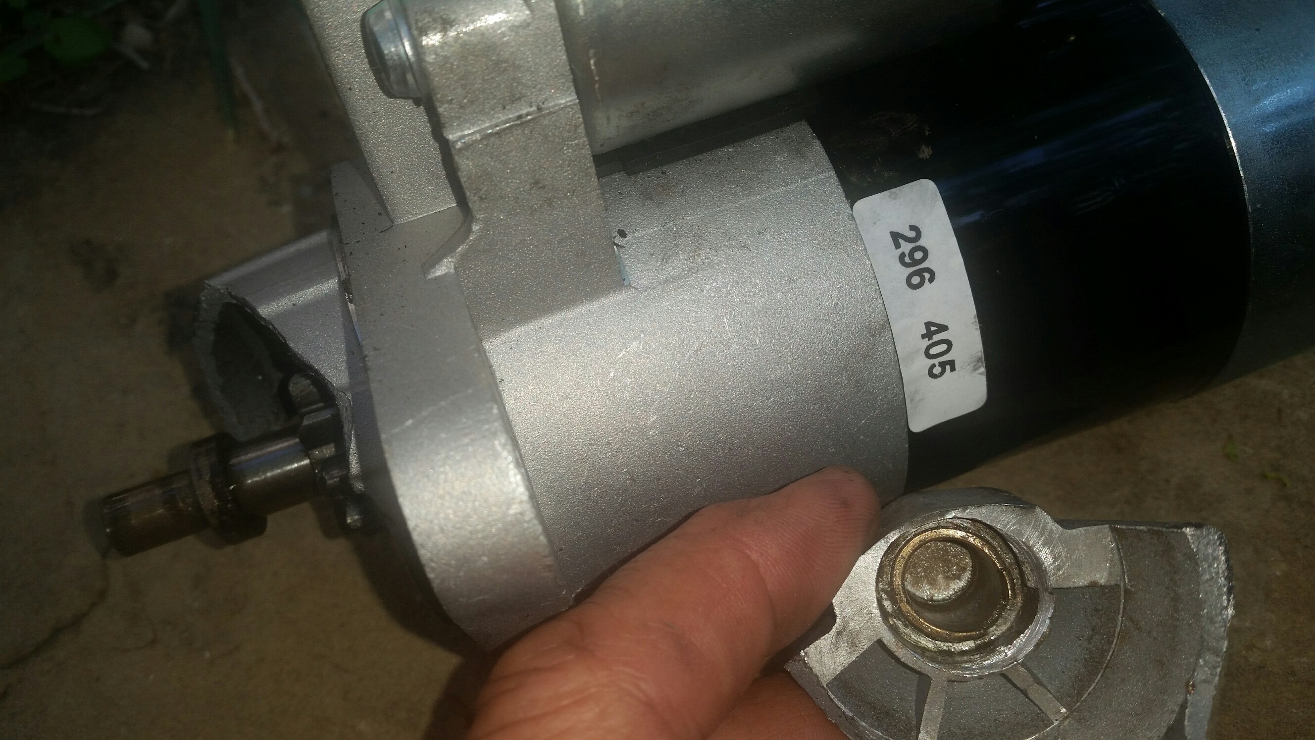

My confidence was shaken because I don't know what caused it. There may be consequential damage but it doesn't verify what happened. The simple explanation is cheap parts, that was my first reaction. But that's just an assumption since I don't even know the source of the first part, or why the original had to be replaced. Why did two, possibly three, separately sourced parts break the same way? The bearing is wallowed out, what caused that? The ring is being replaced not just because there is some slight damage but also because it may have been the cause, not the result. The flywheel will get inspected too. And someone proposed timing. That will also get checked.
So no sense in theorizing any longer. Time to tear it down and inspect. Then buy new parts.

A friend schooled in failure investigation could look at the crack faces and point ya to a bad casting or a stress overload.. If ya know a mech engineer or metallurgist in the oil or aircraft industry, ya might be able to find someone who can analyze it for ya .. might cost ya some good scotch..??

My slip neighbor is a chemical engineer. Right away he looked for carbon by eyeballing it and didn't see any. We IT geeks don't meet many people with lab access :biggrin:

Justin, most ring gears are not "pressed" onto the flywheel. They use an induction heater to heat the ring gear which thermally expands and is then "shrunk" fit onto the flywheel. I worked in a factory that did this on outboard motor flywheels in my youth so am familiar with the process. Consider machining off the ring gear or cutting a slot to allow you to pry it off by expanding the diameter with a pry bar. That induction heater would get the ring gear red hot in about 5 seconds so you will need some means of heating the ring gear hotter than a typical household oven will get. Measure both parts and using .000006 per degree F per inch of diameter see what temperature above room temperature will get you a slip fit with some room to spare, probably .003 to .005 clearance will give you some wiggle room to get it on before it cools too much. Having it seize up halfway on will not be good so err on the high side of clearance. Too hot might effect the metallurgy, not knowing what the ring is made from or if the teeth are case hardened be careful.

Another thought. I also worked in a gear manufacturing facility and am familiar with precision gears. If the ring gear is not concentric to the center of rotation of your motor it can cause the gears to "clash" and will look like the damage you are describing. As the gear rotates on one side the fit between the mating gears will be too loose and on the other side there won't be enough clearance for the teeth to fit together. This will put a big side load on your starter. Not having special measuring equipment you should see if the diameter on the flywheel where the ring gear fits runs concentric to the engine shaft axis. To check it with the ring gear still on put wires in the gear teeth and check the runout over the wires. The starter gear could also be machined wrong so it has the runout and is causing the "clash." Check that first as given the price that starter had to be made for about 25 bucks to sell it retail for 100 bucks, So it probably has a 5 dollar gear in it, I doubt it is very precise.
