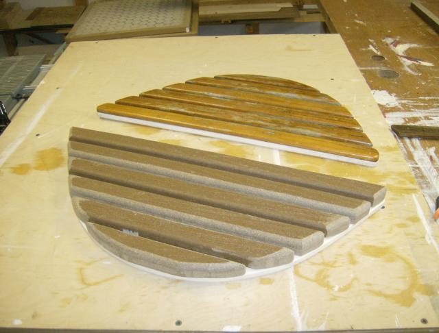

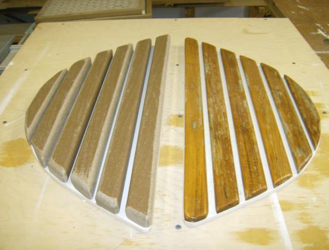

After reading several articals about using Trex, I decided to give it a try on my stern rail seats. Trex is the brand name of deck making materials that is made from wood pulp and recycled plastic, available at any DIY home store. It is dimensionally stable, is not supposed to rot, and is easily worked with common wood working tools. While I like the look of varnished wood, I don't like how it gets ugly during the summer. And I don't want to bother with another set of covers every time I use the boat.

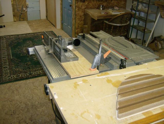

The photos are good before and after shots, as well as my table saw and router that I used to fashion the pieces. It really is easy to work with. Trex does need to be a little thicker that the pieces it is replacing for structural integrity.

Very nice. I wonder how it compares with the PlasTeak that I get right nearby in Copley, Ohio? Will you plane it or is this the additional thickness not a problem?

Since it is just a seat, I left it at the factory 5/4 size. For other applications, I would consider trimming it closer to fit. I always thought a wood grating on the cockpit floor would be neat. Trex? Hmmmm......
